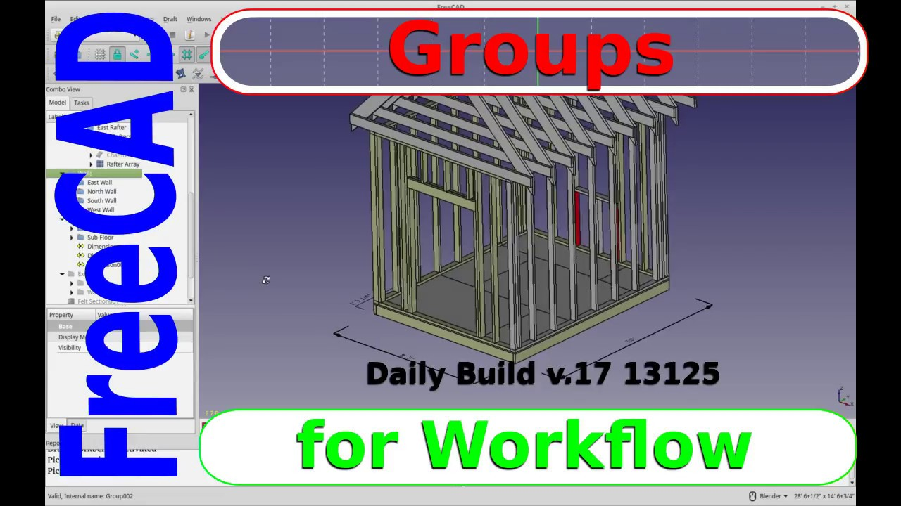

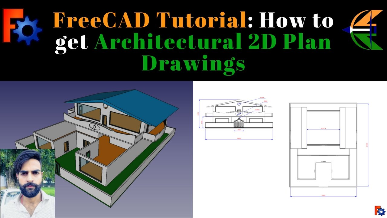

FreeCAD is where the action is at. Comes with all the translators too!
The price is F-R-E-E-E-E-E-E-E-E-E-E-E.
Get version 19.3 now! Windoze - MAC - LINUX
Work in 2D like AutoCAD LT or work in 3D like SolidWorks all for FREE !
Make 3D in 3 clicks to 2D drawings and even take the BOM to buy the lumber for the shed!
https://www.freecadweb.org
