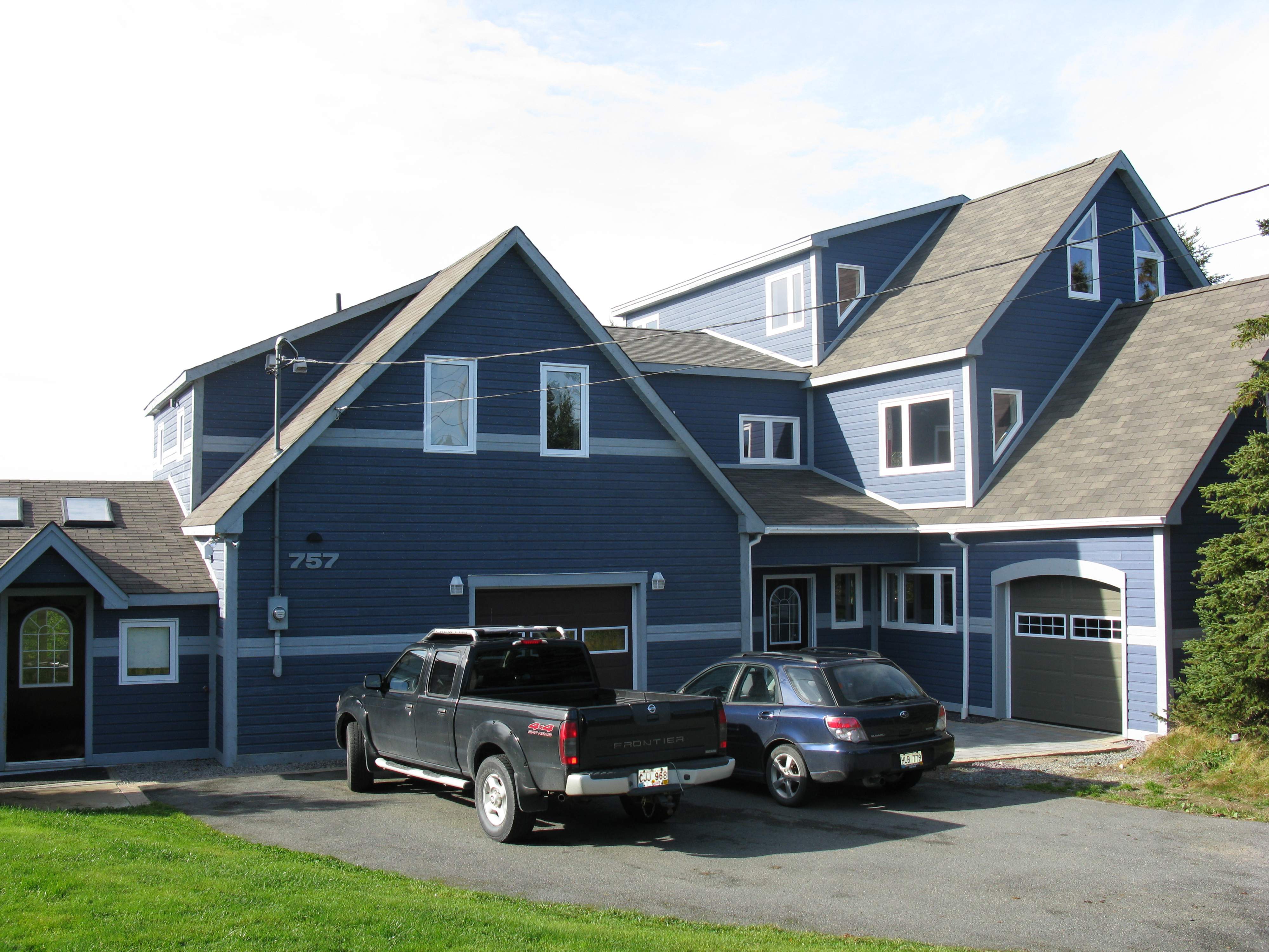

I have just completed the third section of my house, which brings my total to about 12,000 linear feet of siding. I used a wooden Goodfellow product which I like; Hardie has a good name.
A few things to consider:
- Ensure there is vertical strapping behind any siding to allow any water that enters to drain. A mesh on the bottom will allow drainage and prevent pests from getting up inside the space.
- All siding leaks, so your water proof layer is behind the strapping, usually Tyvek. With that in mind, you usually would not need any caulking on your siding.
- I pre-stained with solid colour stain and then used stainless steel screws. That meant drilling in almost 20,000 screws over the various stages of the house construction, but modifications and troubleshooting is really easy.
Not all of this may apply in your case but after 11 years the most weather exposed wall now needs new stain, so the durability is good. Also, we get high winds with our weather (100 mph on occasion) so driving rain and snow is a factor here.
Good luck,
Jon
