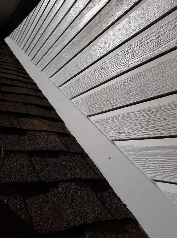

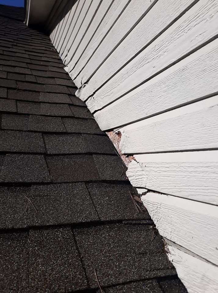

Did you post a picture of the siding and it's not showing up on my screen?
There are two sizes of Hardie lap siding to chose from. 8.25" is the most common, but there is also a 6.25" The bigger is installed with a 7 inch exposed, the smaller has 5 inches showing.
Did you provide them with the siding, or did they go buy it at the store and did they buy the wrong size?
The biggest mistake made on most houses with Hardie and LP Smart siding is installing it too close to the shingles. Just guessing, I think they require a 2 inch gap above the shingles. If there isn't a gap, water will destroy both products in a short amount of time.
