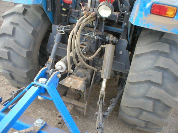

Mine is home made. Bought the hydraulic and cut off the ends. cut the ends off of the factory side link. welded the top end onto the cylinder. Bored a hole through the clevis end, turned the rod down to size at the end so that clevis end was a press fit, and welded.
Probably don't really need to do all that stuff at the clevis end, could have just welded it. ;)
Oh, and I would not want a check valve on mine, I sometimes put it in float mode and drag the ground smooth letting the blade move with the terrain of the ground.:cool:

Thanks Brian, I never thought about leaving it in float mode.
