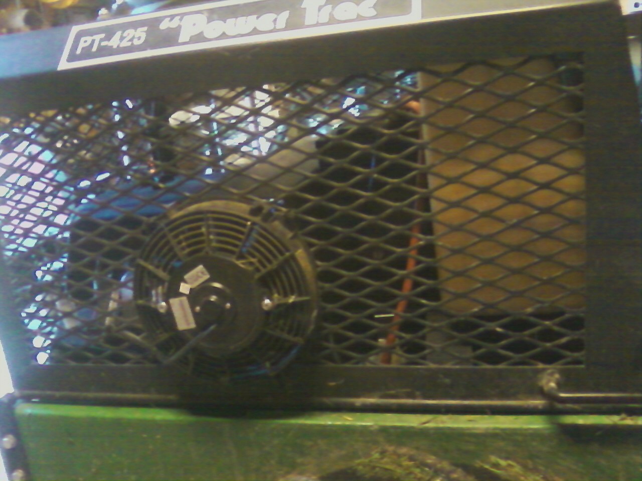

I'm in the process of replacing the 10" fan added to the size of my PT428's engine cover years ago. It's been acting up intermittently, so I've purchased a 12" as a replacement. The fuel pump I installed after the OEM unit died is also misbehaving... I have the new pump, and it will be located a bit differently in order to avoid the high temps inside the tub. Finally, I have another 7" fan that will be mounted to the front of the engine cover right behind the seat. I need to weld up the mount for it, but it should push air into the front of the tub and help keep the temp down a bit. I'll post pics when I'm done.

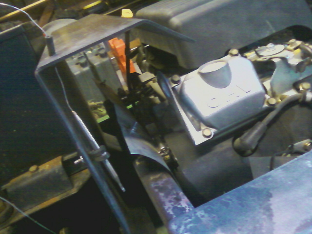

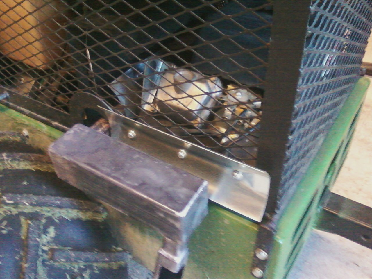

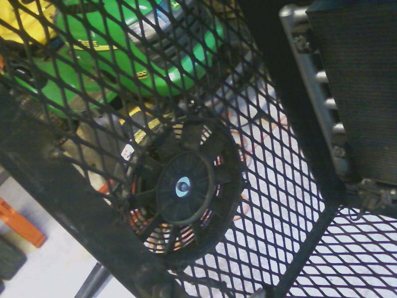

Sorry to barge in after being MIA from the forum--except for occasional lurking. You guys have the best ideas! I added the little fan that Farmall140 references. Works fine blowing air under the shield and out the other side of the cage--thermostat controlled. Also added two heat shields on the exhaust: one on the header the other near the muffler. Using IR thermo the valve covers are around 200-210 after mowing on a 90+ day. The hottest area on the EH72 was the block between the cylinders with 250-270 depending on the angle I could shoot from. Running Mobil 1 so hopefully not cooking it. Valve job this summer showed no sludge or buildup under the covers. Change filter with Fram TG every year or 50 hours + additional oil change mid summer.

EDIT: Oops. Had my temps wrong above.
Before the fan/shield: -valve cover next to exhaust-- 200-210. After: 160 same as other side.
-top of engine block--245. After: 245
-bearing cover behind exhaust cross over-- 325. After: 250-270.
-oil pan -- 230. AFter: 230.
These figures are rough averages (+/- 5 degrees) that I noted.
Obvious benefit using the fan/shield for me, especially to the bearing cover just behind the exhaust cross over (am I calling that thing the right name?). I think the fan alone would help keep the little "Wobin" cool--it's surprising how much hot air is blown out of the exhaust side of the cage using the side fan.
