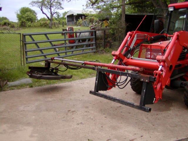

<font color=blue>How would it be if you had a wheel out board of the deck that maintained your cutting height?</font color=blue>
I have a Swisher trailmower I purchased before I got my tractor to speed up mowing my lawn. After seeing this post I am going to use it for cutting banks. It has a wheel attached to either side.
<font color=blue>Another option instead of a hydraulic system on your upper boom arm would be to have a cable pulley system. </font color=blue>
I was thinking along simular lines, but using a chain on the end like some do with thier toplink on thier brush hogs. Have some means to tighten it up for transport, but let slack in it to let it "float" while I'm mowing. The winch sounds like just the trick for that.

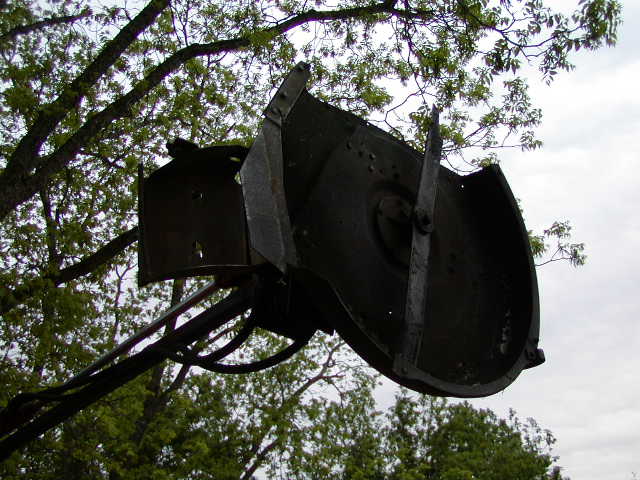

Adding wheels is one thing that I do intend to do. That way I can let the arm down and float while the wheels maintain sufficient height off the ground. Had also considered skids or runners, but there just something for grass to get caught on.
Right now I am researching what I need to do to add remotes to the tractor. I may have what I need or at least most of it. I also have a nice long cylinder from a front end loader about 60 inches long with 2" bore, that I could mount from the three point to the cutting decks toplink mount.

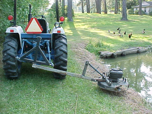

I am in the process of designing a similar gadget to mount on the front of a Power Trac. I was planning a string trimmer, but these posts suggest that maybe I sould look closely at rigid blades.
I would appreciate knowing what hydraulic motor you mounted. I have a .7 ci displacement Gresen MGG 5000 RPM motor selected for the string. (It has 9/16 keyed shaft, which didn't seem a problem until I started looking for pulleys. They're 1/2 or 5/8) It may do the job, or I might need a little tougher one. I've 15 gpm at 3000psi max available.

I do not remember all the specs but I think I used the WW Grainger catalog information to figure which pump I needed to give me the RPM & horsepower I wanted from the hydraulic motor. My tractor pump is 9 gpm. I think I was shooting for a blade tip speed to match other 3 point mowers. Maybe around 15,000 fpm at around 1500 engine rpm or about 5 gpm. If my information is correct, the gpm remains constant for the engine rpm. Pressure and HP produced varies by load applied.
You could change blade speed with the pulleys, but I bought to fit what I already had.
My pump was a Barns pump, WW Grainger # 4F657-3. Cost about 139.00
I might also mention, someone told me, most pump bearings would not hold up under this type use without an "overhung load adapter", but I chose to not purchase this, at least for the first try. So far have had good luck.
