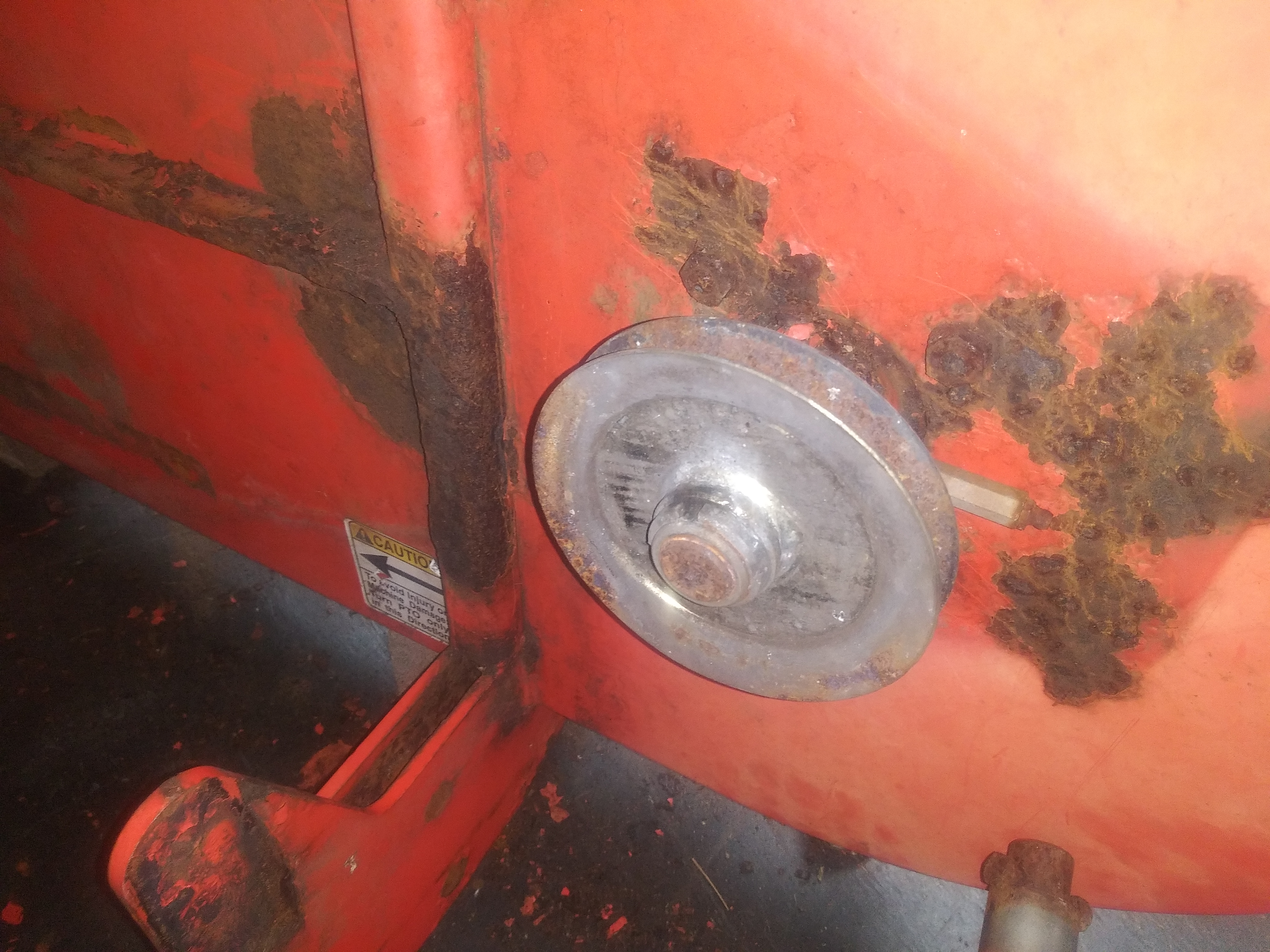

I also need this DRIVE PULLEY - Parts For Sitrex, First Choice, Caroni, & Howse Mowers - Blades, Belts, And More drive pulley from this https://www.tractorpartscentral.com...en=CTGY&Store_Code=TPC3&Category_Code=FCFM60& or similar site.
I think the price is ridiculous. Can someone tell me where I can find a pulley cheaper. Sadly I have never had to identify a pulley to go online and order on so I do not know the per-requisites to ensure I get this correct.
As you can see mine is junk.
I guess Im gonna need a puller to get this one off? Im hoping its a common puller that I prob have.

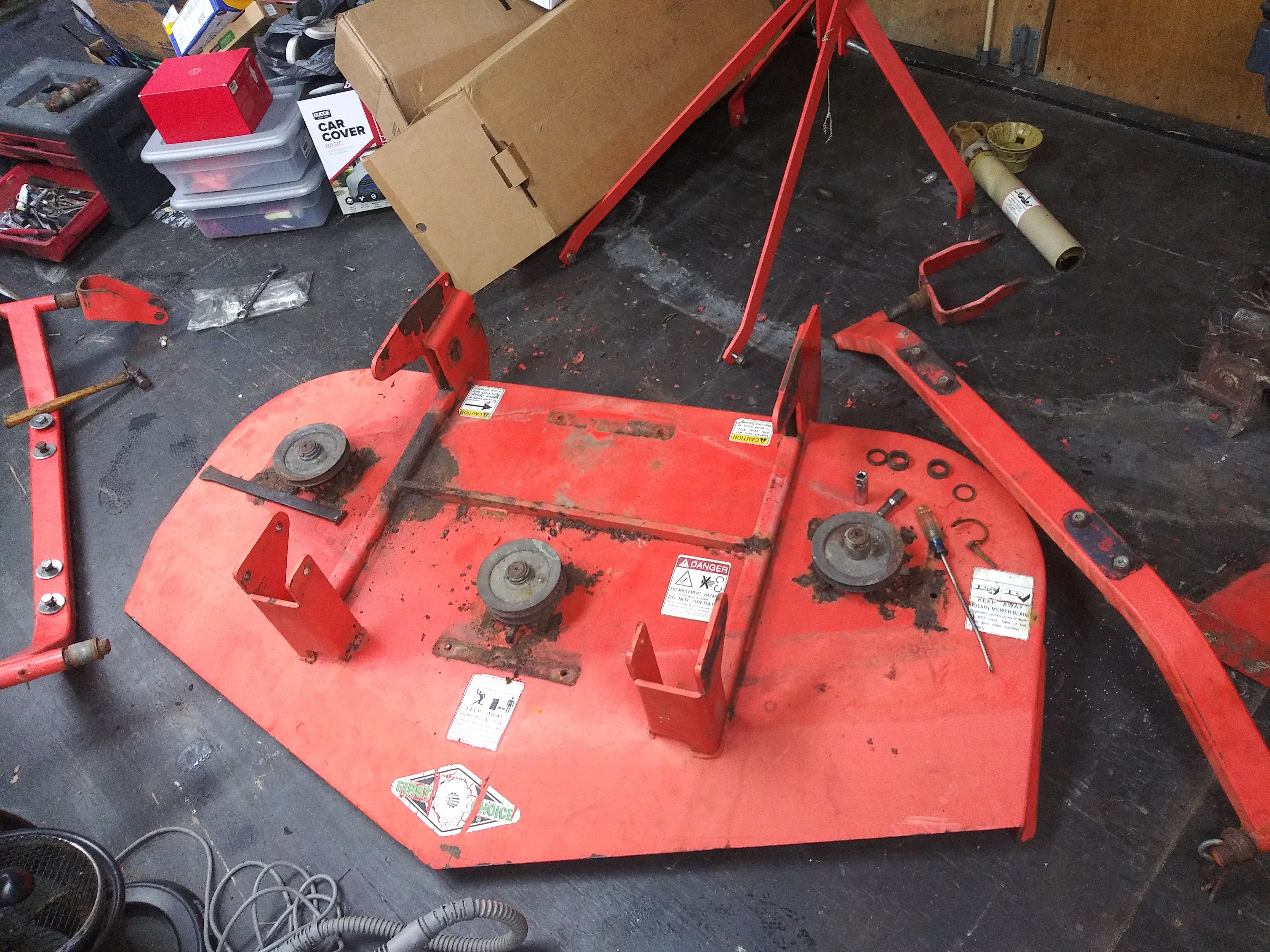

Im gonna order the manual/parts listing book as well from same place https://www.tractorpartscentral.com/store/product/FCFM60/FM-MANUAL.htm and it looks like Im not gonna have a choice but to order their spanner wrench https://www.tractorpartscentral.com/store/product/FCFM60/SW-15.htm cause I do not seem to have any other ideas of getting the spindles disassembled for cleaning ect.
Can someone tell me how to stop the blade or pulley from turning whilst Im trying to get the nut off the top with the special wrench Im fixin to order?

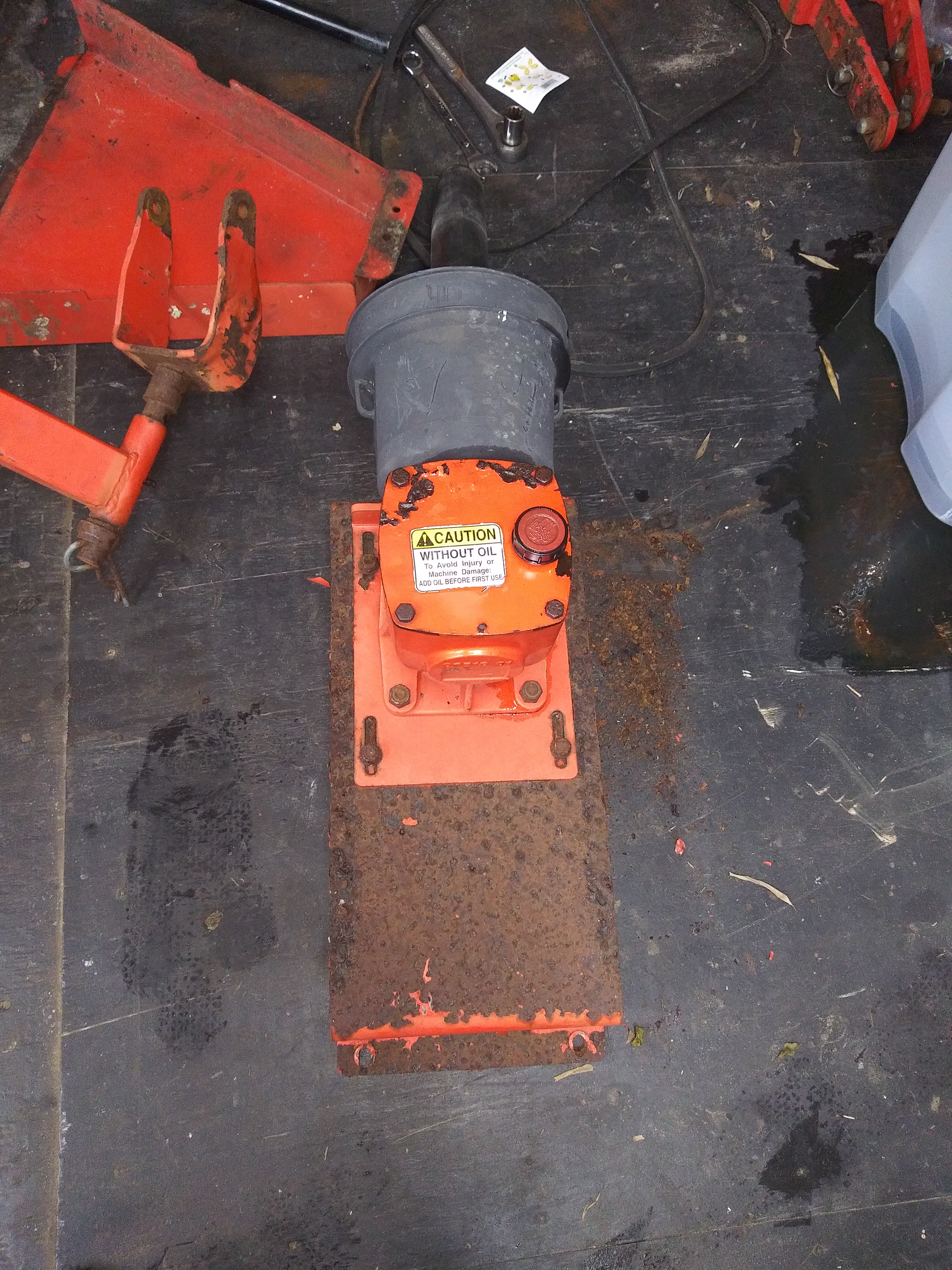

I know maybe the thing looks like junk but the deck is solid, minor surface rust underneath, no rust through, super heavy steel throughout. The gearbox support plate looks the worst and the steel on that is 3/8 thick and rust is technically minor surface rust.
Thanks
For blades, I put a C clamp on the housing so that the blade comes up against it and can not turn.
I tried vice grips and no luck, Ill try a c clamp. Thanks

I have a spare drive pulley for Caroni, and according to some info I saw it may be the same one. I can get measurements and pics if you want. I refurbed a 90" and more recently a 5 footer. The two shared a number of parts, so after using a third deck for a "donor" there are parts left over.
If you have it that far apart, I'd recommend a good cleaning of the shaft the drive pulley is connected to and replacement of the lower oil seal. This is assuming yours is similar to mine.

To remove the spanner nuts on the top ends of the quills (spindles) I give them a shot of penetrant and use a drift punch and a light hammer to get the nuts spinning. A pair of Channellock pliers (preferably curved jaw) is useful after they break loose and for reinstallation. I haven't needed anything much to hold the blade. Often used Channellock "Big Azz" to grab the pulley itself. Gotta be careful not to scratch the belt-ridden surface, or clean it up when you do.

Approx diam of pulley is 9 inches. Approx width is 1 5/8. I do not have it off yet to see the shaft size. Thanks, I do not have the time right now to do an outstanding job of restoring this mower as you did. Id only like to get it operational whilst doing a correct long lasting job.

Im trying to get the blades loose, at this point the nut is turning and so is the pulley up top but of course the blade has been stopped from turning. I do not know the direction of loosening so I have tried it both ways with the same results. Does not turn easily in either direction.
Any suggestions?
Obviously the bade is not indexed anyway on the shaft and the shaft is just spinning which makes no sense. Id guess the blades have never been removed. Badly abused mower.
Not only the shaft on the forks are bent but the forks themselves. Junk
They really should have made a few flat spots for a wrench
Edit: I thought to myself as I typed that I needed to look closer and yes there are flat spots and I have one loosened now thankfully. Im gonna do the others

I would soak those blade bolts o'night and use an impact wrench. No fun if you snap off one of the heads.
Skip WD-40 and go for PBlaster, Kroil, 50/50 ATF & acetone, Breakaway, Gibbs, Free All, Mouse Milk, even Windex.
Apply sparingly several times on both sides of the blades.
Keep bearings in mind if you add a hammer-smack to each bolt-head before you muscle on 'em.

Thanks but they came off kinda sorta easy once I was able to find the flat spots behind the blade to place my wrench.
