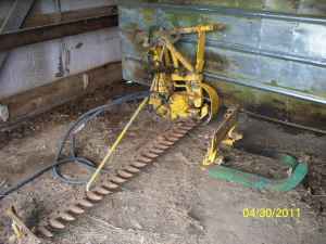

Thank you for replying. My JD 2320 is about the same size as your B2400, 24 HP and 18 HP at the PTO. I attached some pictures; is it a belt drive? Sorry for the pictures being so small.

/ Sickle Bar Mowers
OK, thanks for the info. I was wondering where that bar was suppose to go. What type and model sickle bar would be good for my tractor?

I've been eye-balling this one. Side mount and runs off 1000rpm PTO.
