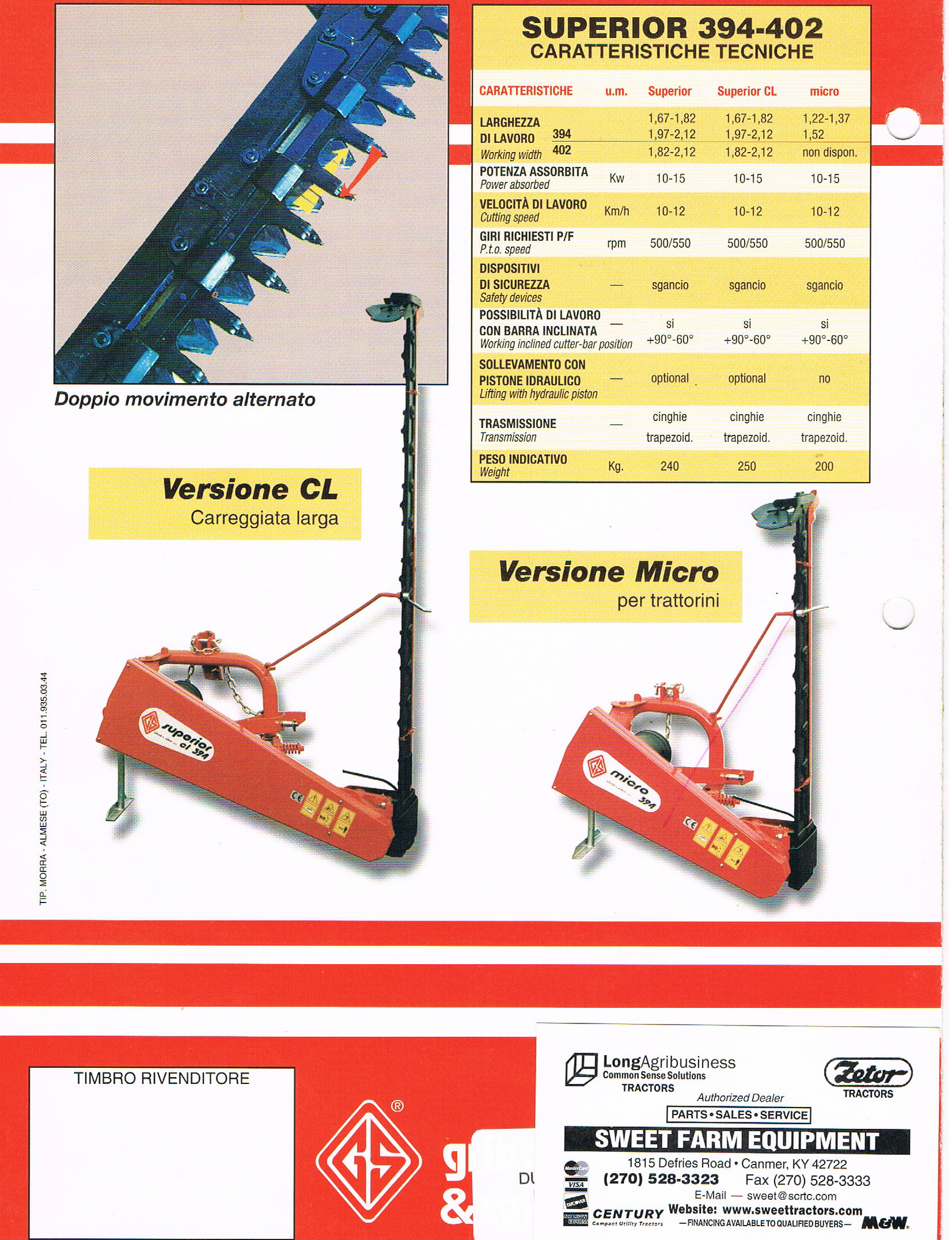

Here are some specs and pictures of the 394 Micro 5 ft Superior (no cylinder available) at $2395 + shipping and the 394-7 ft Superior with cylinder for $3695 + shipping. Ken Sweet
