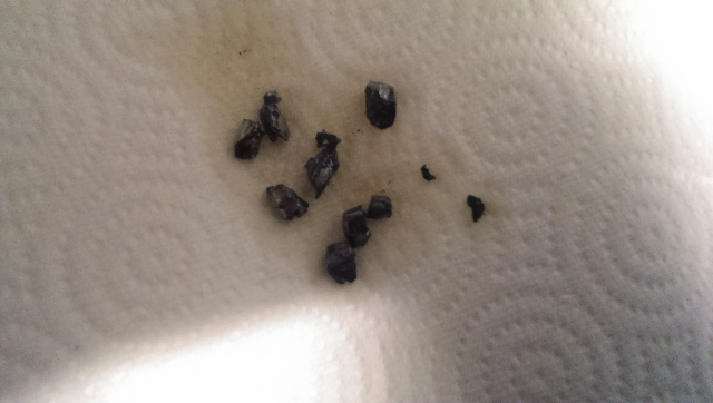

So my PTO has been chattering for a bit and no is occasionally kicking itself out of gear. So I pull the Mid-PTO assembly off to find what appears to be some small pieces of gear in the bottom of the case. She'll start coming apart tomorrow......
UGH! :thumbdown:

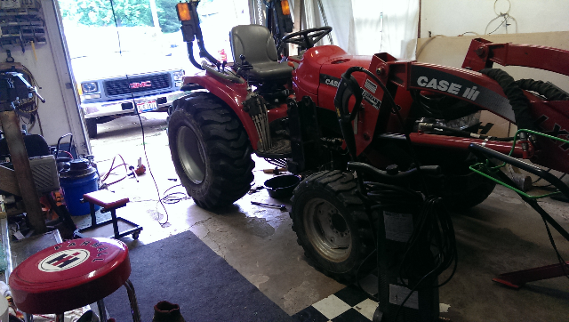

Tonight's progress in about 2 and a half hours.....
/ Shrapnel in gear case
Just another short update. Just worked on it for about an hour tonight. Got the rest of the ROPS off and the remotes off

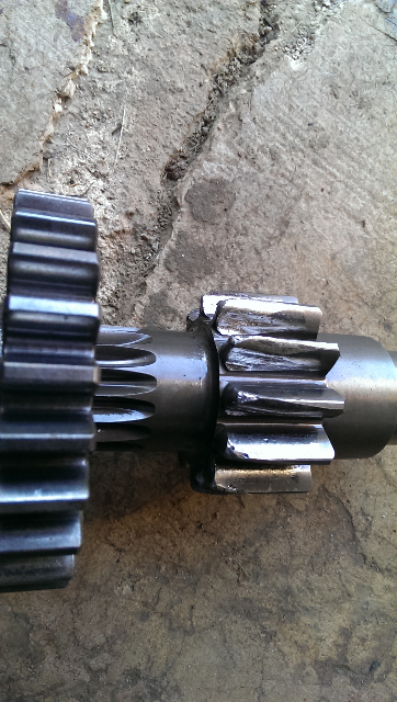

Found the problems I think.....
/ Shrapnel in gear case #9
oh my that looks like that has been a problem for a while?
When I got the tractor, the PTO lever was way out of adjustment making it so the gears didn't engage fully and starting the wear and eventual demise that you see here. Just ordered $550 worth of parts and we should be good to roll as soon as the big brown truck arrives.....

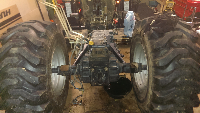

Jammer.... A fair number of hours to get to that point and I found a bunch of other little items I want to tidy up....but it does beat having the dealer do it and sure beats the price of a new one. Because of the height, this is all the bigger I can go and get it in my garage. Wanna see what the guts of your tractor look like?
/ Shrapnel in gear case #14
stomper that picture is exactly why I am not gonna do mine... tranny's and I don't get along....
