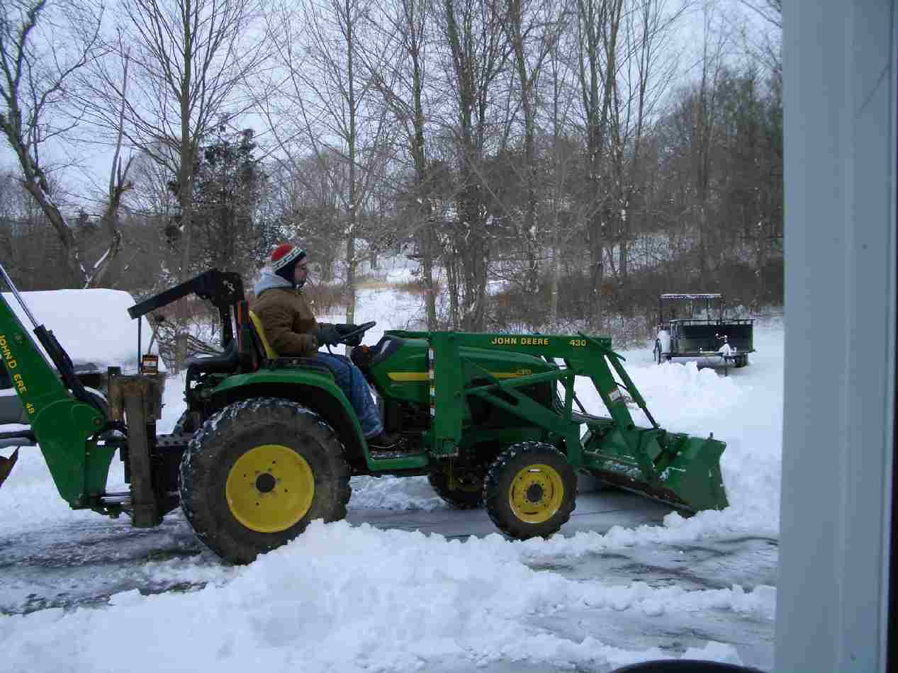

We received a bit O' the white stuff as well. See Pic. With the blacktop driveway I didn't find the angle to be much of an issue - it glides across it quite well.
