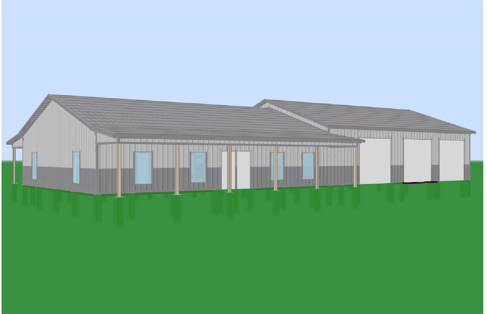

So the vision is a 40x100 post frame building. Half will be house, half will be shop/garage. We have designed the building and have it worked out exactly how we want it. Here's a 3D rendering of the building.

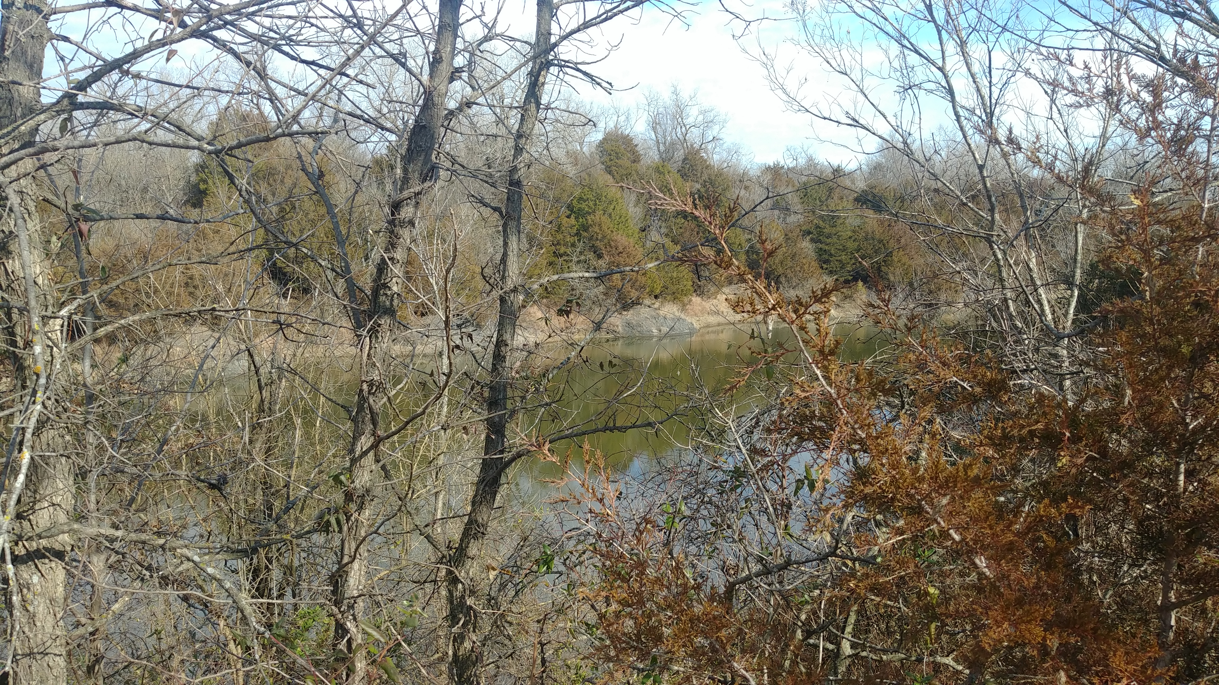

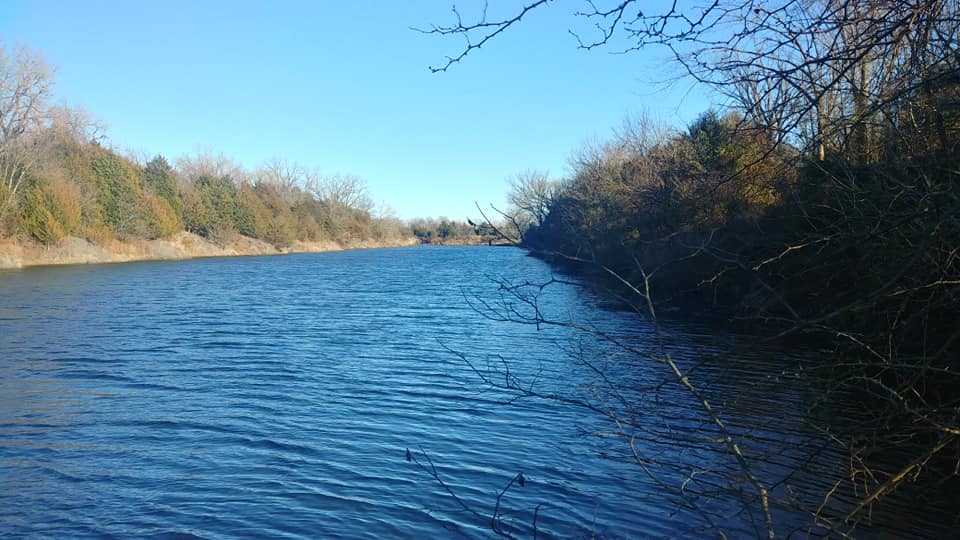

So we found some land we liked at a price we wanted to pay. We bought 10.3AC along an old coal mine strip pit in SE Kansas. The pit has long been filled with water, and stocked with tons of fish. Bass, crappie, bluegill, gar, carp, catfish etc. There's not many houses that have this kind of access. The vast majority of the land that was mined is now owned by the state and managed as a wildlife area. So anyways, we liked it and bought it.

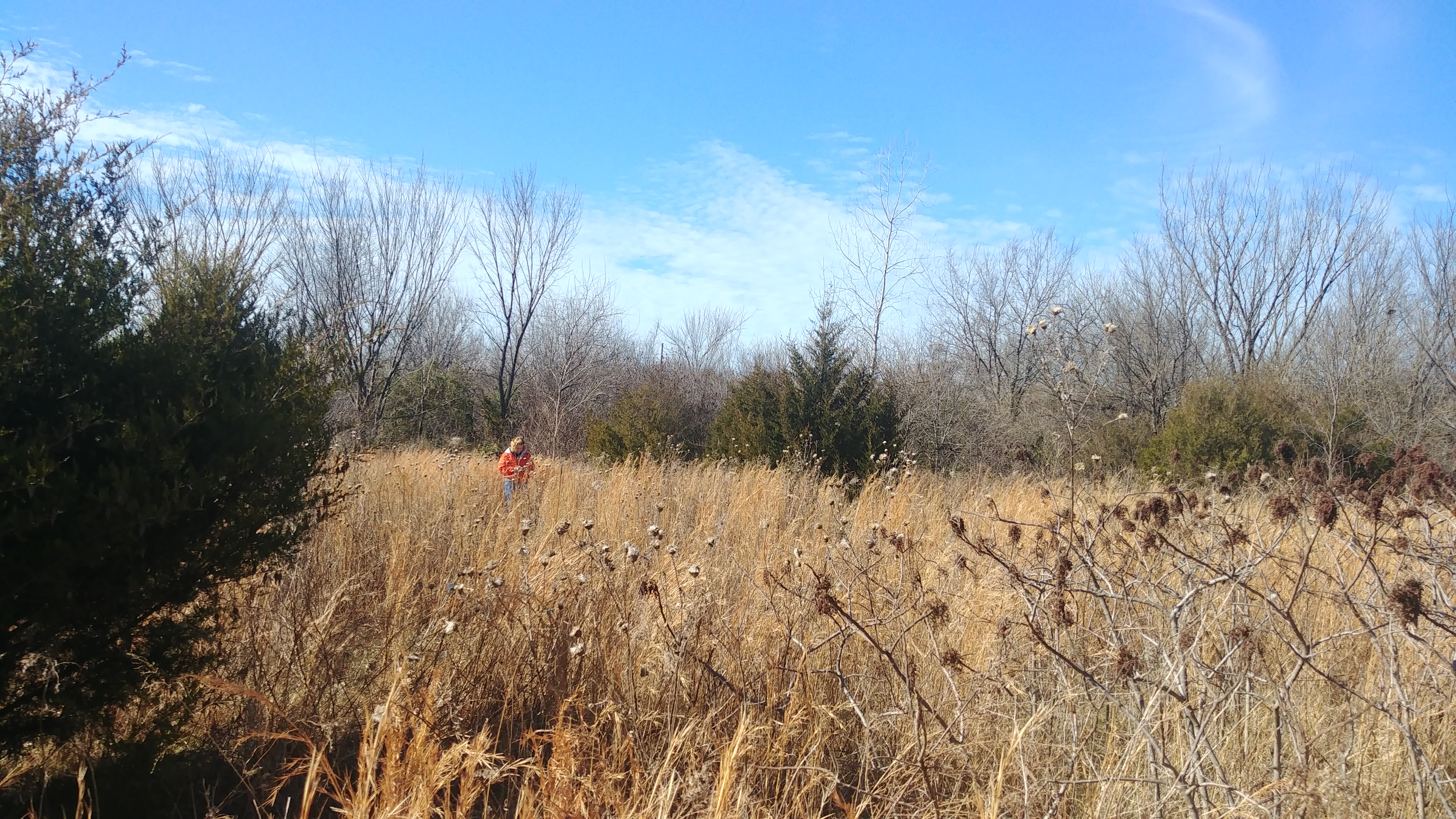

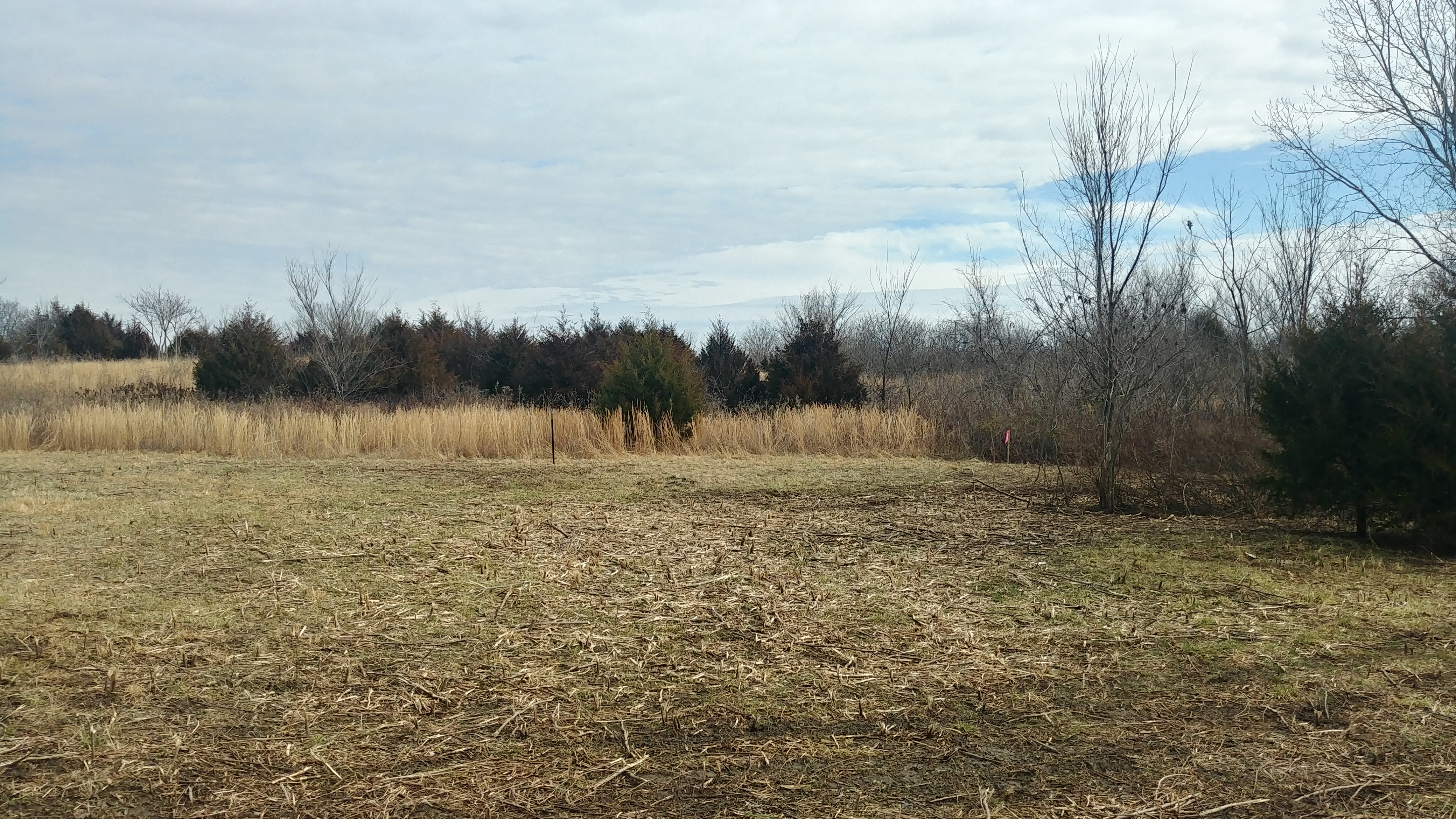

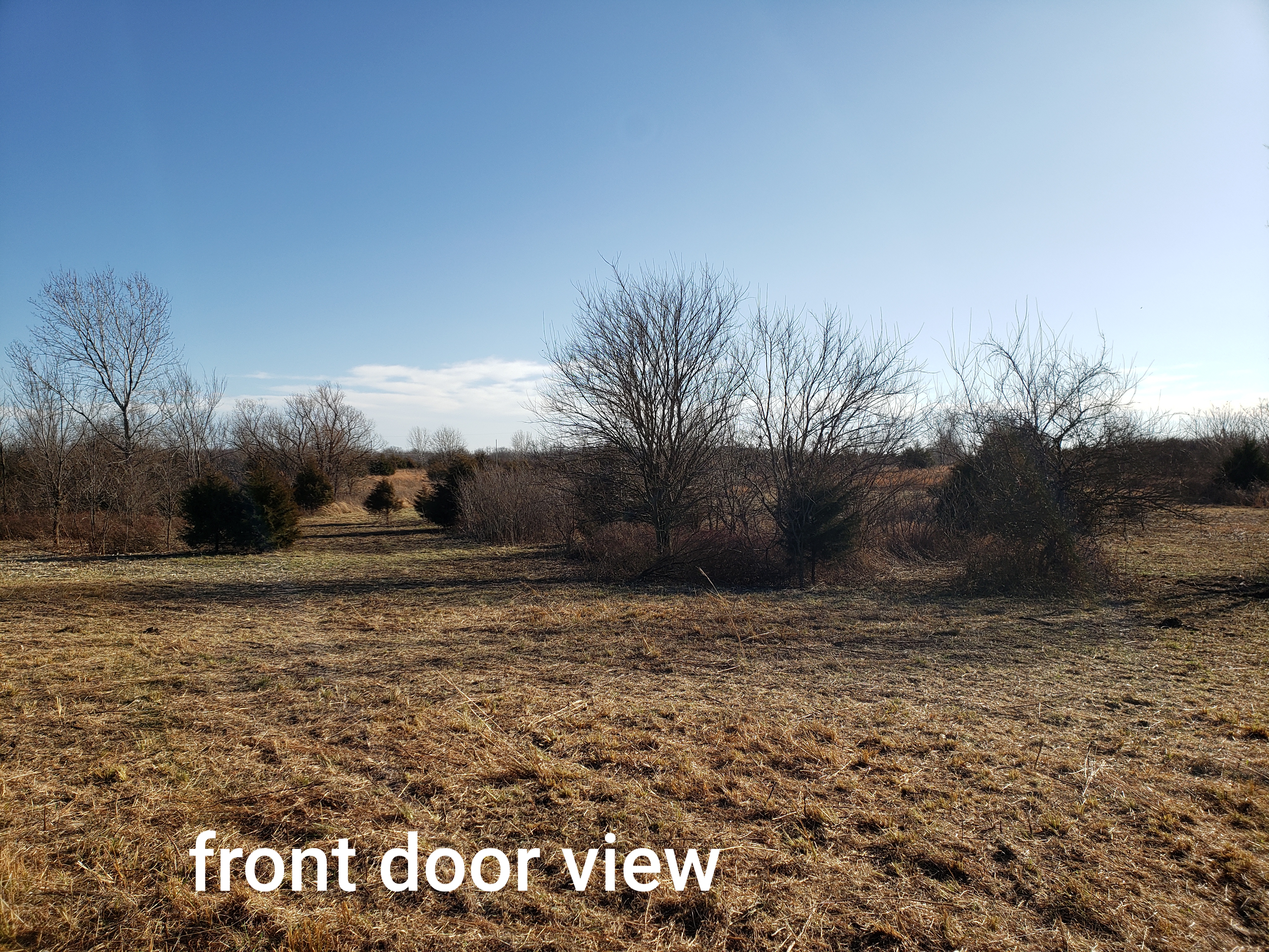

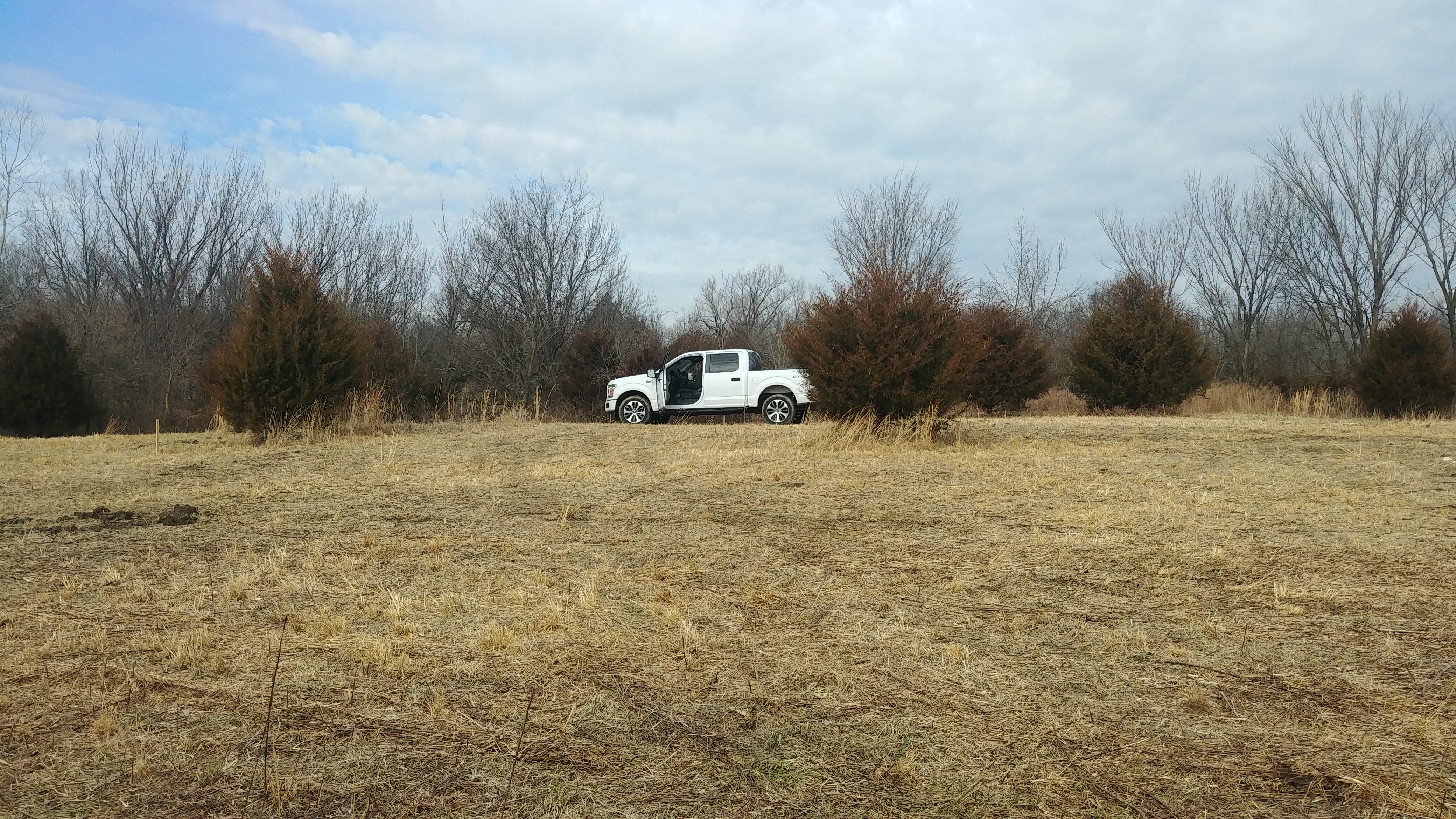

When we purchased the place, we found that it had been mostly cleared in 1998 but had not been touched since then. Being winter it made things a little bit more accessible, or at least you could kind of see the ground. It's all very overgrown. We did manage to locate the spot we wanted to build though.
Once we closed on the place, I decided to rent a tractor and bush hog to clear what I could. I have no tractor experience at all but I managed to get quite a bit done in 7 hours. I cleared about a total of 4 acres. There was a lot of Sumac in the mix that was 1 to 1.5 inches thick, so it was slow going. Plus I didn't know the ground below me, and that slowed me down as well. The grass was all dry and seed and garbage was also clogging up the radiator about every 30 minutes, so I'd have to stop and clean that all out. No screen on the JD 3039R for whatever reason. I got a good amount clear though.
Having cleared a good area, we were able to get the survey crew out this past Friday to mark the property lines. We also drove in a handful of T-posts to mark the edges in case someone decided to pull the wood stakes for whatever reason. The t-posts will at least slow them down a bit. I have no reason to believe anyone is even poking around back in there but experience tells me to take measures just in case.

Was Shouse a misprint in your title?
Congrats on the land, I'm looking forward to following your progress.
On your 3D image of the building, why the different roof lines? Making it all the same height eliminates potential issues in the future for leaking.
   / Shouse Build
I'm thinking "Shop/House", making it a Shouse. :thumbsup:
Correct.
As for the pitch change on the porches, that is one of the adjustments we are making prior to ordering the building. It will be 4/12 all the way down.
