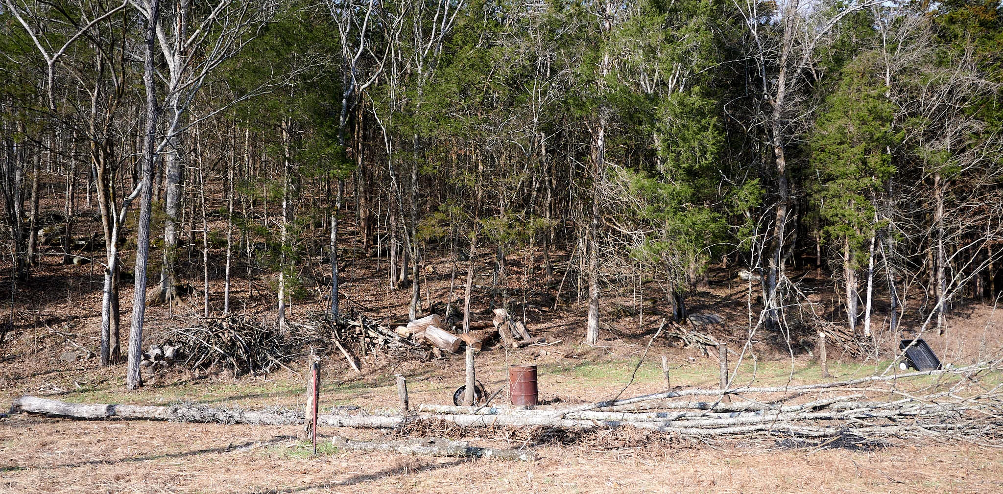

This may not have been the most efficient way, but I ended up finding a portable gas winch for $800-900 on eBay (PCW-4000). GX50 Gas-Powered Portable Winch. The cost added up by the time I added pulleys, rope, caribeaners, but the winch solved several issues.
1. It allowed directional falling of the trees to make them all fall in the same area even though they leaned in different directions. 2. Clearing the fall area before falling the trees allowed me to see where the thorns landed, too, and get them up to burn in a burn barrel. 3. The winch makes it possible to winch the trunks out of the way without a mini-ex or mini skid. 4. Hopefully, the thorns that I've missed are confined to this fall area.

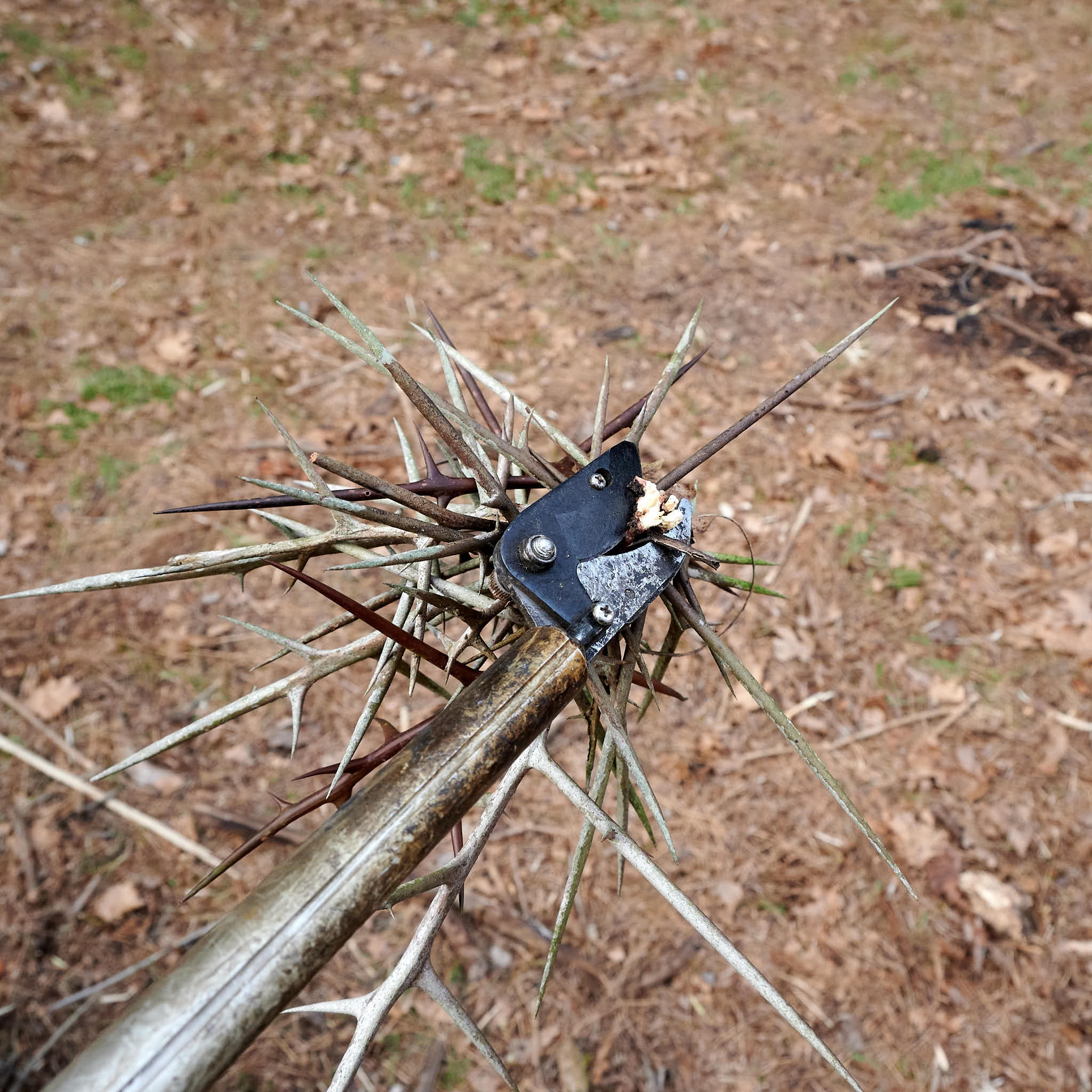

Someone recommended that I remove the thorns as far up the tree as possible before cutting. Pole saw is fast for this, but throws thorns. I ended up using a cut and hold pruner to get them off the tree to say 6-7'. Then removed the others after the trees were felled.

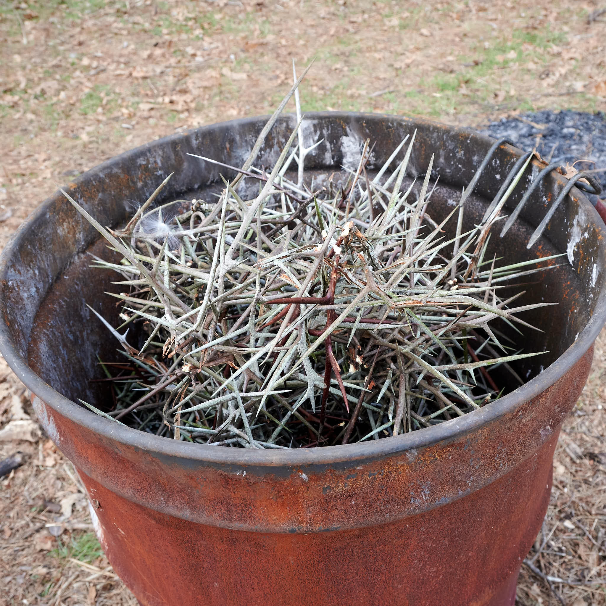

One thing I noticed was that I underestimated the volume of thorns. I filled a 55 gallon drum with thorns from just one tree and that was after compacting them in the drum. They burn quickly.

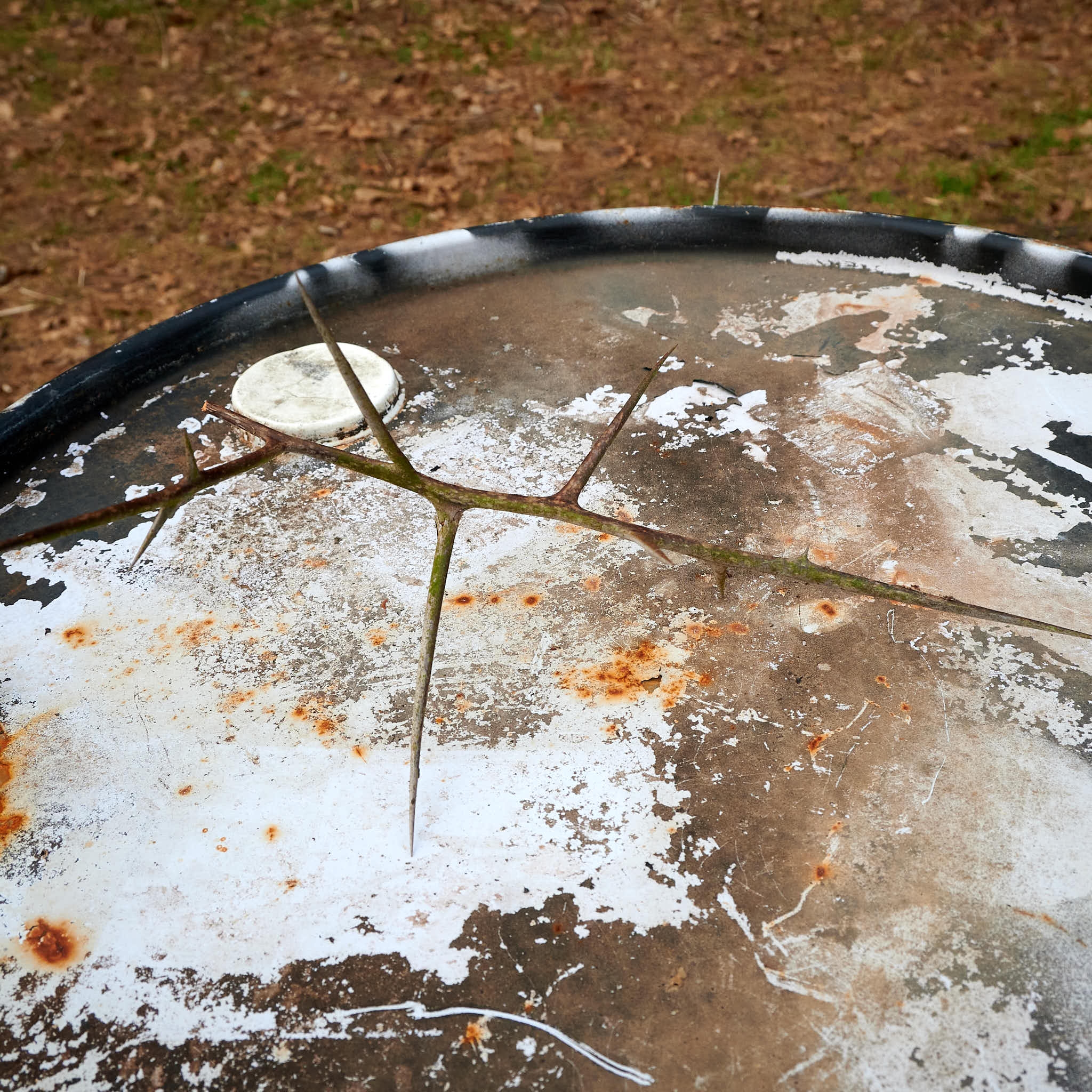

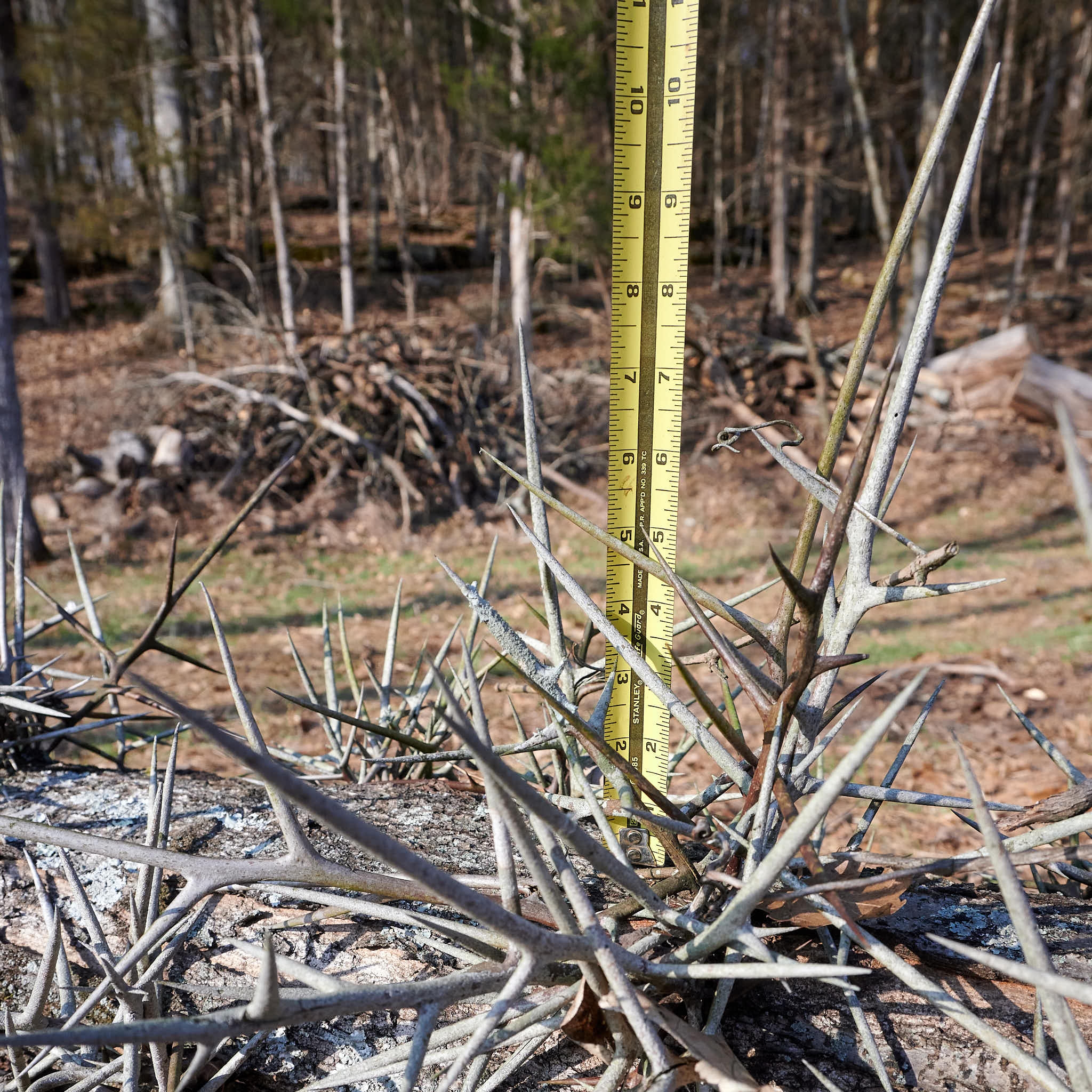

The triangular shape of the thorns naturally means that multiple thorns will end up pointing upwards when these things land on the ground.
If I tried to do remove them with a mini-ex or skid, I think I'd have spread the thorns more than doing it this way.
I suspect the older timers who didn't have access to today's power equipment would laugh at me. They had to cut these things by hand to make fence posts. Oddly enough, I searched the internet quite a bit for how to handle these things, and didn't find much discussion.
If I can get comfortable that I've gotten the thorns cleared out, might take the Terramite backhoe and dig out the stumps. Hand raking the area seems like the next part of this job.
