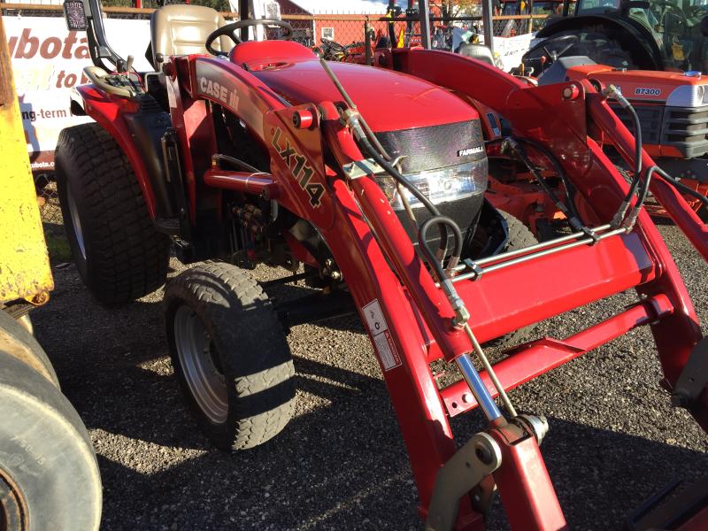

I am looking at a newer Case DX33 which is the same as the New Holland TC33d and I have been reading about all the horror stories about the loader causing the tractor to basically split in two. I have heard that loose bolts cause the issue to just poor design. The tractor is a newer 2006 model that has 1000hrs on it and looks like bran new. The tractor would pass as new if you didn't look at the hour meter, the last owner used it on a small farm and it always was stored inside.
Should I worry about the tractor cracking in half at the loader attachment points?

I have a TC29 DA which is the same as your TC 33.
Mine has the 7308 loader with the oversize bucket and a Woods backhoe. I've done lots of hard digging and (knock on wood) have had no problems.
   / Should I worry about a newer TC33D / Case DX33 braking in half?? #3
My '03 has over 1000 hours and no issues. I do check the bolts where the bell housing connects to the engine when I grease but never found one loose.
If the tractor likes like new then I would say it probably wasn't abused and could be a very good tractor for you.

The curved boom loaders have not had the issues of the original design.

Thanks for the info everyone! The tractor is for sale by the dealer that sold it to the original owner and he said he takes immaculate care of his toys. It really could pass as a 15 hr tractor but has 1000hrs on it.
He is asking $16k for it but when you consider a new kubota of similar size is over $25,000 it seems like a decent deal.
