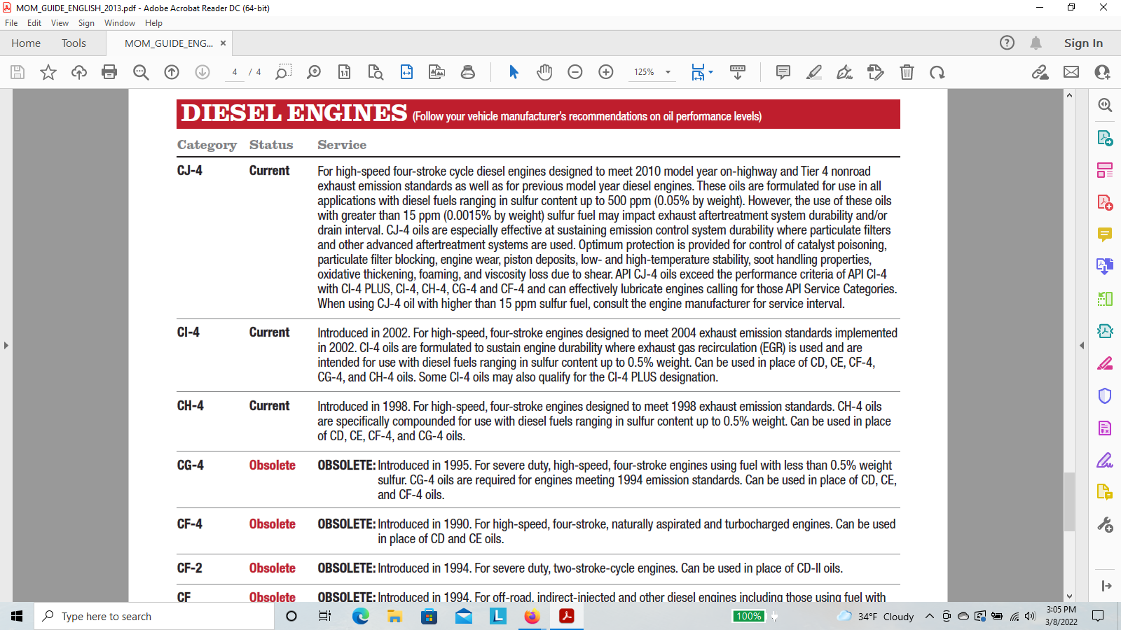

Deleted my response as it contained outdated information

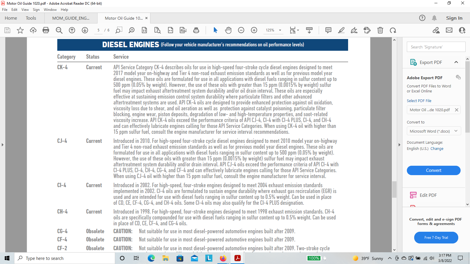

   / Should I use conventional oil, or synthetic oil in my tractor. #15
Well darn I opened up a can of worms but thanks for the insights. I'll continue to use semi synthetic api rated ck4 because it's what's readily available around me at a decent price, and my 30+ yr old tractors continue to run great using it, plus I change it seasonally weather I put 50 hrs, or 300 hrs on them.
