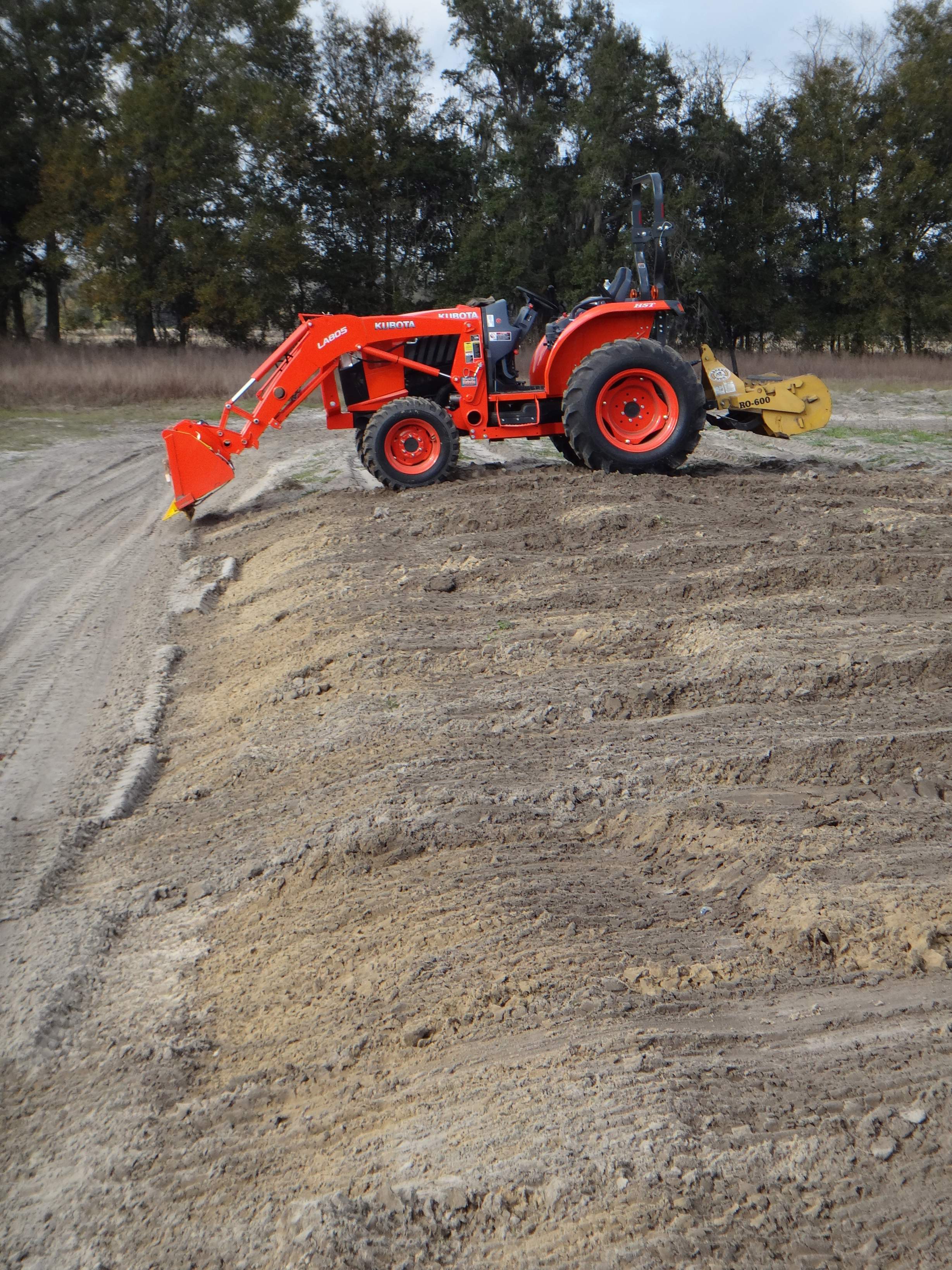

I would not ballast the rear wheels on a BX with Backhoe. The Backhoe probably weighs 600 pounds and protrudes to the rear, increasing its utility as ballast. Filling both rear tires will only add 150 pounds or so. With 23-horsepower you will not be capable of breaking traction on level ground. Should you have a tire puncture (I never have.) dealing with filled tires is a pain. For the same reason, omit wheel weights.
54" is a good width for Box Blade for BX23S. Be sure the Box Blade has enough weight to serve as Three Point Hitch counterbalance to heavy FEL loads when the Backhoe is off. The front axles on the BXs are pretty light. Three Point Hitch counterbalance reduces front axle loading.
A bucket of DRY sand or DRY dirt will not lift the rear wheels. Usually it is carrying green timber or moving heavy equipment with the FEL where counterbalance is necessary to keep the rear wheels on The Earth.
You will not need a ballast box with a Backhoe and Box Blade available.
Most with a Backhoe would not mount a digging Toothbar on the bucket. Most, not all.

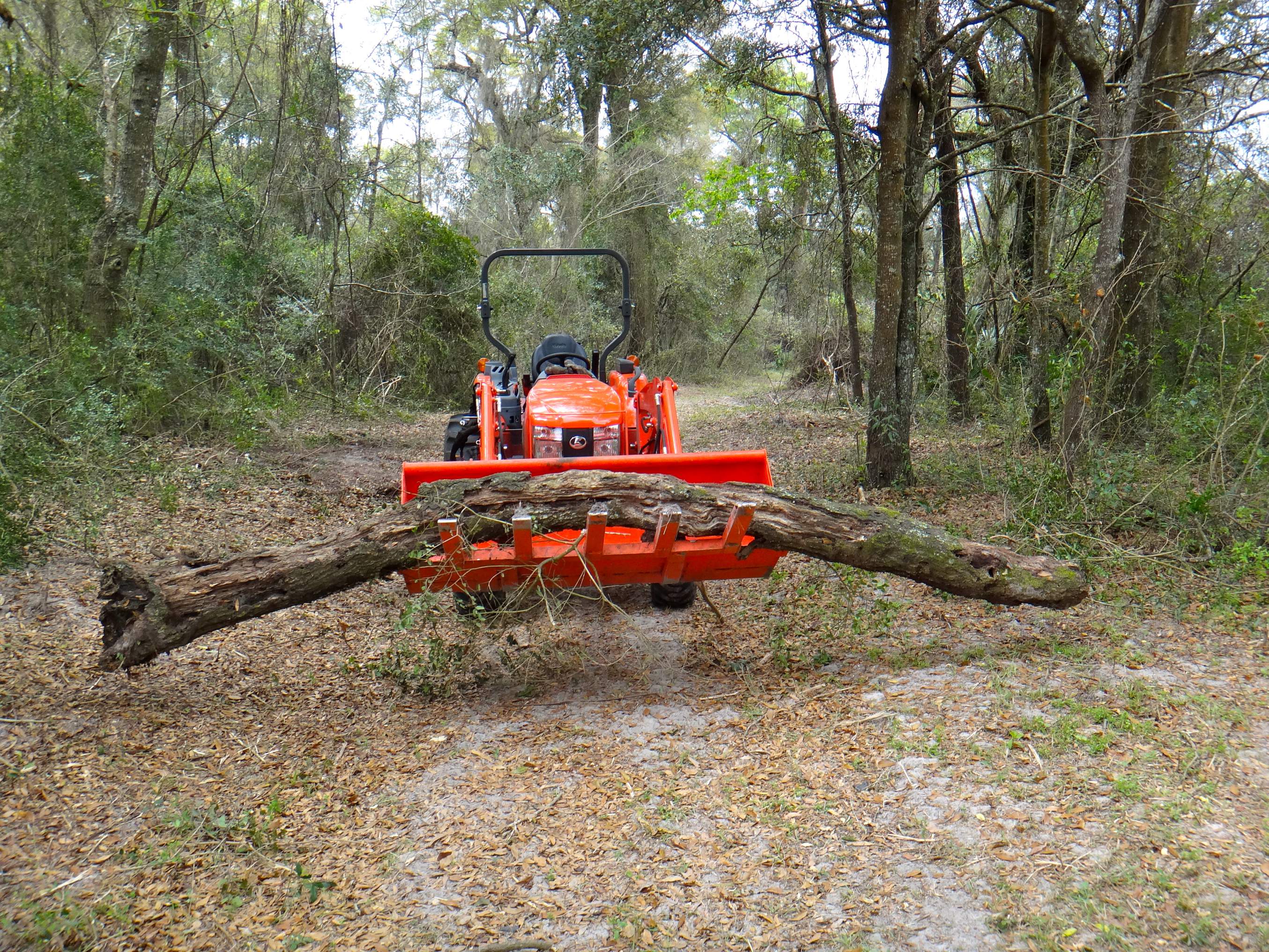

I would buy (relatively cheap) SSQA pallet forks first and see how you like them. Pallet forks should do 65% of what a grapple will do on a BX. Consider 26" and 32" pallet forks in lieu of 42" pallet forks, unless you will actually unload partial pallets. For moving limbs and brush the shorter forks are handier. Heavier than necessary pallet forks subtract from payload every lift. (The five tines on my clamp-on Debris Forks are 19" deep.)

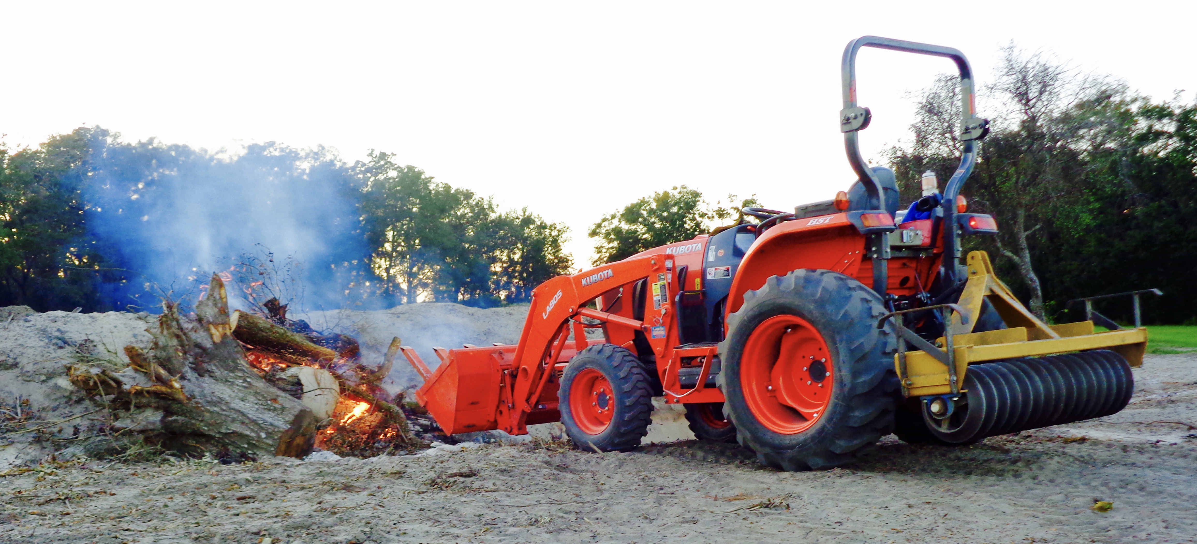

I do not know if the Ratchet Rake is available in Canada. You might inquire if the T-B-N STORE, an agent for Ratchet Rake, can ship to Canada. In my opinion RR is the #1 force multiplier for light tractors. RR is NOT for digging.
