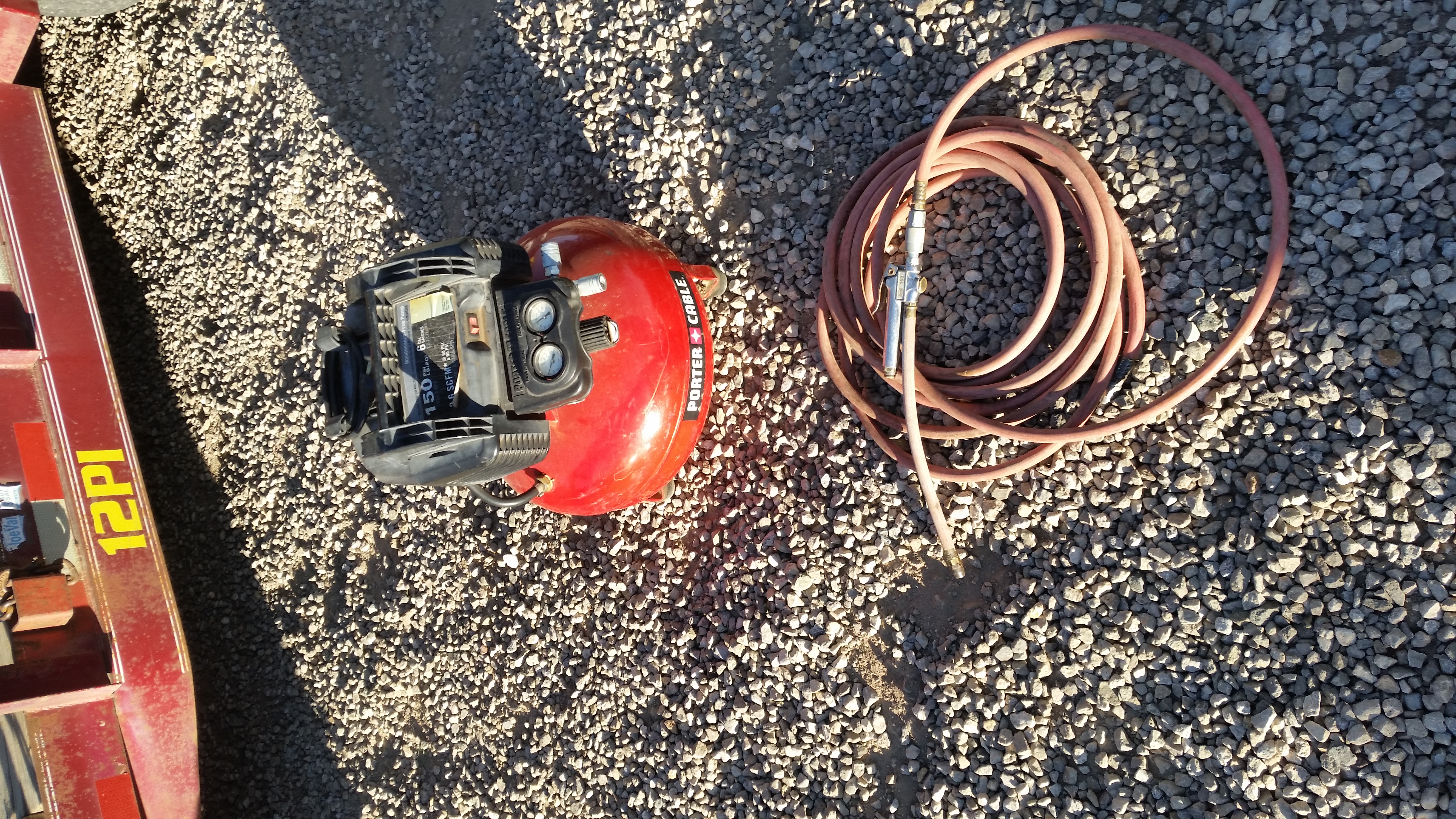

While I have a two stage IR and a heavy duty pancake I find the newest addition (and the cheapest) gets the most use. I bought a $100 PC pancake which weighs about 30 lbs. for airing up tires and other small jobs. This pressures up to 150 psi and has a 6 gallon tank so about the same as a portable air tank in weight and volume. I have a 20 ft. premium Gates air hose and Milton air chuck with built in gauge I use with this. No air leaks I can tell so this works great for carrying on my pickup or service truck, very convenient.

Lots of ways to address the portable air issue and what works best can vary greatly. I considered buying a portable air tank and/or another small tire compressor. For my use the little PC has worked out well for me, I have an Onan diesel genset on my service truck and have had poor luck results with the small 12v compressors. For $100 bucks this has been the best set up for me. simple and fills a low tire quickly. This allows me to keep all the long hoses rolled up and put away for large jobs.
