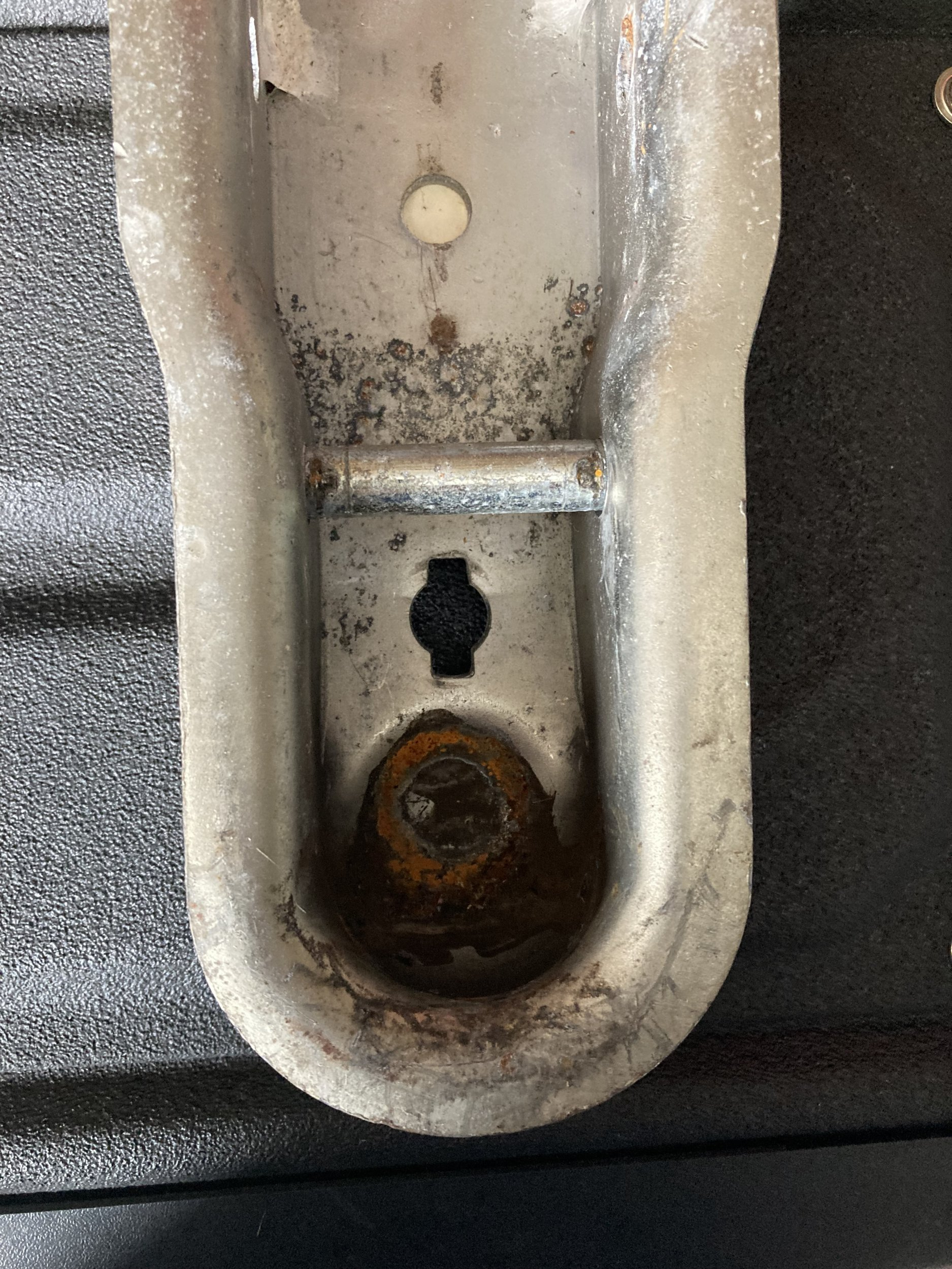

I'm the OP and here's what pushed me over the edge to replace. There are two photos here. The first one shows a straight-on photo of the hitch with the camera level. Notice the hitch looks slanted to one side and that's because it is. In the second photo, I tilted the camera on an angle to the left until the piece looked straight.
It's hard to see but what I think happened is the hitch was forced off on an angle with the hook latched. It bent the internals and as that was happening, the hitch racked itself and came off on an angle.
Bottom line is that a hitch that is forced off, like mine, should be replaced. It's compromised and the damage is not always easy to see.
