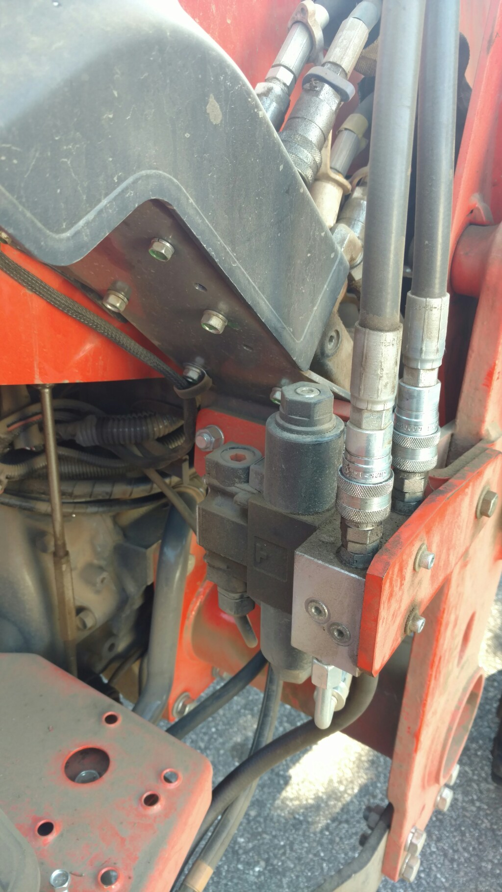

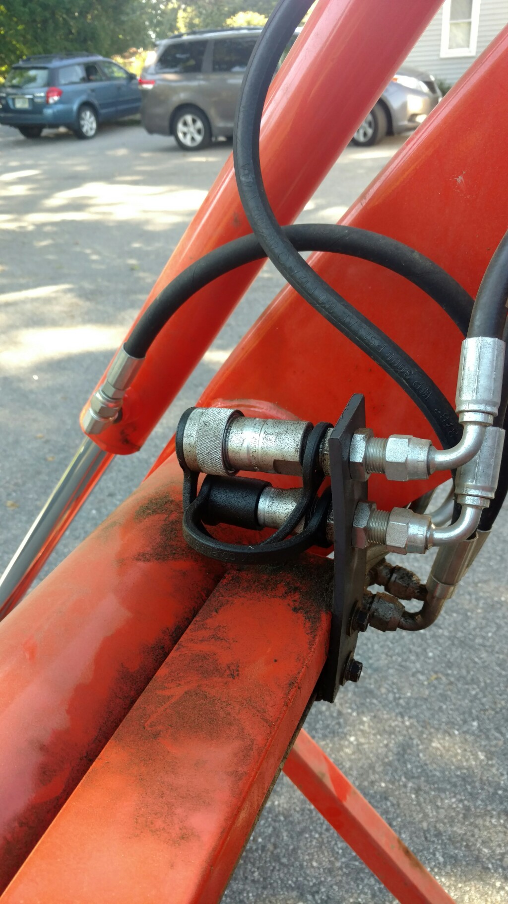

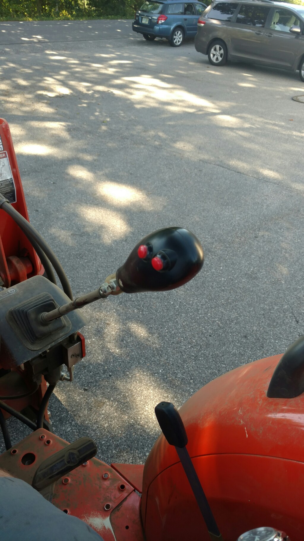

Got home early...
Diverter mounts below the loader valve body:
Buttons can be rotated however you want them:
QDs at the front (which I'm about to change to a break-away/connect-under-pressure configuration):

Got home early... Diverter mounts below the loader valve body: <img src="http://www.tractorbynet.com/forums/attachment.php?attachmentid=478043"/> Buttons can be rotated however you want them: <img src="http://www.tractorbynet.com/forums/attachment.php?attachmentid=478044"/> QDs at the front (which I'm about to change to a break-away/connect-under-pressure configuration): <img src="http://www.tractorbynet.com/forums/attachment.php?attachmentid=478045"/>
Thank you very much for the pics!!!

LSN... I'd love to see your break away-connect under pressure set up when you do it! Always thought that was for bigger equipment.
   / Should I have dealer install loader hydraullics for grapple on new tractor? #17
Got most of it done tonight. When I finish tomorrow ill make a new thread with a link here. I think it'll be pretty slick. :confused3:
