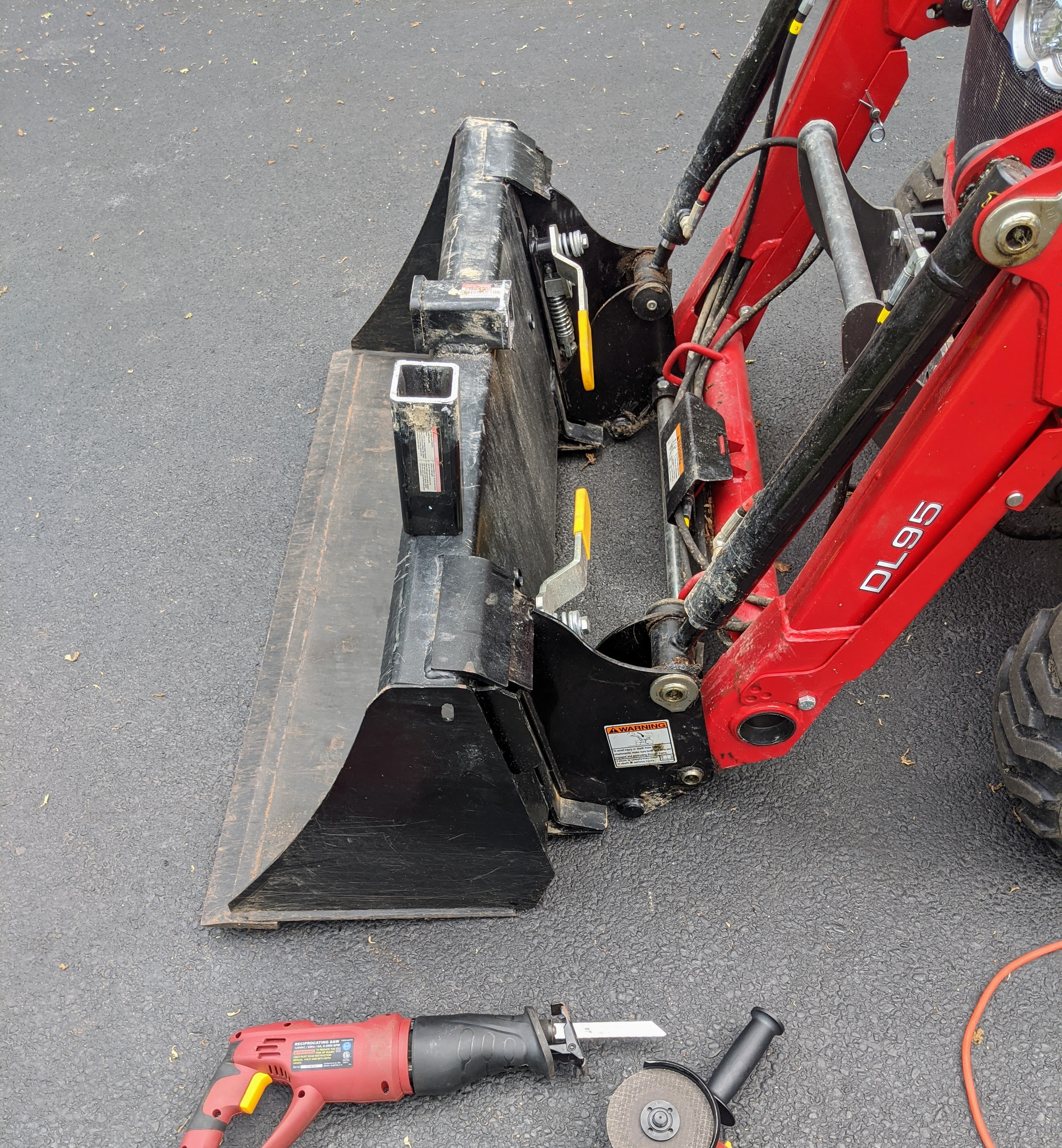

Should I hack the back end of this sucker off, or no?

Why weld on hooks? Use your 2" receiver.
Gene, Mossroad has shown you a lot of options for your receiver hitch.
I have a few "tow rings" (have 1 with each of my vehicles + the tractor) and if you do a search you can find one that has the extra mounting holes to rotate it 90 degrees.
As for the 2" trailer ball for the receiver, once in a blue moon I'll use it to move my fishing boat.
You can really get just about anything done with the receiver inserts, but I also have hooks mounted on the top towards the outside of the bucket that is handy for moving a large stump that can be rigged to reduce swaying.
If it's not hurting anything, I'd purchase a receiver insert of your choice, just reinforce the receiver a little, and continue to use it as a visual aide to level the bucket.

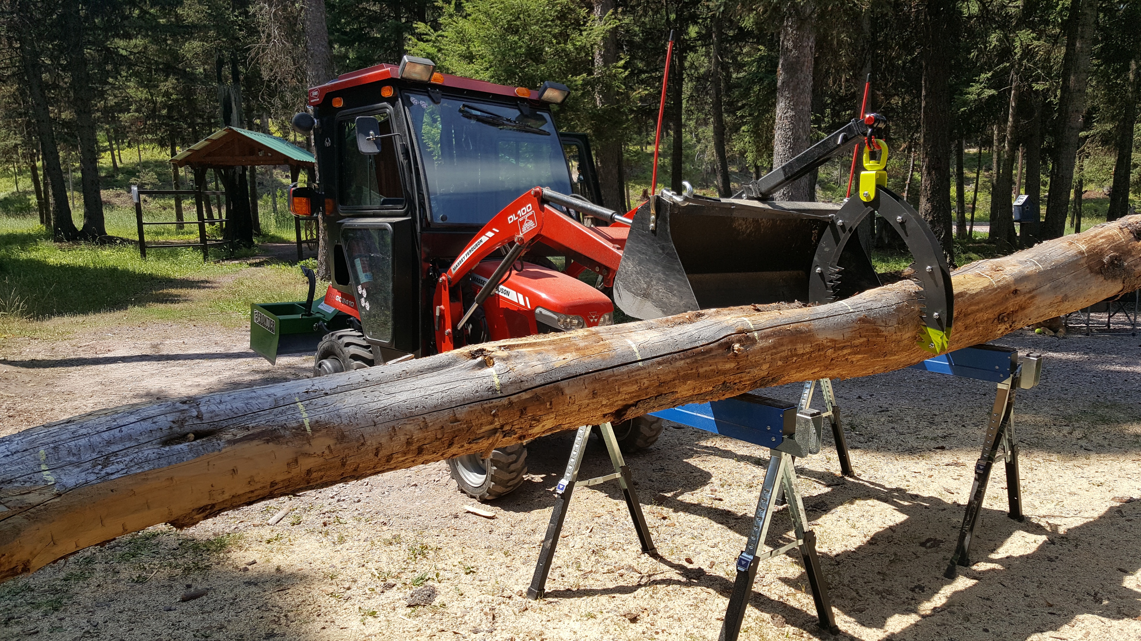

Here are a few pictures of how I am using a receiver on the bucket, my jib, and my "poor man's grapple".
Good luck, KC
