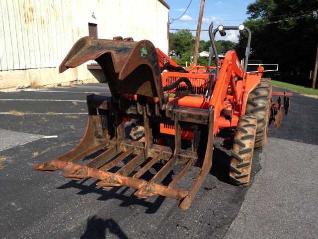

I have a Kubota M6800 with a LA1002 loader. It is not a quick detach. I have wanted to have one bucket with a grapple on it to grab brush,tree limbs etc along with a bolt on tooth bar for digging purposes to keep from beating on the tractor when working on my roads and such. I then wanted a plain bucket for firewood, horse manure, and general carrying duties. Is the ATI bracket the way to go on this ? Someone had said that I cannot get parts from Kubota to make this quick detach setup with my loader. Any thoughts are appreciated.

I've an M4700 with a LA1001 loader, very similar. My "local" Kubota dealer says there is a QA bracket available for the FEL from Kubota and the price was around $700. Then I just need to get the mount plates and modify my bucket.

i have the same tractor. I have the ATI Tach All adapter. I've been fairly pleased with it. I think Everything Attachments sells them.

I have an ATI. Good unit except the throw of the pins is too short and some of my attachments hang up on the adapter when I detach.
Any other full attachment conveters out there? All I see is WR Long and they are heavy. The ATI ones are light.
