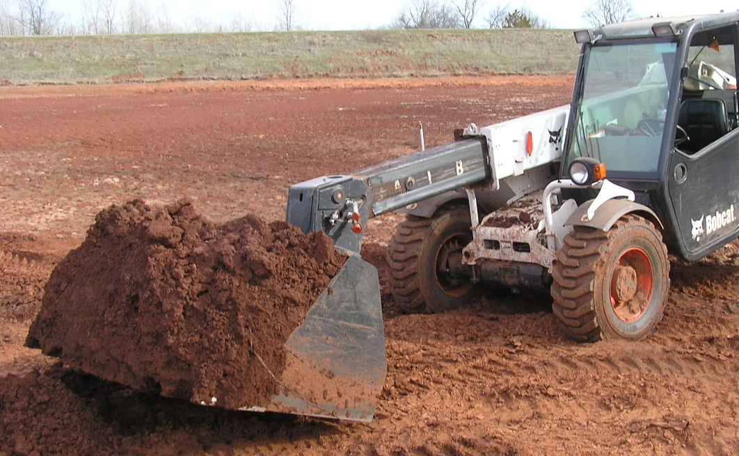

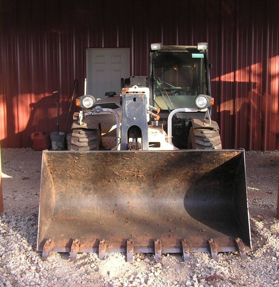

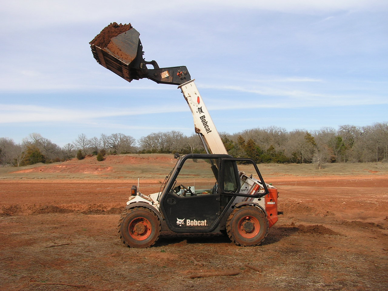

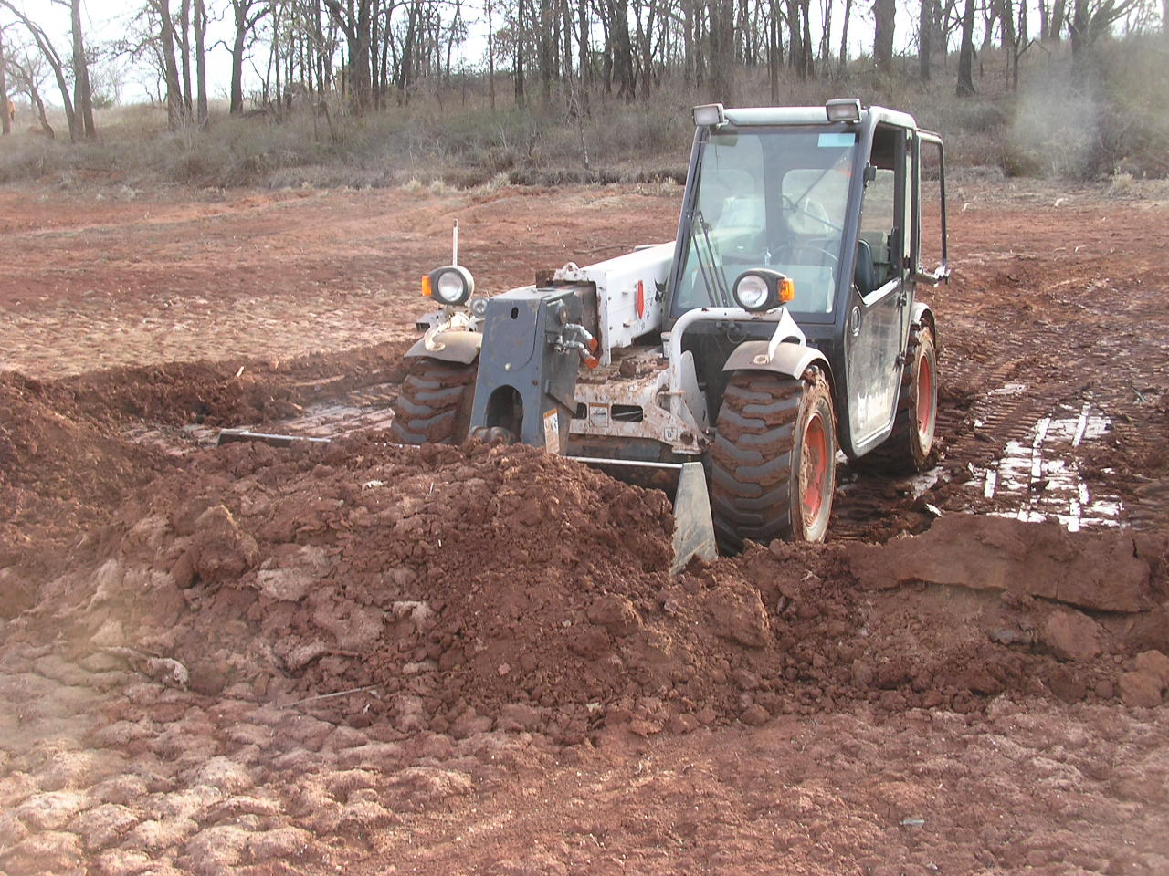

You didn't mention your budget, but there is a machine that I prefer over a tractor or a skid steer. Most guys are not familiar with a compact telehandler. I sold my MF240D soon after I bought my first one, click: Compact telehandler
