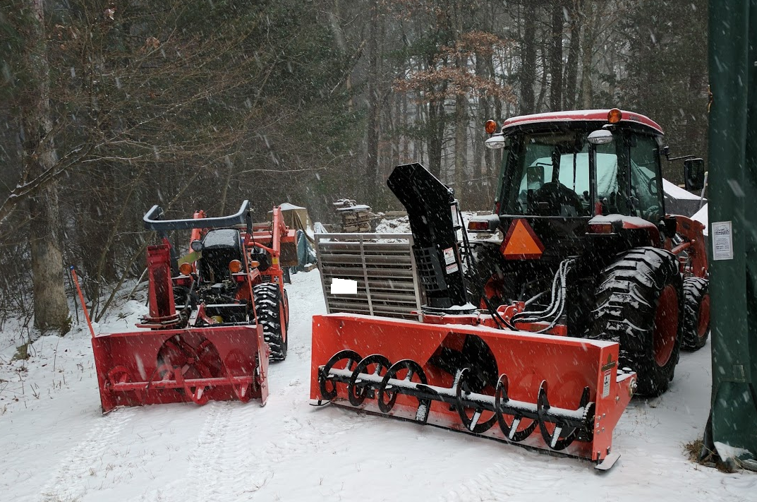

I don't have anything new to highlight, but I'll add my experience. I'm in NH and have both a cab (L5740) and open (B2710) compact tractors. And I grew up farming in Maryland with a fleet of open Farmalls, and a JD 4040 (cab but no A/C), so I've lived through mid-Atlantic humidity. 97 times out of 100, I prefer an open station for a compact tractor:
  • Better visibility & awareness all around
  • Easier to hop on/off for landscaping, hauling, and logging tasks
  • No mice nests: all my tractors live in the same shed, and I'm always fighting mice in my cabs (L, excavator, skid steer), but never in my B
  • Less stuff to break/maintain: no HVAC (mine needs recharging as we speak), no glass doors (been there 2x), mirrors or antenna (done that)
  • Easier to change 3ph implements, operate a PTO chipper or logging winch, etc.
The only 3 times I really appreciate my cab:
  • Bush hogging the field edges. This invariably happens on the hottest & muggiest days of the summer, kicks up a giant dust storm, and is guaranteed to find every hornets & spiders nest. A cab is a harder to get under tree branches than a folded ROPs, but worth it. For open field mowing, a canopy is good enough: dusty, but bearable.
  • Snow blowing during a blizzard. I prefer to plow the driveway after it's done snowing (quite enjoyable in an open cab), but when I have to run the 3PH snowblower down my 2300' driveway in a blizzard, a heated cab is a really nice place to be.
  • When kids are riding along, the cab is safer.
If I had to consolidate to a single tractor, it wouldn't have a cab.
