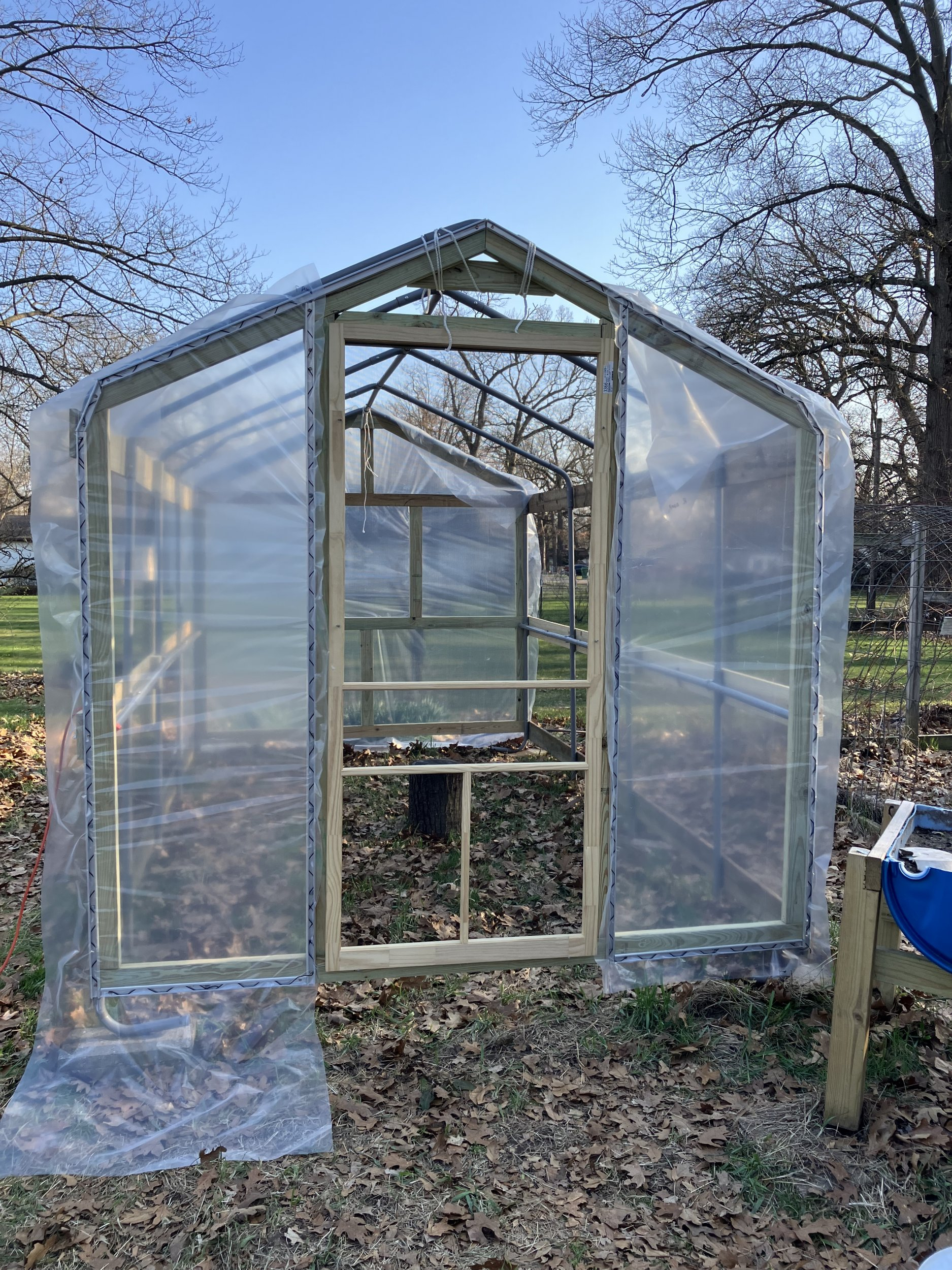

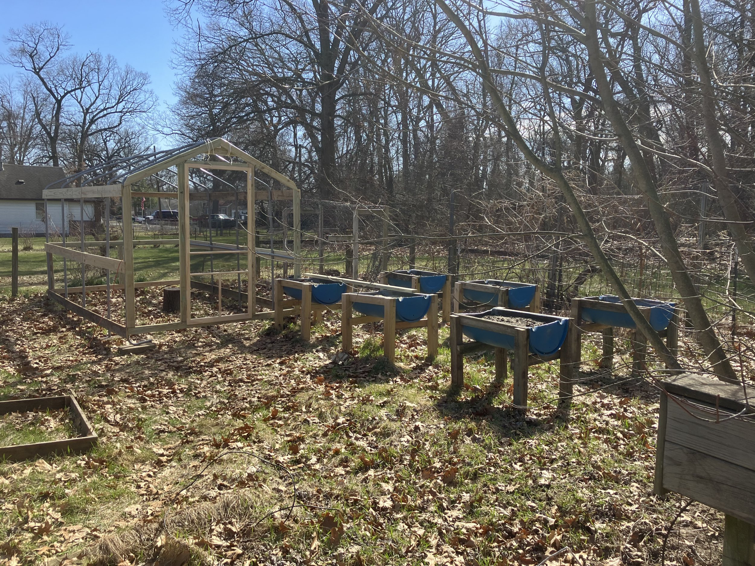

I was going to get a HF carport then wrap it in 5mil clear plastic sheeting, then frame a doorway and windows out. Then basically do raised beds inside. It's 10' wide so I was thinking 3' on each side with a 4' in the middle. I have a south facing back area, but if it gets to hot in the summer, i'll cook my plants.
That is exactly what my wife and I are doing. Neighbor gave us a portable car shelter frame after his cloth cover rotted out.
However, we are going to use it for like others have said... early spring start, later fall harvest, and keeping the rabbits and woodchucks at bay. I don't think it would withstand a snow load in winter.
I plan on pulling the top/side covers annually.
Here's the start we got on it last weekend.
I pulled the sides in to make it 8' wide and more vertical of side walls. And I removed some length between the arches to make it 14' long. It was cheaper for me to purchase a wood screen door for $34 than build one. I framed the ends to make it more rigid, and I installed metal channel and wiggle wire to hold the plastic. It's 6 mil greenhouse plastic.
Before I install the top and sides, I'm going to dig holes under each corner and add a few bags of cement and some rebar to hold it down. The wind load will be pretty good. I'm also going to lay a wall of concrete blocks around the walls to help deter the woodchucks, as well as lay some chicken wire around the outside edges on the ground to deter digging.
We're putting 1/2 x 1/2" hardware cloth around the bottom 3' of the whole thing, door included.
I have some flexible clear vinyl cloth like you'd see in Jeep convertible windows that I'm going to stick on the inside of the door with magnets to allow for ventilation or closed up. Same thing on the vent on the other end.
The bottom 2' on the sides will be able to be rolled up in warm weather, and the hardware cloth will keep the critters out.
One thing I do wonder about is pollination. I think bees can get through the hardware cloth, but I might end up having to hand-pollinate. Still have to read up on that.
What will you be raising? Many cucumbers are self pollinating. Tomatoes are easily done with a Q-tip, as you indicated.

Tomatoes and cukes. I've done the tomatoes by hand in the past when we had no bees.
Probably salad greens, and some carrots. And some flowers for the wife.
Pretty much whatever we feel like.
Gonna go back to Mel Bartholomew's Square Foot Gardening methods. Very productive in a small space. I bought is first book after I watched his show probably 30 years ago.
