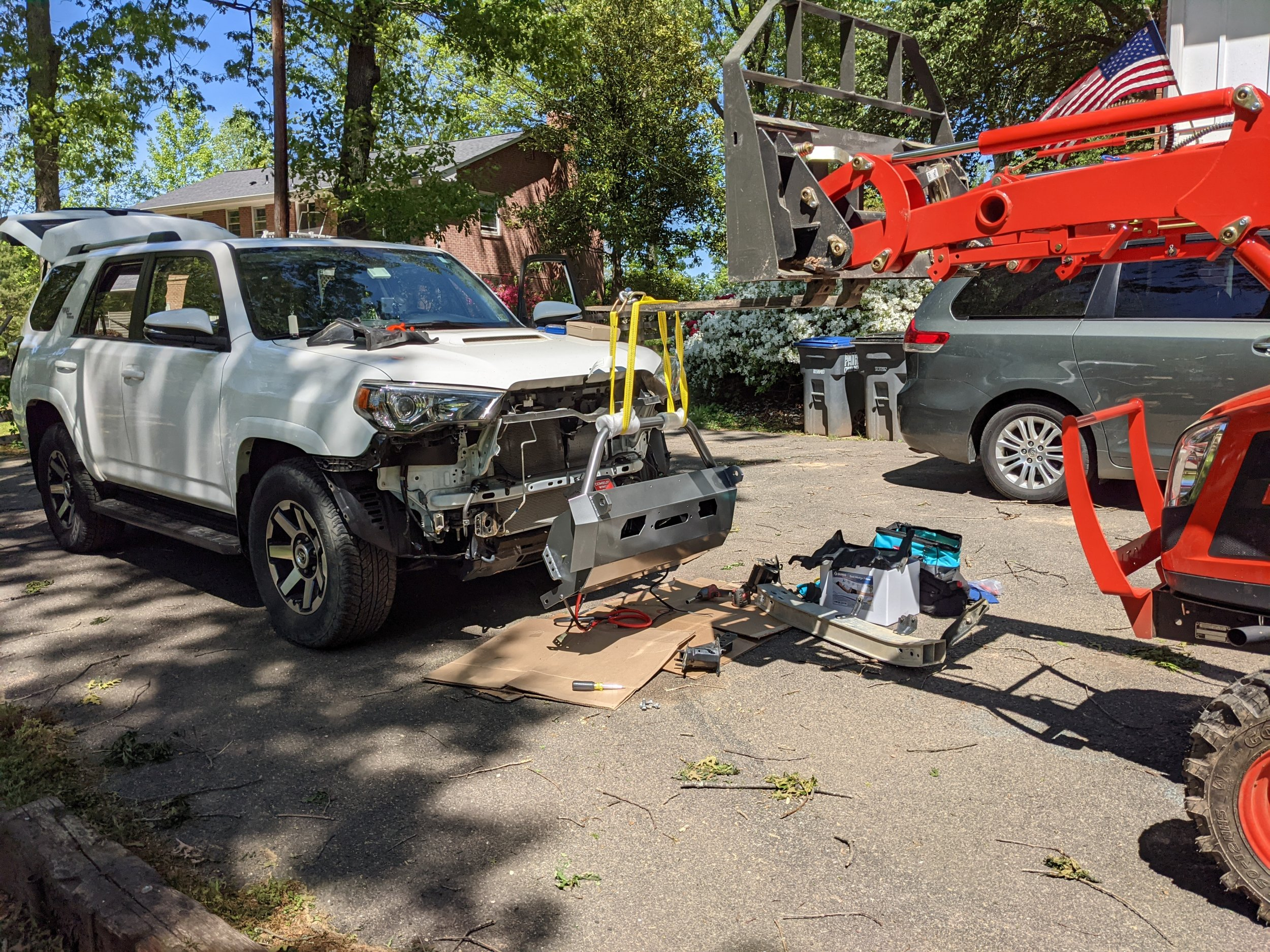

I was helping a buddy of mine install a front bumper on his 4Runner the other day and with the tractor on and idling the forks would bleed off slowly causing the forks to start pointing down. I know this will happen if the tractor is off but I was surprised it was doing it with the tractor running. Is this normal? Here's the setup. Bumper and winch weighed maybe 130 pounds.
