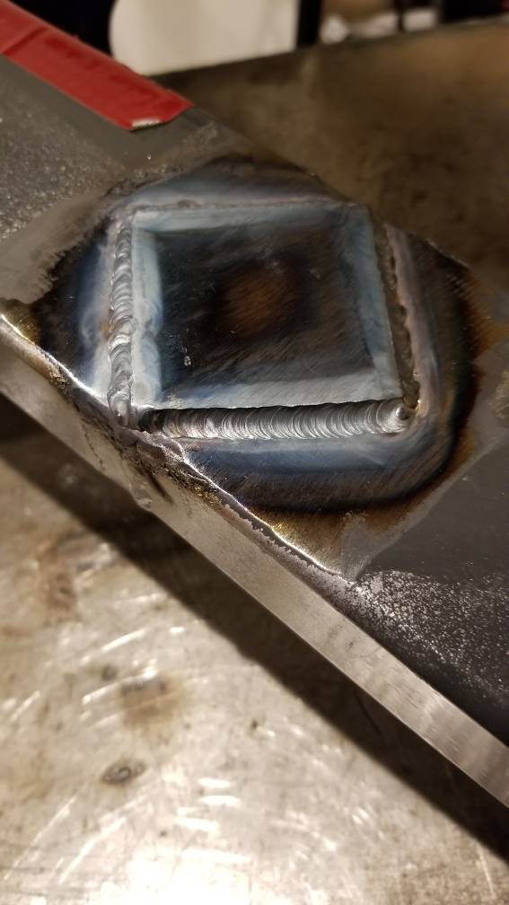

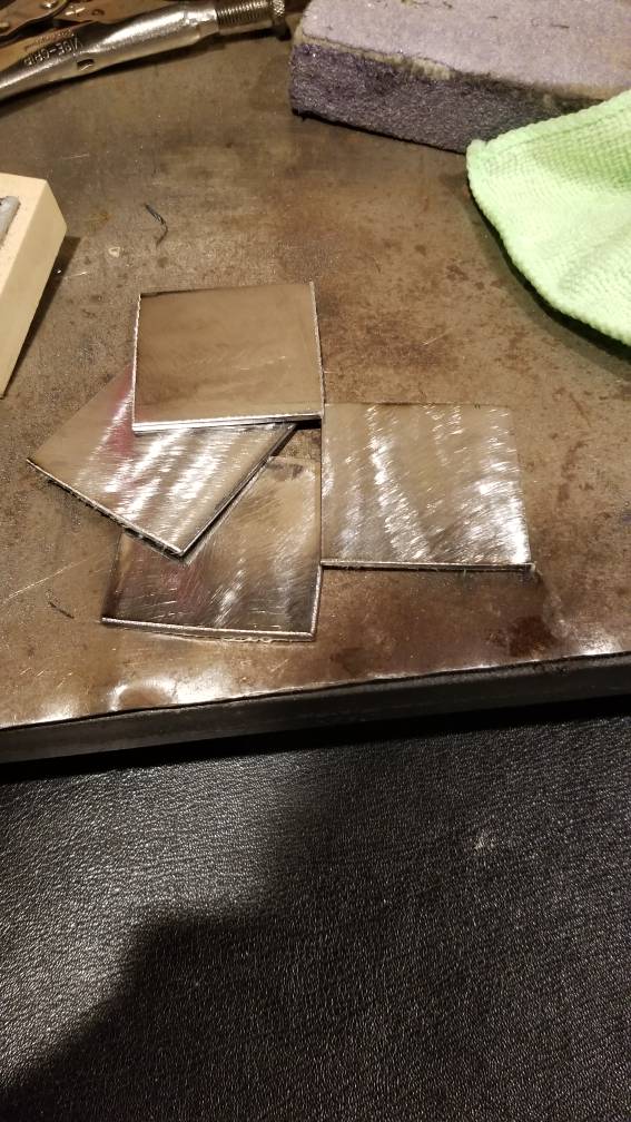

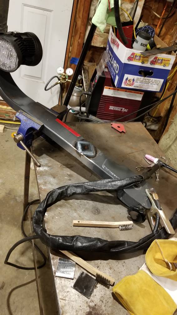

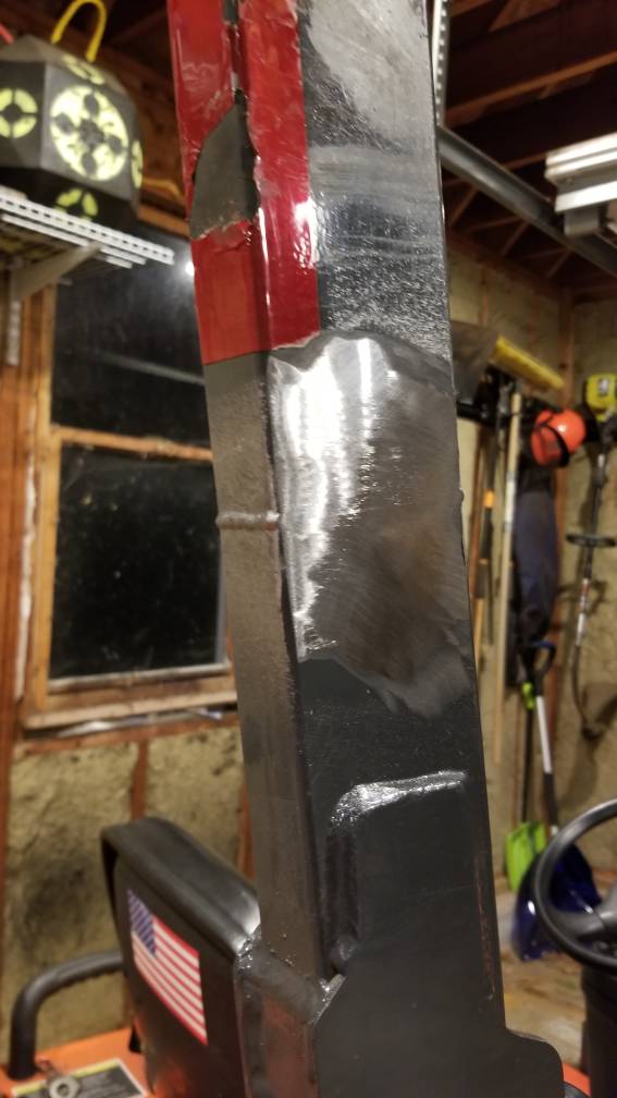

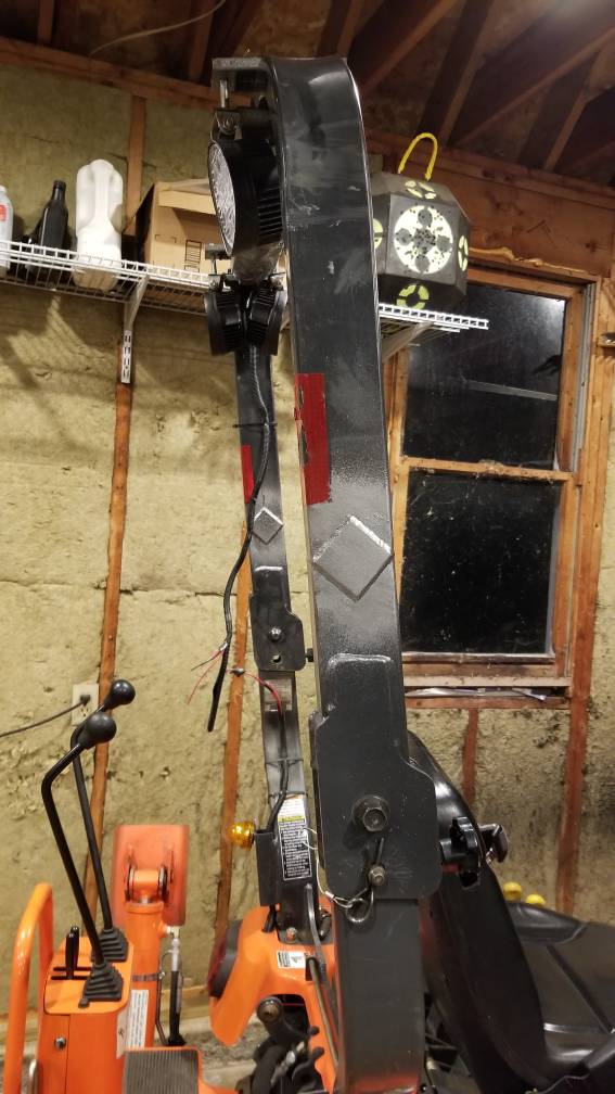

I had a lot of fun tonight.
About another 2.5 hours cutting sqaures and cleaning up metal to provide support.
I like it. 20181205_220952.jpeg20181205_221011.jpeg20181205_230525.jpeg20181205_230537.jpeg20181205_234921.jpeg

Nice job Underwhere... no criticism from me here. Someday I might shorten my ROPS a bit too, to get in my garage without lowering. I don't regularly park my BX there so it is not a priority but I have come to an unexpected halt a couple of times when I forgot. Seems I have learned my lesson so it is lower on my priority. :D
I think if I do shorten it, I would probably go with an internal sleeve design (for esthetic reasons) vs. external doublers (or diamonds in your case). But I have to say your doublers 'look' great and far more pleasing than scabbing on rectangular ones! :thumbsup:
Now for the purpose of a diamond shaped doubler vs rectangular... they are generally meant to gradually transfer the load/stress. This is very important in fatigue situations... not so important in a static or a one time loading situation. I could go on about structural design engineering but bla, bla, bla...
Thanks for posting your pics! Oh, and nice welding too. :thumbsup:

I started this thread and just now realized I never did a completion post. Sorry about that. I do not have a welder so I cut three inches(?) off the bottom and redrilled the holes. So you can get it shorter by either method; cut the top and reweld or cut off the bottom and redrill. I am glad I did and I don't think I have lowered it since I shortened it. And I do wear my seat belt at all times now.
