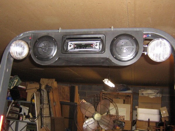

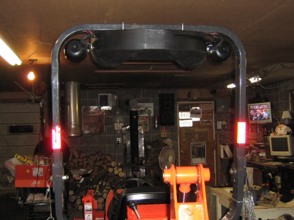

I've also toyed with shortening mine as I've seen no liability issues that have arisen yet with the multitude of BX's with std ROPS modified w/Woods BH's. Seems if there was an issue with the ROPS being too short that Woods wold have included a taller ROPS w/the kit. Course they may have some disclaimer in the fine print of their paper work to cover that.
Kubota is known to overbuild to avoid lawsuits, like how they've made sure the BX 50 series tractors will definitely stop abruptly when slowing/stopping in reverse. Internet rumor has it that this was due to a lawsuit because the earlier BX series would not stop abruptly. Was this a good modification? Obviously not since it's being modified on the new 60 series to work more in line w/the earlier BX's (00 and 30 series).
re. the tall ROPS on the BX TLB's, perhaps they want to make sure that tall operatiors, real tall operators won't bang their noggins :D
I mounted a 4 1/2" entertainment and lighting housing to the underside of my ROPS and it hasn't interferred w/my noggin in BH mode and I'm at 6'. The ROPS can definitely be shortened in my case....
