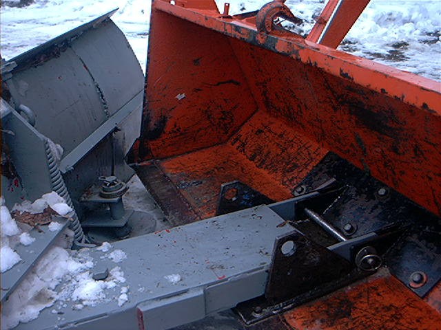

Indeed your right about being less tippy,but I yet to have any problems.
The B7100 has a chain from the 3pth in which your able to fasten to a hook under the set,than lower the 3pth until tighten which release strain from the hydraulics.

Yes I let the frame rest on the bucket,for there seems to be enough weight w/no bouncing.
The guides to keep frame straight,I drill holes and if need be I can insert a rod to keep the frame from lifting.
I to have a steep area to plow and w/little practice in no time,you shall know how much to lower & curl your bucket.
The light fluffy snow I don't have a problem back draging,but that wet heavy snow I make a mess back draging. /w3tcompact/icons/frown.gif
