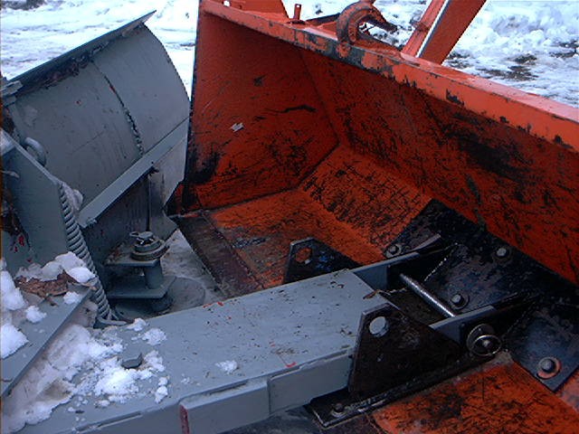

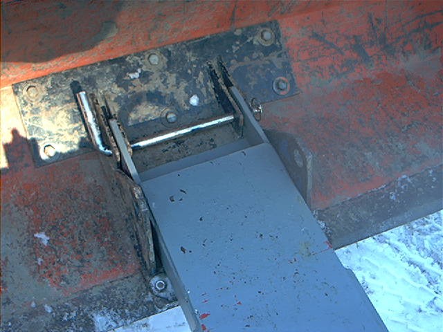

I'll try and answer your questions plus w/photos.
Frame to bucket I bolt on,and piece of flat steel on the back of the bucket for stenght..so I won't damge the bucket when plowing.
Single pin setup.
Guides for the plow frame kinda a must..less wear & tear on the pin hitch.

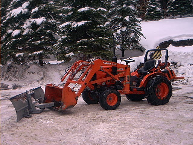

I lower the bucket 3 or 4 inches from the ground..just enough so the shoes rest upon the ground.

Also set the bucket 3 or 4 inches from the ground when plow set for straight pushing.

When the plow set for 45 degrees,the back of the plow rest against the corner bottom of the bucket for support.
When the plow set at 45 degrees,the end of the blade plows 6" be on the rear tire..<font color=blue>MarkNH<font color=blue><font color=black> plow reaches foot be on his JD rear tires..much better idea than mine.

With the pin hitch and the the trip springs,kinda like a double action safety feature if you should hit something solid.
Pushing back snow banks etc..I like to square off even when the plow set for straight pushing..equal pressure on both fel arms.
Heavy wet snow..inches + /w3tcompact/icons/sad.gif..I don't try and take a full blade each time..1/2 or 2/3 blade of snow,easier to handle plus easier on the bota.
You may want to consider some rear ballast for traction,plus w/the added weight of the plow the rear end maybe come a little lite when lifting the plow.
