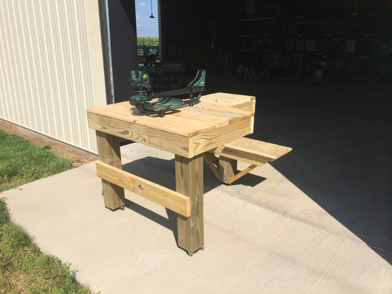

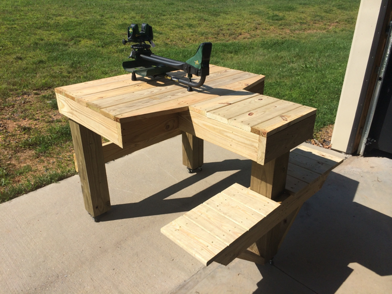

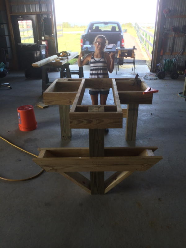

Here is my shooting bench project. I modified some simple plans I found on the internet. I made it 48" wide vs 36" and I made it three legged vs 5 legs.

Nice job, I found those plans as well. I like the changes that you made.
   / Shooting Bench #3
I agree, nice job! If you don't mind, can you post the plans so I can see the exact measurements.
   / Shooting Bench #5
Do you have a router?.. I would take my router and a roundover bit, and hit all of the edges with it. It would just take a few minutes, and it would make all of the surfaces your body would contact just that much more comfortable.:) Great build.
   / Shooting Bench #7
Nice work! Great call on 3 legs instead of 5. 3 legs dont' wobble.
   / Shooting Bench
I do plan on rounding the edges, I figured I'd use it a few times first. The three legs does stop the wobble, but when you sit on it or move your body position, it's not quite as stable as having the extra seat supports. I will need to move the bench as crops change, because that dictates my shooting angles.
