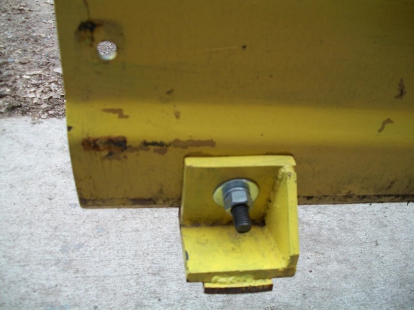

Those are on a Rhino blade and they were made by me. The part of the blade they are mounted is on a small angle so I figured that into the construction of the weldment. The brackets stay on all the time but install the shoe part when needed.
   / Shoes on a rear blade? #13
This is the set I made at one time. Shoe is level with the bottom of a new edge on the blade. Shoe has a 1/4" sacrificial ware plate on the bottom, thus raising the cutting edge 1/4" high.
Worked well.
