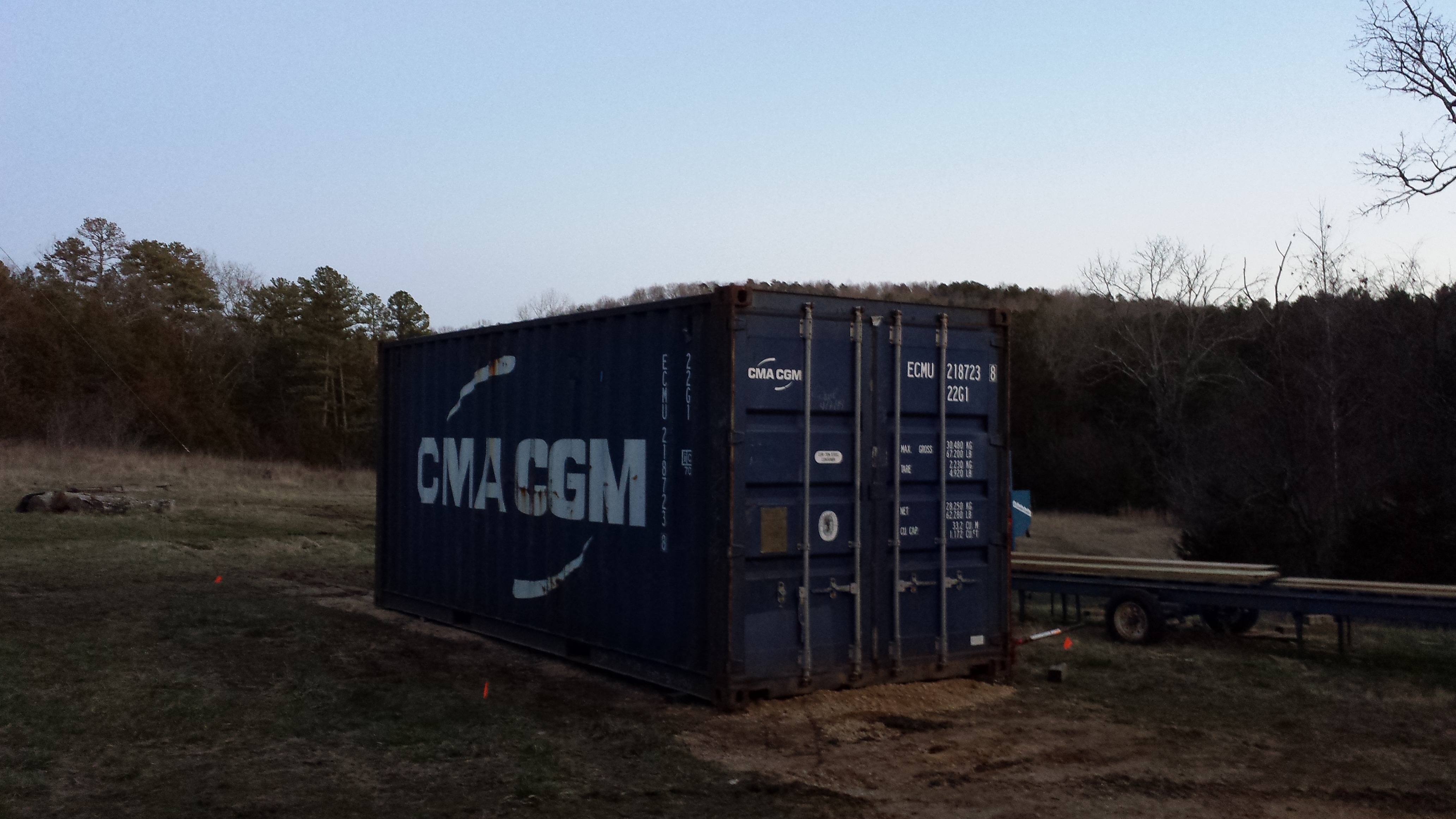

I had a 20' container delivered a week ago. Why not a 40'? There's a turn down the gravel road that is too tight for a 40' unit and it would be easier to move with my backhoe. The driver brought it on a tilt bed he uses for hauling cars. He got one end down and was trying to drive out when the upper end started to slide off to the side. I hooked the tractor up to it with a chain to pull it back.
I jacked it up onto some blocks of wood with the doors pointed a little downhill. I think I got the door end tweaked a little as it was hard to get them to latch no matter what I tried.

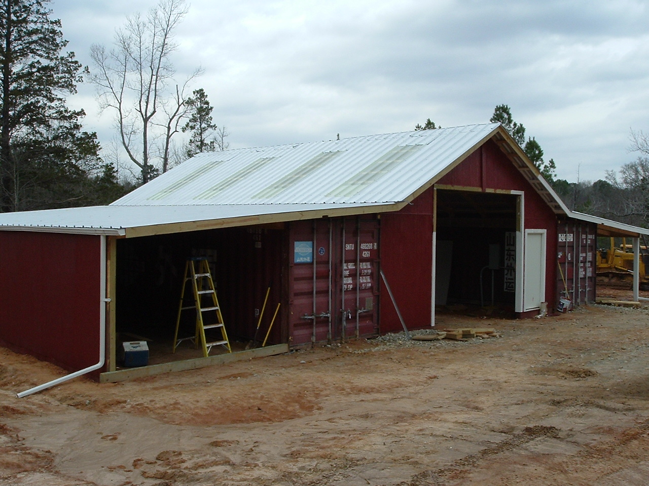

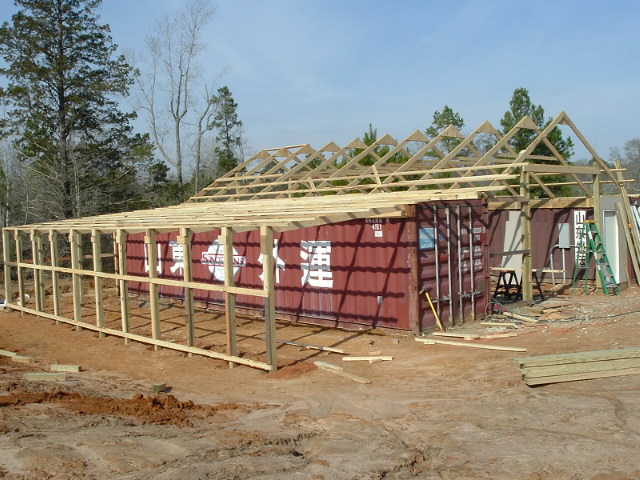

I did it back in 2003 when I bought my land and needed a fast, dry, secure place to store stuff. I put them 24 feet apart and built a roof over them. It worked out pretty good, but I wouldn't do it again. You lose a lot of space, and it makes it awkward dealing with the containers. They are expensive walls. But for what I needed at the time, they worked out.

Yesterday I worked on trying to square up doors and hit a half way happy spot but something is still dragging.

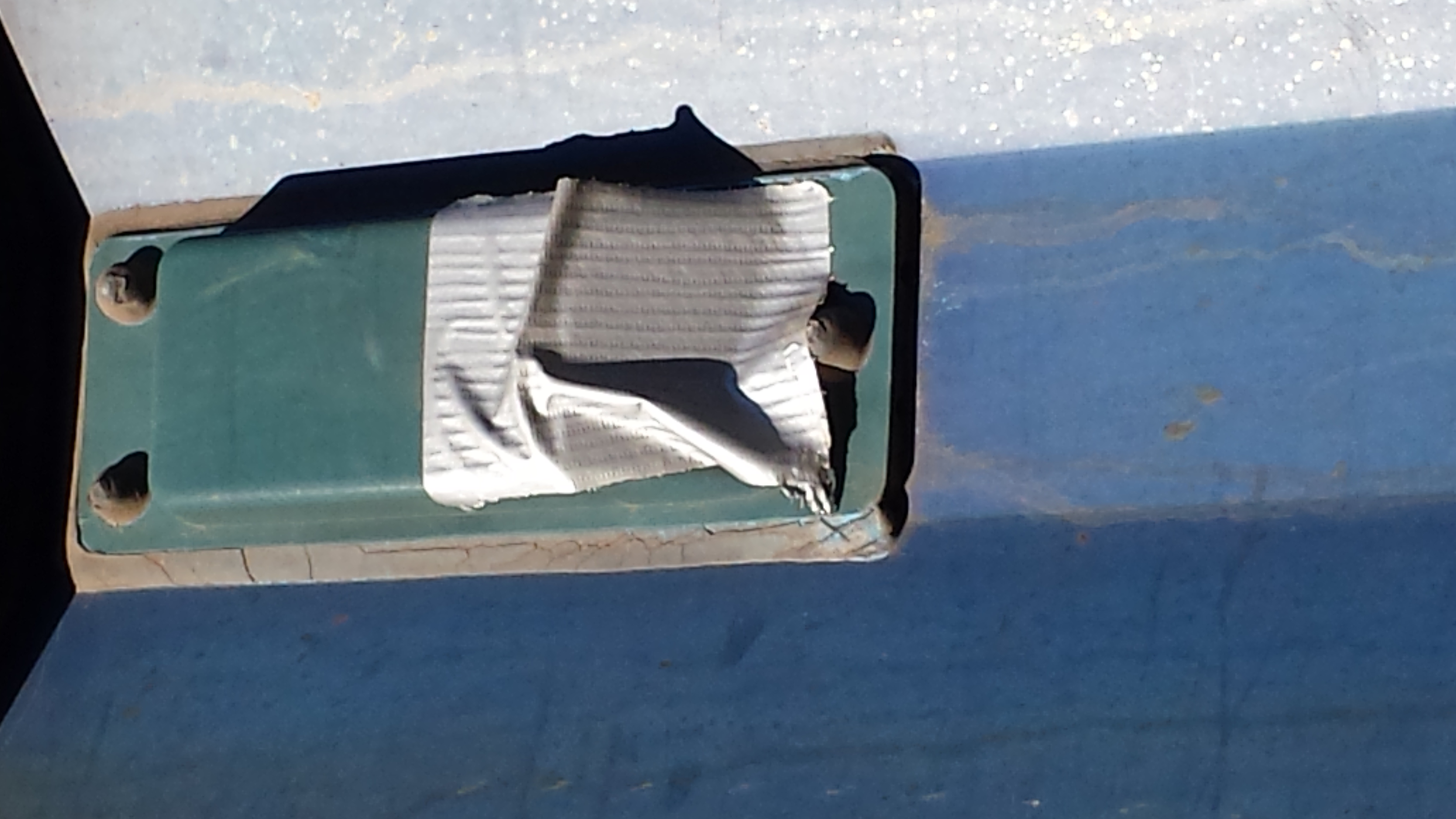

It was about 52 when I arrived at the property and felt like about 80 inside. I also found
a magnetic/sticky bar code ownership thingy and thought it might have a tracking chip inside but doesn't look like it to me.

Doors can be a B--ch, sometimes they're just screwed up and other times jacking one corner or another can help (and adding shims once you find out what helps)
The computer fan would probably help, unless you wanna actually WORK inside - I have a 20, 2 40's and 2 40 hi-cubes. I built a steel framed 24'x24' roof over the 20 - between the roof and a few trees, that one NEVER sees the sun. Any time of the day or nite, I can walk inside and it's the same temp as outside.
The 2 standard 40's are storage, some of which does NOT need extreme temp swings - the two hi-cubes will be welded together parallel to each other, with connecting areas between and a bridge crane in one side (the weld area) - other side will get tools and machine area. Eventually a 60' square shop will be built around those two.

The doors on my first container started dragging after I put my tractor in it the first time. The weight of the tractor caused the blocks to settle into the ground. Ten minutes with a floor jack and a couple of shims and no more issues until I had the container moved years later.
