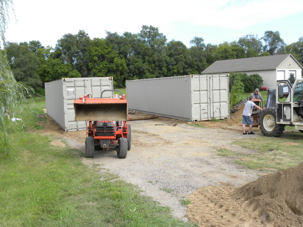

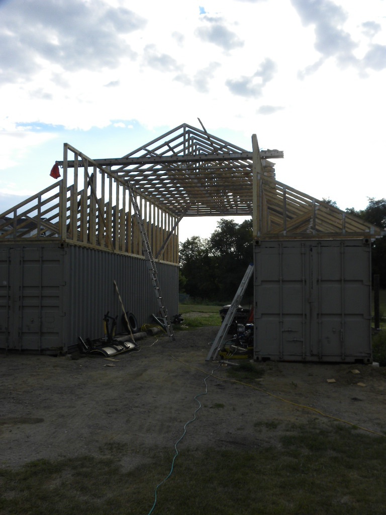

You can view the progress of my barn build here: Jim's Pole Barn Project.
We completed the barn about 7 years ago now. (Wow time flies) Since that time, the house you see in the pictures burnt, we lived in a house trailer in front of the barn for about 7 months while we built the new house. It was interesting going back looking at some of the pictures though.
We've been really pleased with the barn. It has held up well, no issues other than I lost a couple of shingles in the spring and I haven't replaced them yet - no leaks. I did dig the leftover shingles out a couple of weekends ago, so now that the weather is starting to break I can hopefully get the missing ones replaced. Some day, we still plan on insulating and finish the inside, but the money just hasn't been there. I have a heat pump for it, but no furnance to be installed in it. It was on the old house that burnt. It had just been replaced less than a year before the fire and wasn't hurt in the fire so instead of scrapping it I saved it. Guess I really need to be doing something with it.
Funny thing is, we used to store 3 vehicles and the tractor in this barn. After the fire I couldn't get any vehicles in it. I've finally have gotten it cleaned up and straightened back up enough that I can always get the truck in and if I do some rearranging I can get a second vehicle in. The car and Suburban are now parked in the garage attached to the house.
