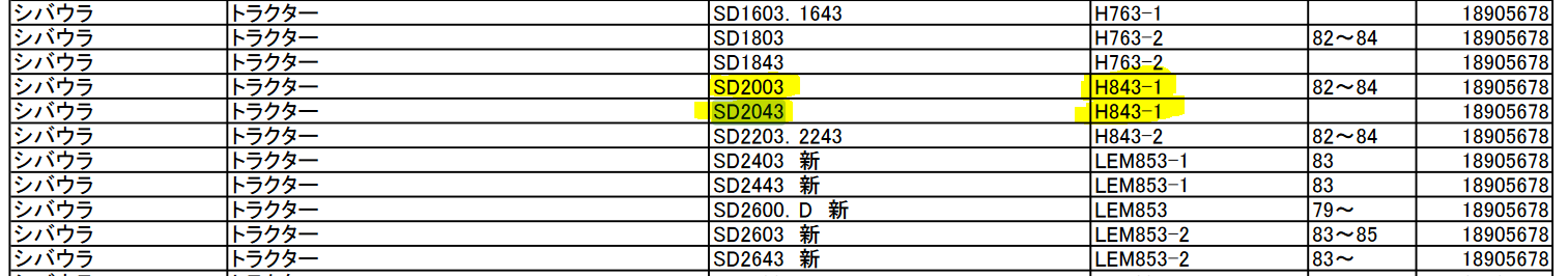

If you could post the engine ID, I might have a manual for it. I have 72 manuals in PDF from the old old old website from way back when.
Ok, in my records doc, your model has the same engine as the SD2003.

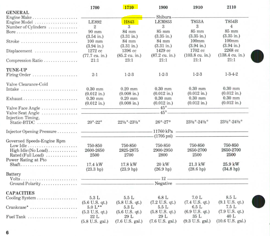

ah ha, the Ford 1710 has the same engine.
