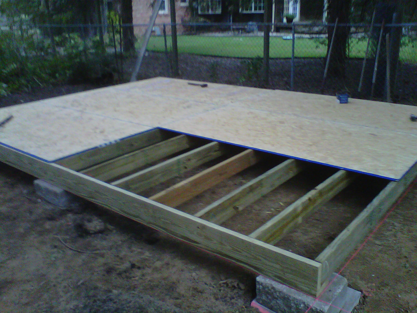

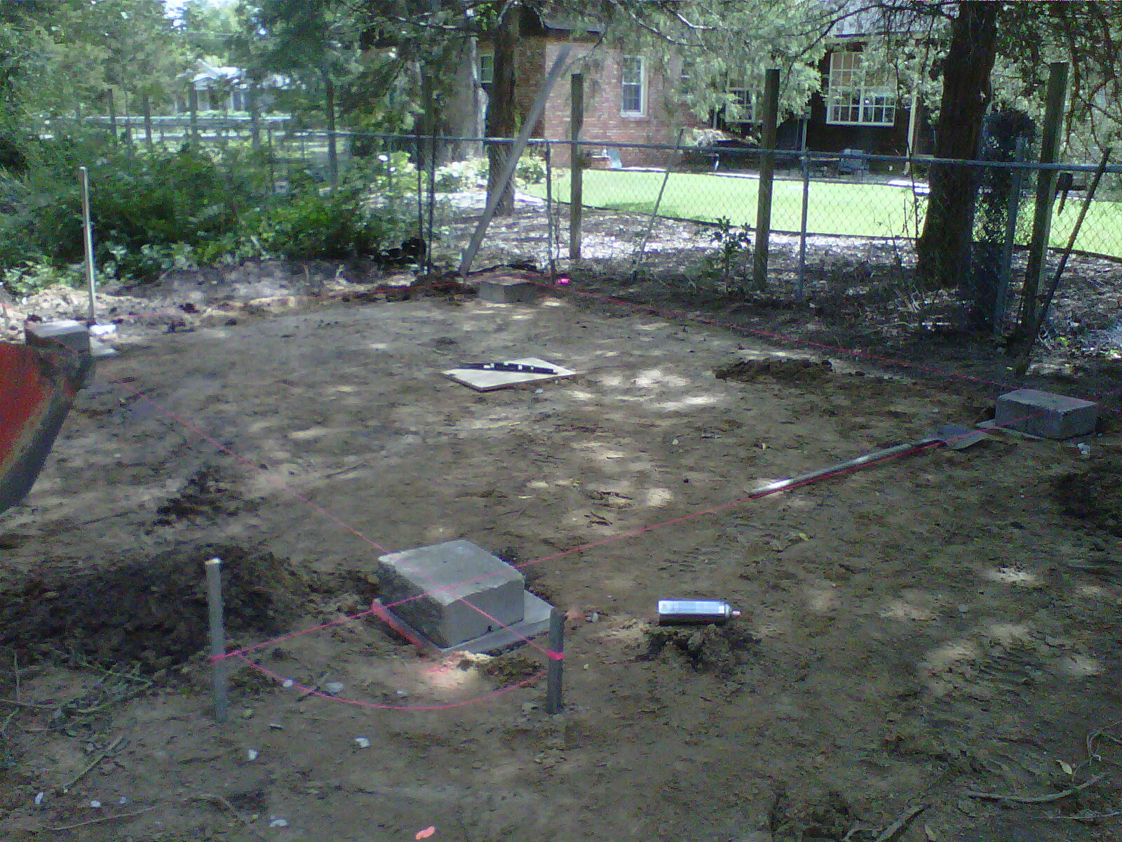

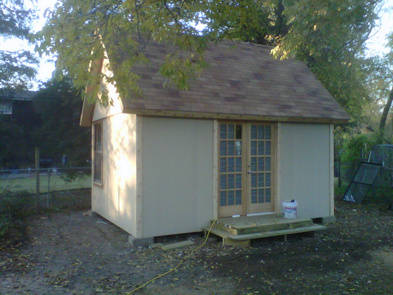

building a 12 x 16 right now, i got the cost down to 1600, i could buy it for 3000 around here but with hardly any loft room. I designed it myself after some intense research and book purchases. The peak of my roof is 6 foot up from the top plate so it will provide plenty of space and allow the 110+ summer heat to get away.
If you have a resale store in your area i suggest you look at it or even craigs list. i bought all my windows for 10 bucks each and 2, 15 light doors for 40 bucks each. when im done it will look like a little house. craigs list my also provide you with some low cost building supplies.
good luck

Looks good! What did you use for the floor? I was thinking of using 3/4 pressure treated plywood. Did you use any plans?

im probably going to regret it but i used toung and grove osb "chip board" while doing research i kept seeing homes built in many books using osb for sub floor. i am still trying to decide what to coat it with so it does not get ruined from traffic. i have considered everything from thompson's water seal to roll on bedliner paint. I should get plenty of air under the unit to maintain a dry climate down there. i used 2x6 pt floor joist, with a 2x6 pt mud sill. the outside will be covered with hardi siding in 4x8 sheets, they are $1 more than the plywood they imitate and well worth it in my mind.
No plans other than the ones i drew up, i used a couple books one book for "home framing" and one book for "shed building".
i went to lowe's, home depot, southerlands, and 2 independent lumber dealers, i found everyone was only pennies different on cost but quality was all over the place. i left one place and went to another due to unable to find good 2x6x10's.
i also found shingles were cheeper than corigated steel for the roof.
   / Shed/Shop Building #8
Depending on what you do out there, the OSB may hold up for a while. I would prime it on both sides before installation with a good wood primer and then finish it with a porch floor/deck paint. It's pretty rugged.
   / Shed/Shop Building #9
I used it on my shop floor.I painted it with floor paint. Applied it with a roller on a broom handle!It worked great.An has held up really well.
Army grunt
   / Shed/Shop Building #10
it depends if it is in fact OSB or Advantec, Advantec has a 50yr warranty as long as it doesn't stay wet. OSB will likely crumble in a couple of years if it gets any moisture. A good quality floor paint should preserve it (on both sides)
