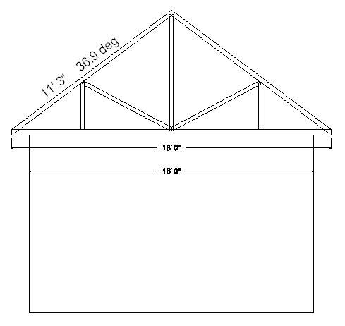

I am planning on building the long awaited shed. I plan to use it to house my GT235, snowblower, tiller, push mowever and other yard stuff. I would like to make it 16' x 16' with a 9/12 pitch roof. I choose the size based upon what I think I need as well as precut wood dimensions. I plan on making the floor from 2x6 pressure treated (16" OC) set concrete blacks and gravel.
I was just at Lowes and 3/4" pressure treated plywood is $36 a sheet. Is it necessary to use that, or would regular tongue and grove due ($15 sheet). I could always coat it with a outdoor latex paint.
My biggest question is regarding the roof trusses. I would like them to overhang about 1 foot of the sides. What is the best/easiest way to put these together (using gussets, bird toed, etc.)?? Also, what size board would I use to span 16'??
   / Shed Help Needed #2
I'm not a truss engineer but around this neck of the woods they would be using 2x4s.
Check out this site for more info.
http://www.alpeng.com/upload/19268/RoofSpan.pdf
Here is a rough scale drawing of just one 9/12 pitch design that I interpret you expect.

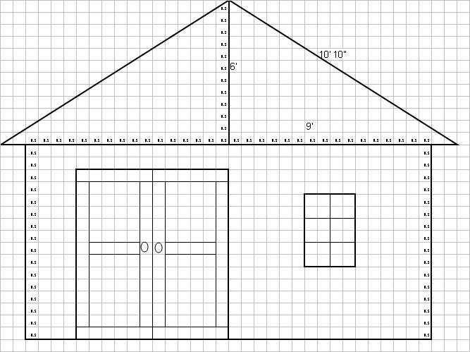

Thanks for the drawing. I should have said an 8/12 pitch.
I guess the main question here is: Can I simply use a larger cross beam instead of all the cross bracing. I was hoping to use the some loft space for storage.
   / Shed Help Needed
Here is what I was think of.
   / Shed Help Needed #5
If you want a loft, build it with "rafters" not a "truss". Your local building code should tell you min size for wind/snow loads. The center support does nothing unless you have a load bearing wall beneath it.

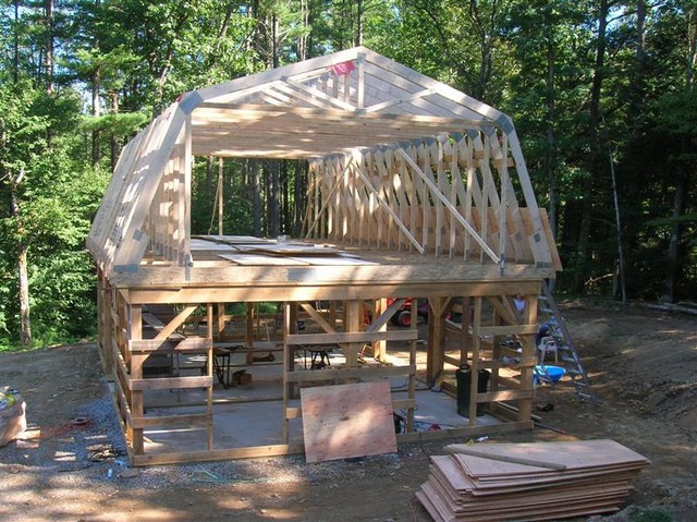

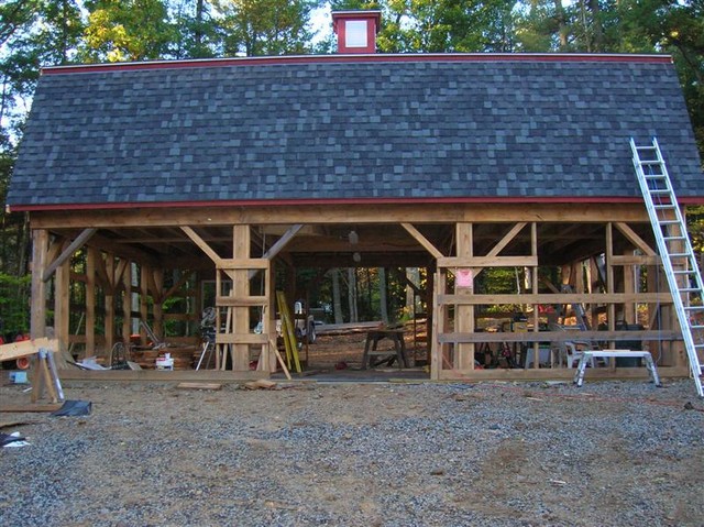

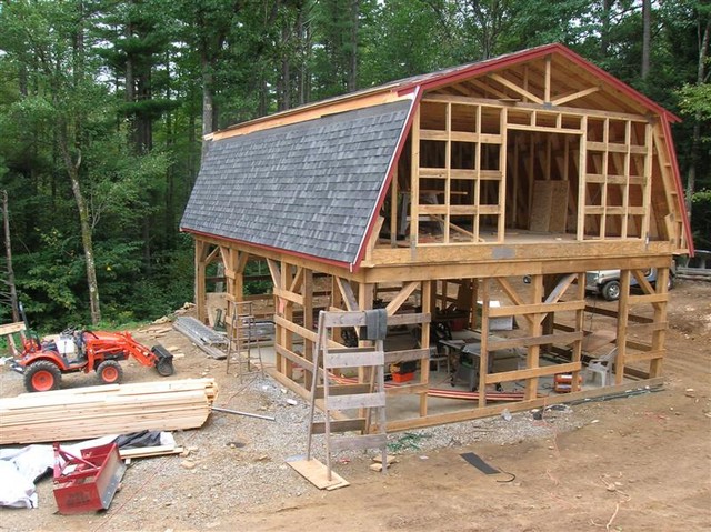

You should use pressure treated lumber for the floor joist, but regular tongue and groove flooring would be fine.
When I did my barn I went to the local (real) lumberyard and ordered trusses. They had a guy there that (with the computer) was able to calculate all the loads and specs. He was familiar with the local code and snow loads. I believe that the truss was as cheap as I could have bought the material alone for.
My Barn is 24 x 36 with an 18 x 36 second floor.

Hey bearhawk, very nice barn. Has the project been completed yet? If you don't I was curious what you paid for the barn? What are your plans for the second floor? I am looking sometime in the future to build a garage/ workshop about the same size in dimensions. I to live up here in nh and in need of another garage. I have a 24 x 28 garage already but the two trucks and some lawn and snowthrowing euip. pretty much takes up all that space. I have a 12 x 16 shed in the back and have my tractor and loader in there but I think I am pushing the design limits of the floor just alittle. Any way, very nice looking barn. Your town is going to love increasing your property tax. LOL. Russ
