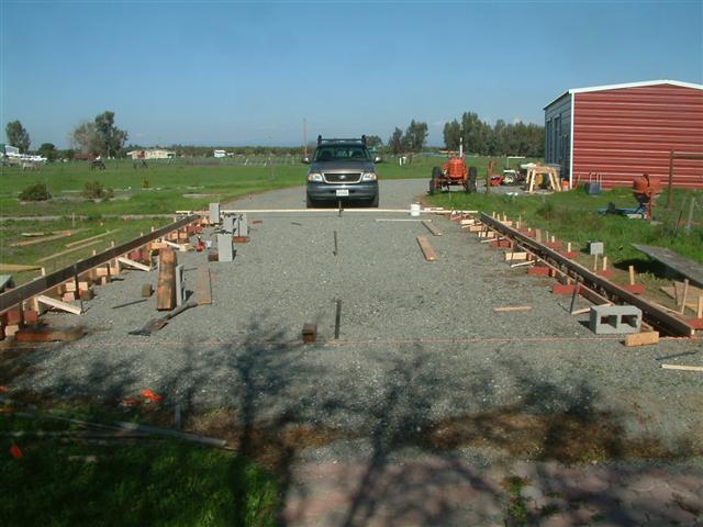

For a slab, it's the bottom of the perimeter footing (usually 12" wide) that needs to be below the frost line, which in MA is probably pretty deep (36-48"). Here in the North Sacramento Valley, the requirement is 12" deep since the ground never freezes so there's no heaving problem.
So the perimeter for your 16x20 ft shed is 72 ft, which is a lot of digging if you want to use the traditional slab footing arrangement.
I know all about that since I've just finished hand digging two 12"W x 18"D x 36 ft long footings for a 20x36ft metal carport that I'm having installed.
I hand-dug those trenches because I didn't want that nice gravel driveway messed up by a backhoe or skid steer excavator. I'll install rebar tomorrow, call for an inspection (hopefully on Tues) and pour concrete Wed or Thurs weather permitting.
The sonotubes look attractive to me. I assume they're 12" dia. Your problem is drilling 3-4 ft deep holes. That can be challenging even with stout equipment if the ground is rocky (I mean large New England rocks, not just gravel). My neighbor hit hardpan about 30" down while trying to drill 12" dia x 42" deep holes for a cattle gate. He was using a Bobcat with a hydraulic PHD and struggled to get through that layer.
Another possible option is to design a portable shed, one that is supported on horizontal 6"x6" pressure treated beams. That way you only have to dig shallow trenches (maybe 6" deep) and fill them with gravel to provide some drainage under the PT beams. You need to check with your county building department to see if this type of construction is allowed.
