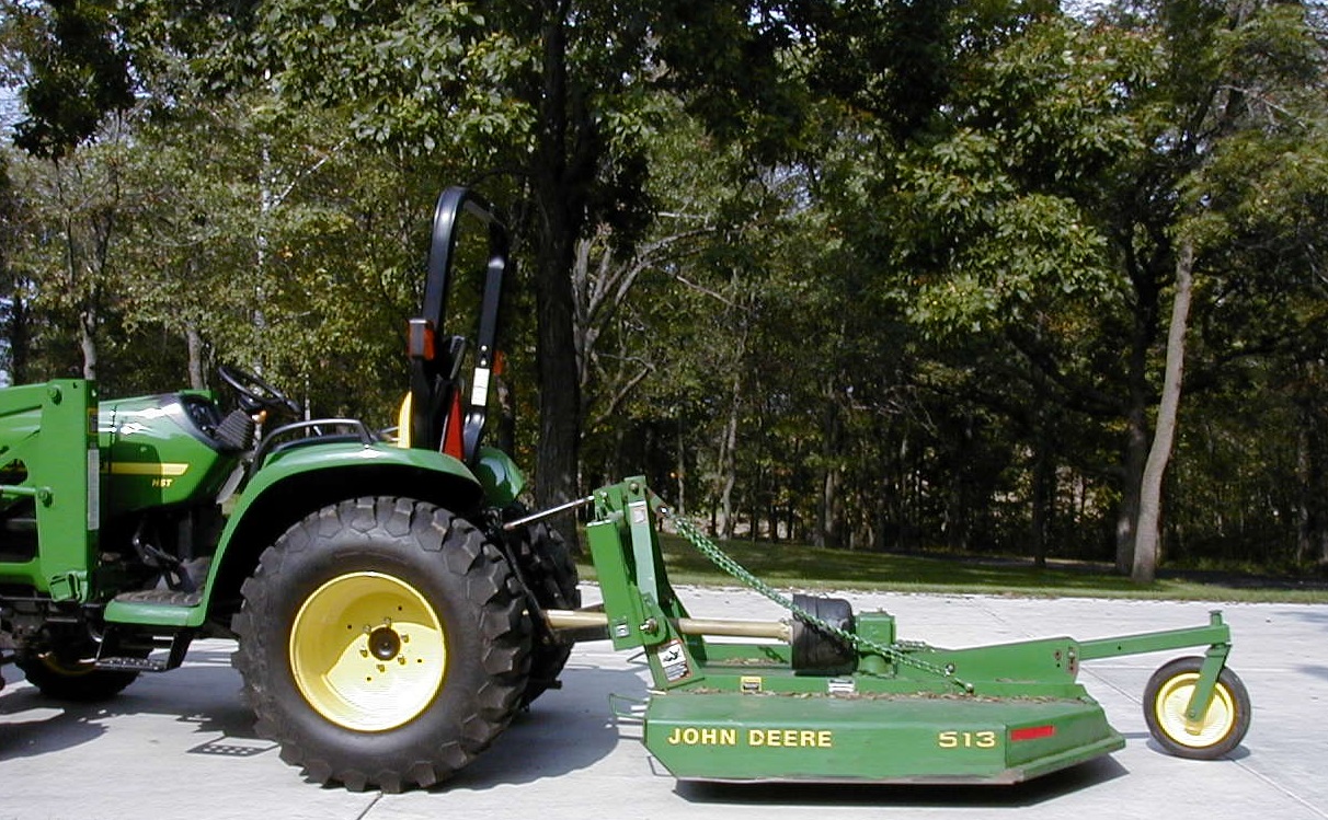

Also, I've reinforced the rotary cutter deck with 1" square tubing as it was taking a beating when backing into brush. As well, I replaced the 1" straps with chains to carry the rear of the cutter. The straps get bent up when the rear wheel of the cutter raises and the straps go into compression.
