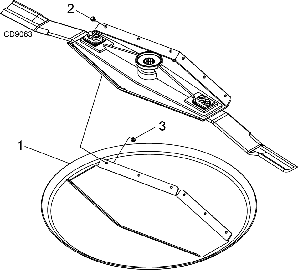

   / Sharpening the blades #46
Nope not the cheapest. It is a Woods Brush Bull 72 with the Stump Jumper. The stump jumper is a very-very heavy duty circular disk that the blades attach to.
All three of my cutters have stump jumpers. Anyway, does it look like this?
If so, the blades are NOT held on by the stump jumper...
The Woods Brush Bull 72 IS their cheaper cutter...
Lets see a pict. of yours...
SR
If so, it is NOT hooked to the stump jumper...
SR
That is a stump jumper your blades are attached to. Be prepared for a battle if you ever have to remove the stump jumper. I see you also have the debris chains on your unit.
   / Sharpening the blades #48
NO they are NOT just attached to the stump jumper, the jumper is attached to what the blades are attached to!!
SR

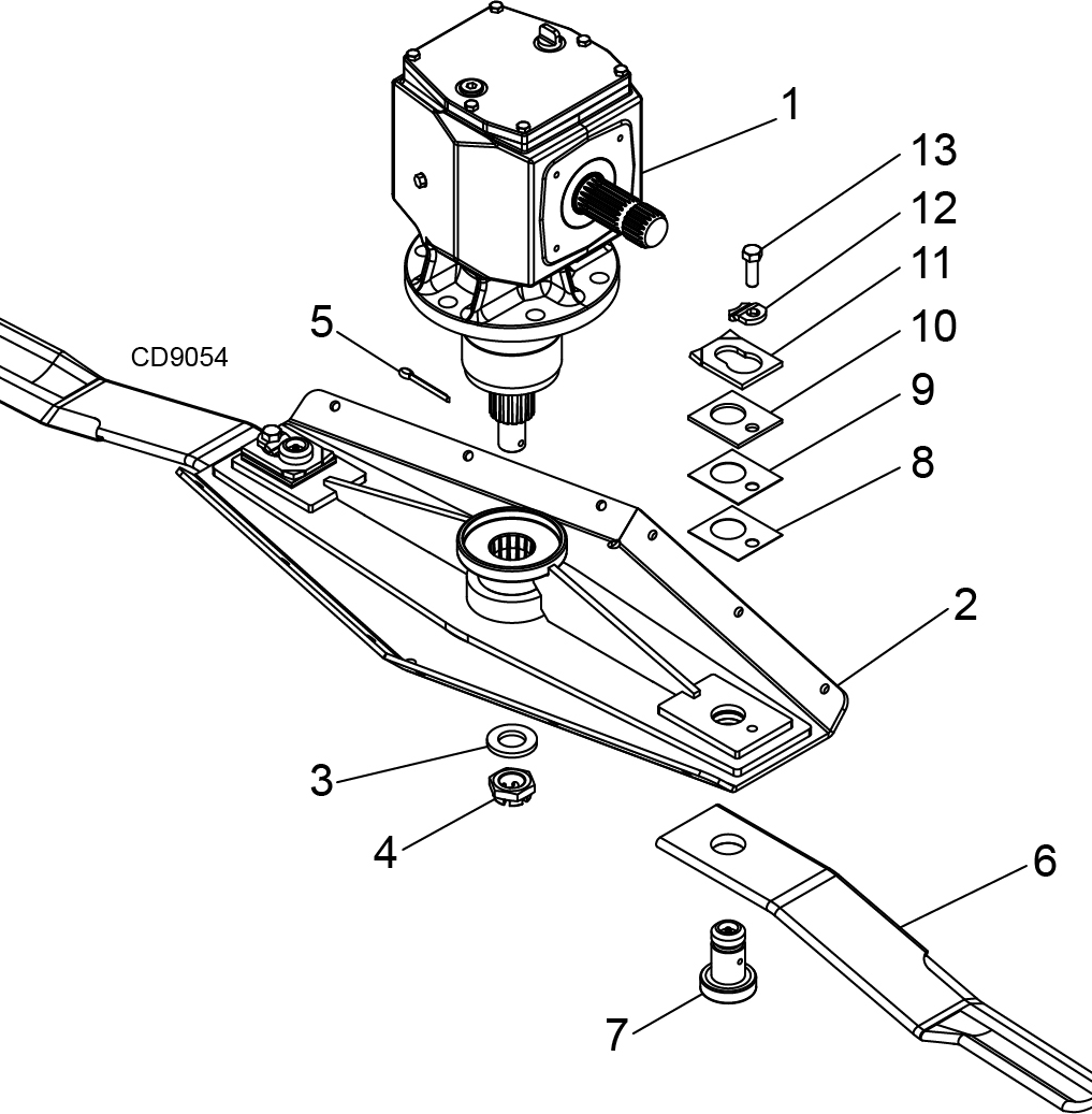

OK, I'm going to try this one last time, look at this pict. of one of my Woods Rotary cutters,
I torched the stump jumper off, does it look to you like the blades were held on by the stump jumper??? Take two looks before you answer. lol
NOW, look at the pict. Willy posted earlier,
Look at numbers 7, 8, 9, 10, 11, 12, and 13! Does it STILL look like the blades on the more expensive Woods cutters are held on by a large pin/bolt with a big nut that requires huge torque to get on or off?? This is how my "upper end" Woods cutters have the blades held on, it has NOTHING to do with the age of the cutters!
I'm not driving down to hillbillyville to show you, so if you don't get it now, with the above picts., you are a lost cause! lol and I give up!
SR
SR
By the picture(s) you again have provide, What you did is torch the stump jumper off, leaving the heavy duty steel attachment bar that was attached to the top - back of the stump jumper. The heavy duty bar is also what contains the splined connector to the gear box shaft protruding downward thru the deck. What you have created by your action is create a catastrophic Rotary Cutter gear box or tractor PTO drive line failure from shock stress if the bar your blades are attached to ever hits a stump or rocks and stops suddenly with the tractor running at PTO speed. Trust me the damage will not be taken care of under warranty nor be the fault of the Rotary Cutter or tractor.
The Woods Brush Bull which I have is considered Woods Premium Rotary Cutter. So if you disagree with that labeling by Woods and consider the Rotary cheap, my suggestion is for you to tell Woods that not me.
Woods latest version of the Woods Brush hog contains pin removal for the blades.
  • "Greasable Quick-change blade pins are easy to maintain and remove from top of the deck through large blade access window
  • High-strength steel bumper with a Z-channel frame for added durability when backing over tough brush"
With the modifications you have made, I would not recommend backing or driving over tough brush.
I personally don't think you should be driving. Your pictures, the modifications you have made and saying that is standard on "HIGH DOLLAR ROTARY CUTTERS " do not match or coincide with facts.
Your modifications to what was already a dangerous piece of equipment when in use is a very good example of why we should never be around or near when someone is operating a Rotary Cutter or Flail Mower.

ROUND STUMP JUMPER ASSEMBLY (OPTIONAL)
REF
PART
QTY
1 610124 1 Round stump jumper kit - BB60.60
1 603839 1 Round stump jumper kit - BB72.60 / BB84.60
2 62153 12
3 14350* 12
40 Parts
willy
