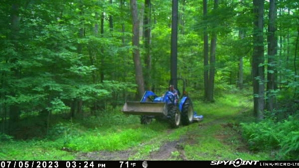

What are your thoughts on sharpening your brush hog blades. My property grows almost as many rocks as it does brush and grass. My blades over the past few years have taken a beating and I have to grind out some of the larger "nicks". In the past I took the blades off to do that and I have also left them on. Both ways have advantages and disadvantages. How do you sharpen yours?
