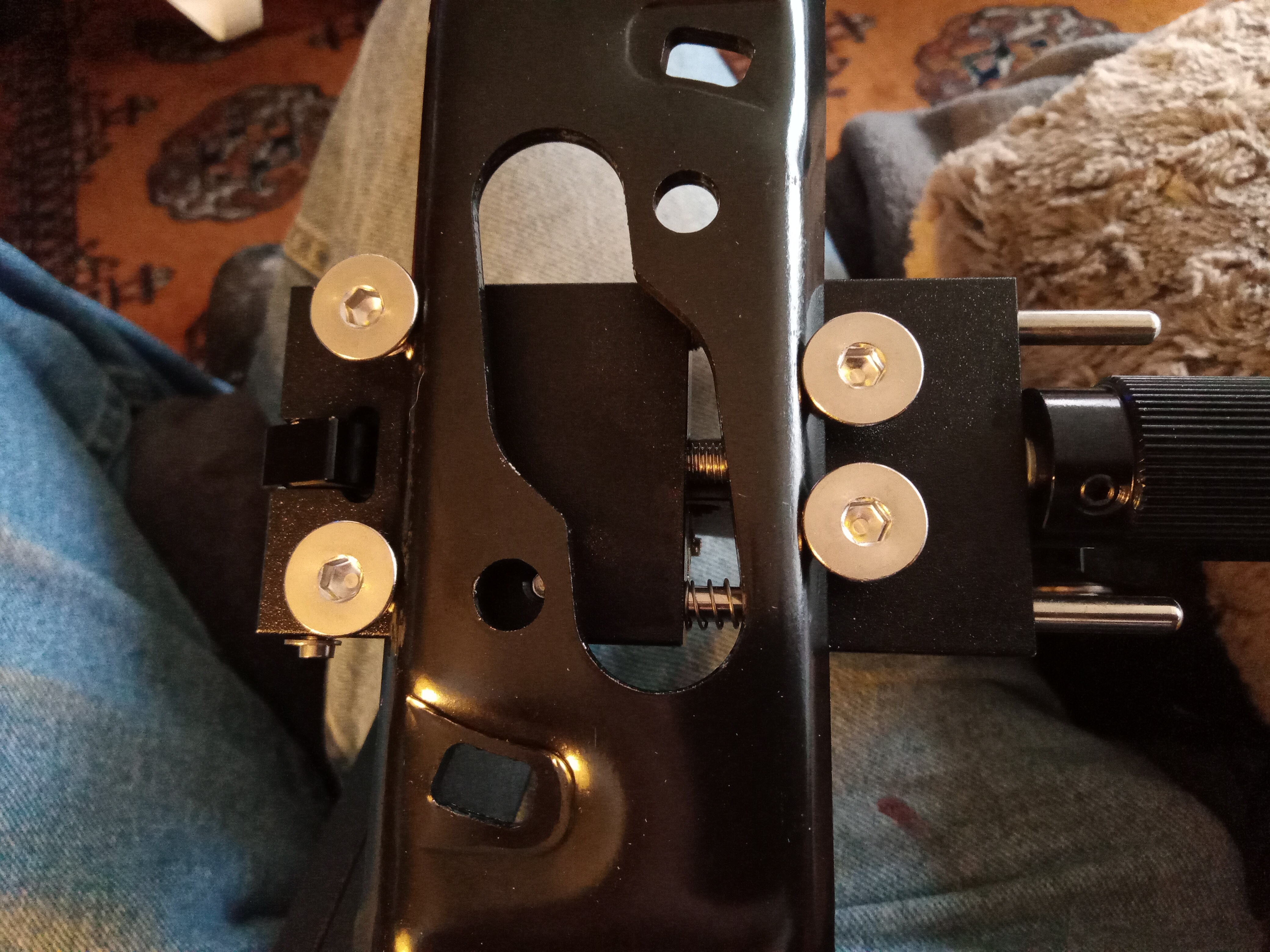

Good day everyone. I recently purchased a XT2GX54D with a fabricated deck and the fastattatch blade system.
My research indicated the fastattatch blades required dealership balancing or a special insert to balance if one is sharpening at home.
I finally purchased a sharpening and balancing kit that would accept the typical star/round blade mounting holes but I was concerned about my new Fastattatch blades. I am happy to report it also works on my fastattatch blade system.
I have successfully tried fastening the Fastattatch blades to the sharpening tool platform.
FYI- My balancing standards appear better than these factory blades as they are not equal in weight and the blades are off balance according to this balancing device.

The Cub Fast Attach is a new proprietory more S shaped hole. As illustrated in the OP post fitting into the sharpening jig toward the bottom of his post. Currently no aftermarket versions exist due to patent issues. Stens had to stop selling them because of this issue recently.
