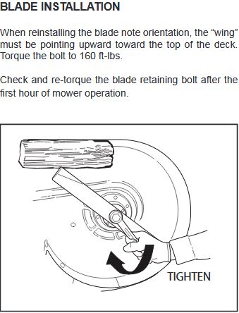

This may not be your exact mower but it may be close enough for government work.

You can sleep well. Just found a manual online for RCK60 and mower blade screw torque is 72.3-86.8ft/lbs. Guess I shouldn't believe everything I read on the interwebs.

My Kubota 54" MMM deck has a torque spec of 75 ft lbs. Plus I use anti seize on the bolt threads. I've not had to use anything but a 16" 1/2 drive breaker bar to get them off.
If I were you, I'd double check that torque spec again.
