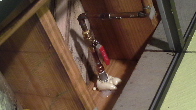

I know this an old thread BUT
Just finished a repair of a split pipe in the ceiling.
Wanted to put in an inside shutoff.
Without push on fittings it would have been a "call the plumber" for a solder job.
With sharkbite it was basically cut, deburr, polish, push, test and foam.
About a 15 minute process which I managed to spread over hours.
(Where's the [pipe cutter, teflon tape, pipe wrench, etc.]).
/edit Just knowing I can cut and cap a pipe anyplace I can reach a mini-pipe cutter WITHOUT SOLDERING is well worth the cost of a fitting.

I agree - If I'm paying a plumber $100 for a visit and $100 for the first hour, plus materials, for a 10 or 15 minute job like I had I would want the thing soldered. Instead I payed $17 for a piece which will remain visible (it's a shutoff valve).
I can readily see why a lot of plumbers advise against push on fittings. With a simple cutting tools, something to clean and deburr the ends, a lot of plumbing emergency calls could be averted. And then the homeowner can sit down and watch a lot of youtube and practice soldering so he can do it "CORRECTLY".
