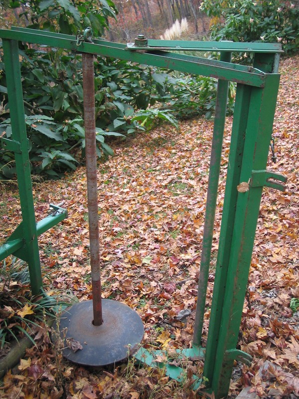

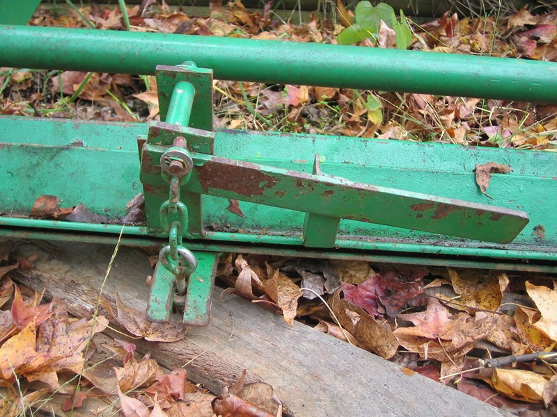

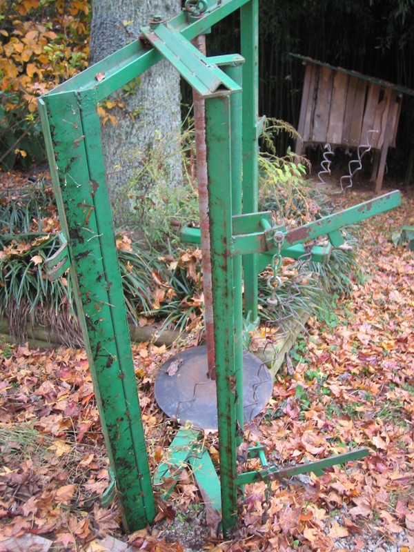

A guy loaned this stretcher to my brother. The design looked so good I took some pics and may make one.
