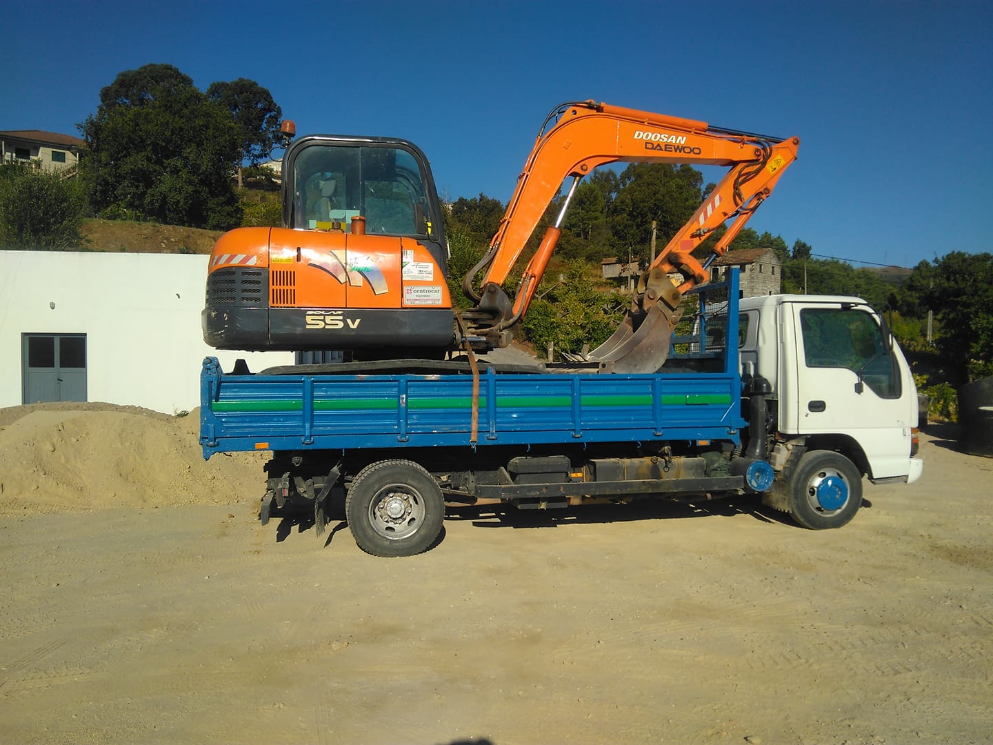

How about this. Overweight, about 2 inches from being over-height and looks like it is tied down really nicely (not).
They should have backed it closer to the cab, blade towards back, cab spun around and and curled the arm and bucket more to get more clearance. My boss did this with the 2017 F-750 hook truck he got. Hauled either the John Deere mini excavator or the Cat 277D crawler skid steer. Granted it is like 2 times the truck this thing is.

Oh yeah, definitely. It should be loaded with the tracks closer to the cab and the boom to the back. Well, it should be loaded in a proper truck in the first place.
I would imagine that truck being perfectly legal for that exact purpose in many countries.

The center of the tracks are past the rear axle and assuming the front tire is at proper inflation it’s setting pretty heavy. The front end of that truck wouldn’t take loading it backward. I’d agree with it’s probably legal in other countries.

They could have left the bucket down on the road, behind the truck, that would have taken some of the load off.

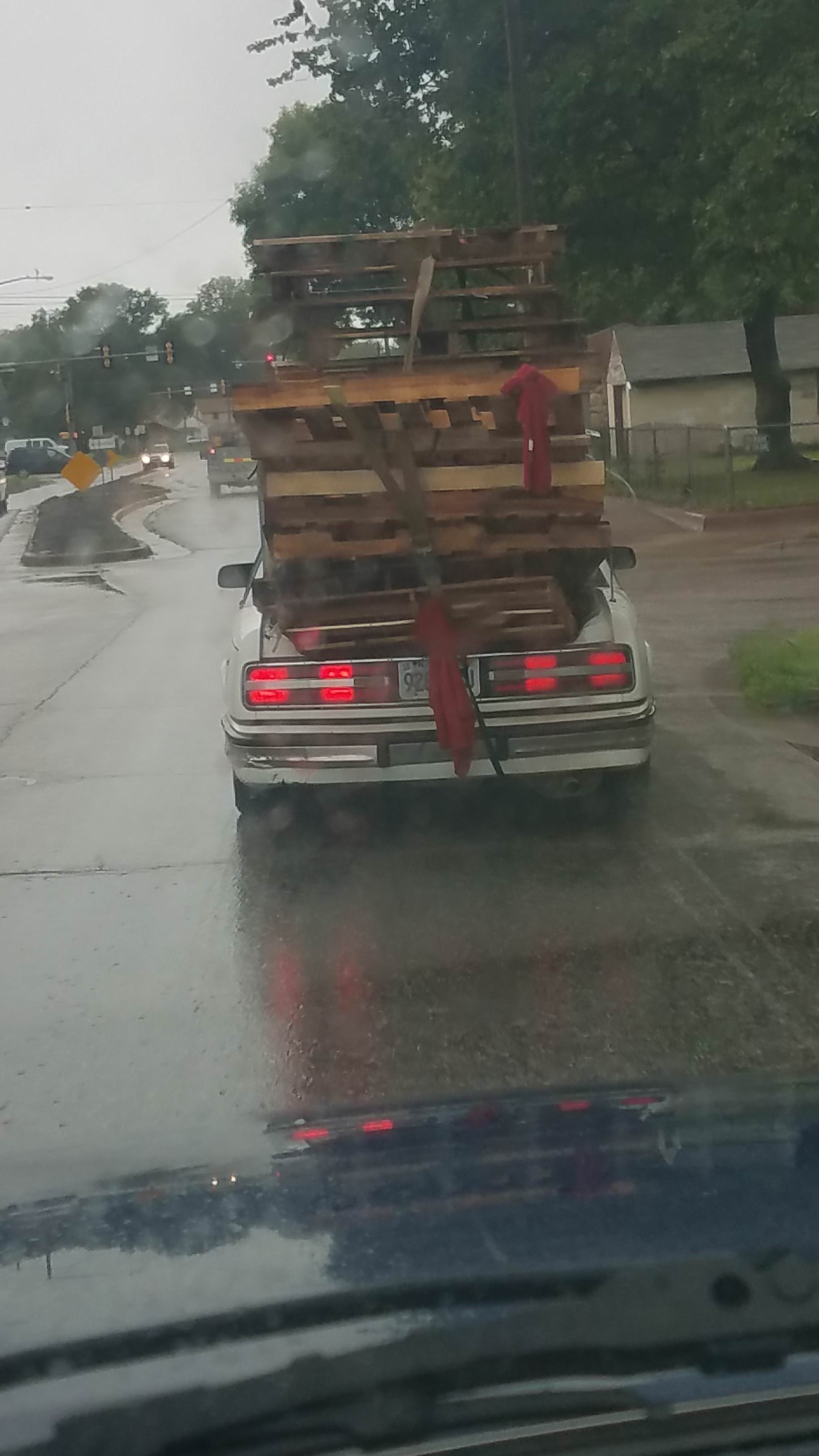

Lets see.. Straps? Yep. Flags? Yep. Good to go!

Must have really wanted those old pallets......

I couldn't haul that many pallets in my Ford Ranger.
I could, if I stood them on end and stacked from front to back like Oreos. Two ropes from front to back and we're good to go.
