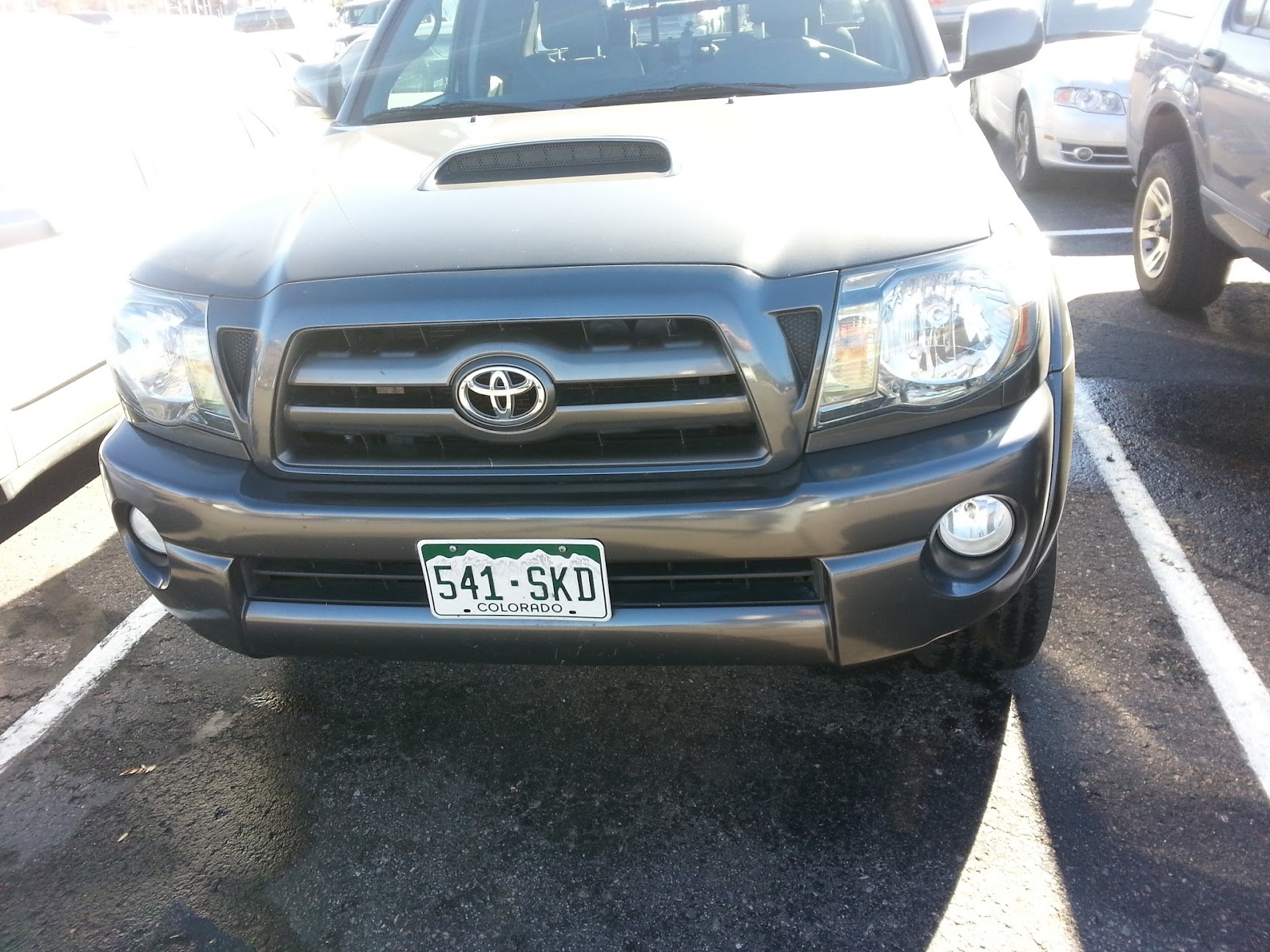

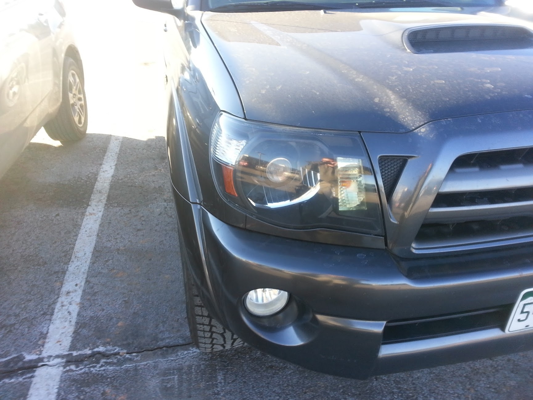

I put a kit from The Retrofit Source | The Best Brands in Automotive Lighting in my 2009 Tacoma a couple years after getting it. back in the day they were allegedly the best source for HID stuff. Worked pretty well, but had to replace the controller board once (under warranty I believe) & one of the connections is occasionally flakey. Sold the truck a few years ago, but still work with the new owner. They had a pile of different kits at various price & quality levels. I think these days there are a lot of aftermarket housings for HID bubs. Lots of them are cheap & don't even have proper projectors. HID requires really high voltages, so they have a ballast between the 12v & bulb, just like a fluorescent light.
Putting HID bubs in a halogen housing is a recipe for glare & blinding other drivers. HID bulbs produce light in the whole bulb where halogens have the element in the center. That means you need to focus things differently with a different reflector (or even better a projector).
  1. Remove the headlight assembly
  2. Wait until you wife is out of the house when she'll yell at you for misusing her oven
  3. Put it in the oven at 300 degrees or something for a few minutes to soften up the butyl rubber holding the clear plastic on
  4. Pull the front off
  5. Cut a hole in the back with a Dremel
  6. Roughly align the projector
  7. Bolt & glue the projector assembly into the back of the headlight assembly
  8. Seal up the back of the assembly with RTV or something
  9. Put the front back on (don't remember if I did the oven thing)
  10. Mount up the controller & wiring
  11. Make sure things work
  12. Align the headlights
Aligning the cutoff on the projectors when they are on low beams was kind of tedious & I never felt super happy with my results. Mostly due to parallax & the dogleg for the cutoff on the right side of the road when in low beams rarely lining up depending on the distance.
Not sure if I'd go through the effort again. Well, given I haven't with my 2014 F350 I picked up pre-COVID I probably won't. Results were cool, but not quite OEM reliable. And after going down that path I always worried about my headlight alignment & blinding drivers a bit to much.

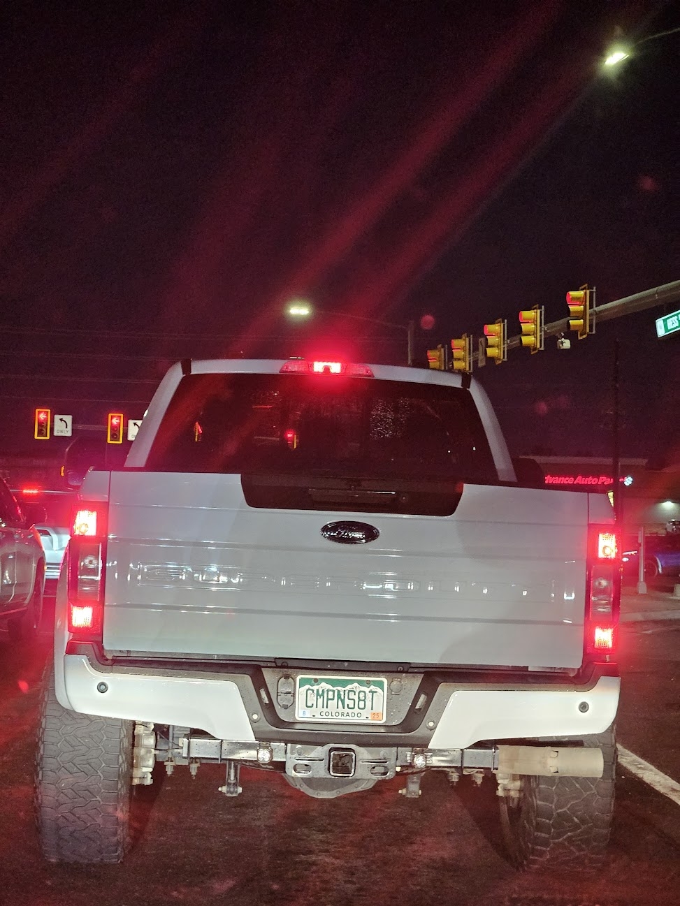

Back to hauling something wrong... Somebody using a big truck to apparently haul a very small package a week or 2 ago. Looking at the photo, the truck looks lopsided, but I think that's just my camera work.
You should clock the projectors correctly before resealing the housing.
Then again, I had three sets of $1,600 headlights that had at least one projector each clocked wrong. That's when I decided to try a retrofit myself.
