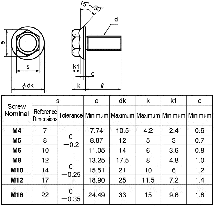

Hey Renze, do those evil 12 mm heads and nuts exist in Europe?
My metric tool sets from there have 12 mm wrenches and sockets, but here a metric set didn't use to include that size. And I don't recall ever needing them over there.
Automobile manufacturers, applying "lean six sigma" sh it, meaning they only give the worker on the assembly line the only tool they need for their single task, would probably use flanged head nuts and bolts, with a smaller head as per standard.
Thats why i hate working on cars, i always end up crawling under the car with a fistfull of wrenches when an M10 is just supposed to be 17mm.
Farm or construction equipment is easier, no weird standard flanged nuts, just plain old DIN fasteners with a washer if required.
Deutz started using Torx headbolts on the BFM2011 engines. Thats why they are supposed to go in automobiles, not in heavy equipment if you ask me.
   / Share Pics of People Hauling or Towing Something Wrong #21,384
Pretty much anything Korean or Japanese made will use 12 mm for a M8 bolt, which "normally" uses a 13 mm. They also use 14 mm wrench for a M10 bolt which normally uses a 17 mm wrench.
Thats the standard for flanged bolts. I usually replace them with regular bolts and a washer because i hate them.
I use DIN 931 (shafted bolts), 933 (fully threaded bolts) 934 nuts and 125A washers, thats what even the home improvement markets sell, so automobile manufacturers should stick to it as well.
