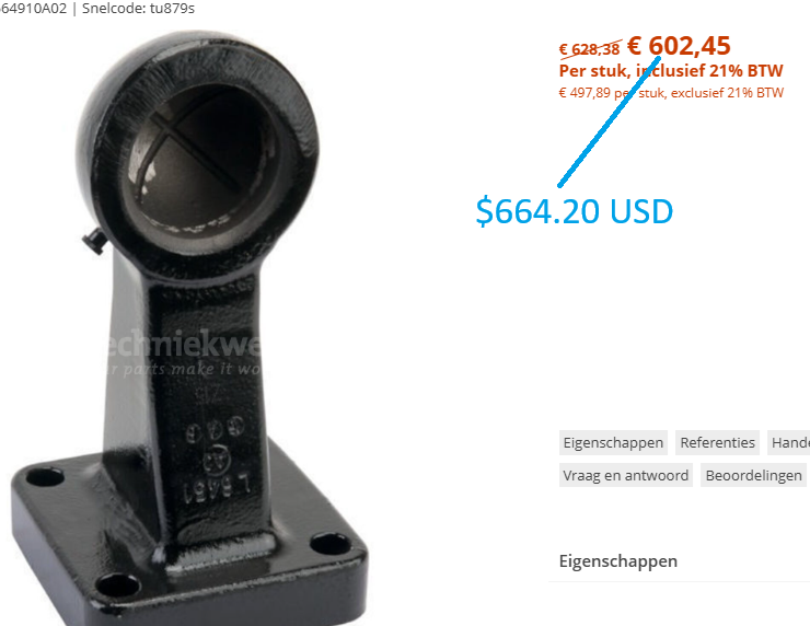

It's not a $1000 ball hitch.
Sorry... $664.
Here's what he posted:
A good quality ball coupler is only about €60 to €70. Comes with wear indicator, auto latch and latch indicator.
That's much more reasonable.
   / Share Pics of People Hauling or Towing Something Wrong #20,873
it's also not a ball hitch per se; it's the "spoon" for a "ball and spoon coupling"
still seems pricey tho lol
Yep. I know it's not a "ball hitch", but being of similar size and complexity, and not knowing the proper name for the thing... the name of the widget really wasn't my primary point.
I've been working in, around, and for European employers and customers for most of my career. I've watched them slowly but surely regulate themselves out of business, as their regulatory costs have just climbed way beyond what sales into Europe can ever support, at least for manufacturing and test equipment.
Put otherwise, what do you think that rather simple hunk of forged steel would cost, if it were sold at Tractor Supply Company at any store in Ohio or New Jersey, and sold at the same volume as our typical trailering components? :D I'd guess $35, not $635.

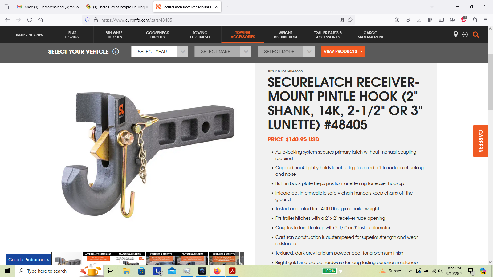

I have a couple of pintle (or to keep some people happy lunette ring) hook trailers and a couple of different hitchs for them;
this is my favorite one,
Its not really comparable to a Tractor Supply, made in China, sold as USA product. Tractor supply has nothing that even comes close in capacity because in North America the standard tractor hitches cant take these loads. With North American scraper pans or grain carts, manufacturers often machine their own custom hitches to take these loads.
Thats what these K80 balls are comparable to: at least we have an industry standard in this capacity class...
My mate runs these on his manure tank, 24 ton total, up to 6 ton drawbar load. Machined, hardened, lasts a lifetime. Also his new selfloading silage trailer, with forced steering, benefits from having a connection without slop.
I never liked them. The UK and Scandinavia have pickup hitches with the same dimensions as standard on their tractors, once set by Harry Ferguson. But when you use them dry they wear, and when you grease them they attract dust and wear. We used to have them but when silage trailers grew too big to hook behind the forage harvester when opening up a new field of corn (harvesters couldnt take that drawbar load anymore) the local contractor swapped them all out for fixed drawbars with hardened inserts in the 90s because every trailer lost in traffic due to a worn out hitch is one too many.
It may work on occasional use light duty stuff, but not in a custom harvesting outfit with 4 ton vertical load and a 24 ton trailer. Then, contact pressure is too big with these hitches.
