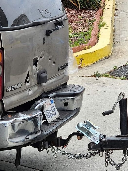

What was going on with this and what was the need or intent? There already is a coupler on the black trailer so why the silver coupler add on? Did he twist the safety chains on purpose?
In any event, that must have been a harrowing 60 seconds when the thing thrashed itself to a stop while doing $4,000 (?) damage to the vehicle.

Okay, just guessing here:
He probably had a 2" ball mounted, but trailer coupler was 1-7/8". So instead of buying a new ball, he bought that coupler and bolted it to the trailer.
Yes, to shorten them. Usually done to keep them from dragging on the ground, but here just out of poor judgement.
Probably correct. What I want to know is who the heck decided that there was a significant difference between a 1-7/8" ball and a 2" ball and made each a standard. 2-5/16" makes a little more sense as a different standard. If I was the decider, everything in the light towing world would be 2-5/16".
I think it's more likely that the coupler was larger than the ball.
That could very well be a 2-5/16 coupler. And if they didn't have the correct tools, changing the ball instead was ruled out in favor of a destined to fail coupler change.
