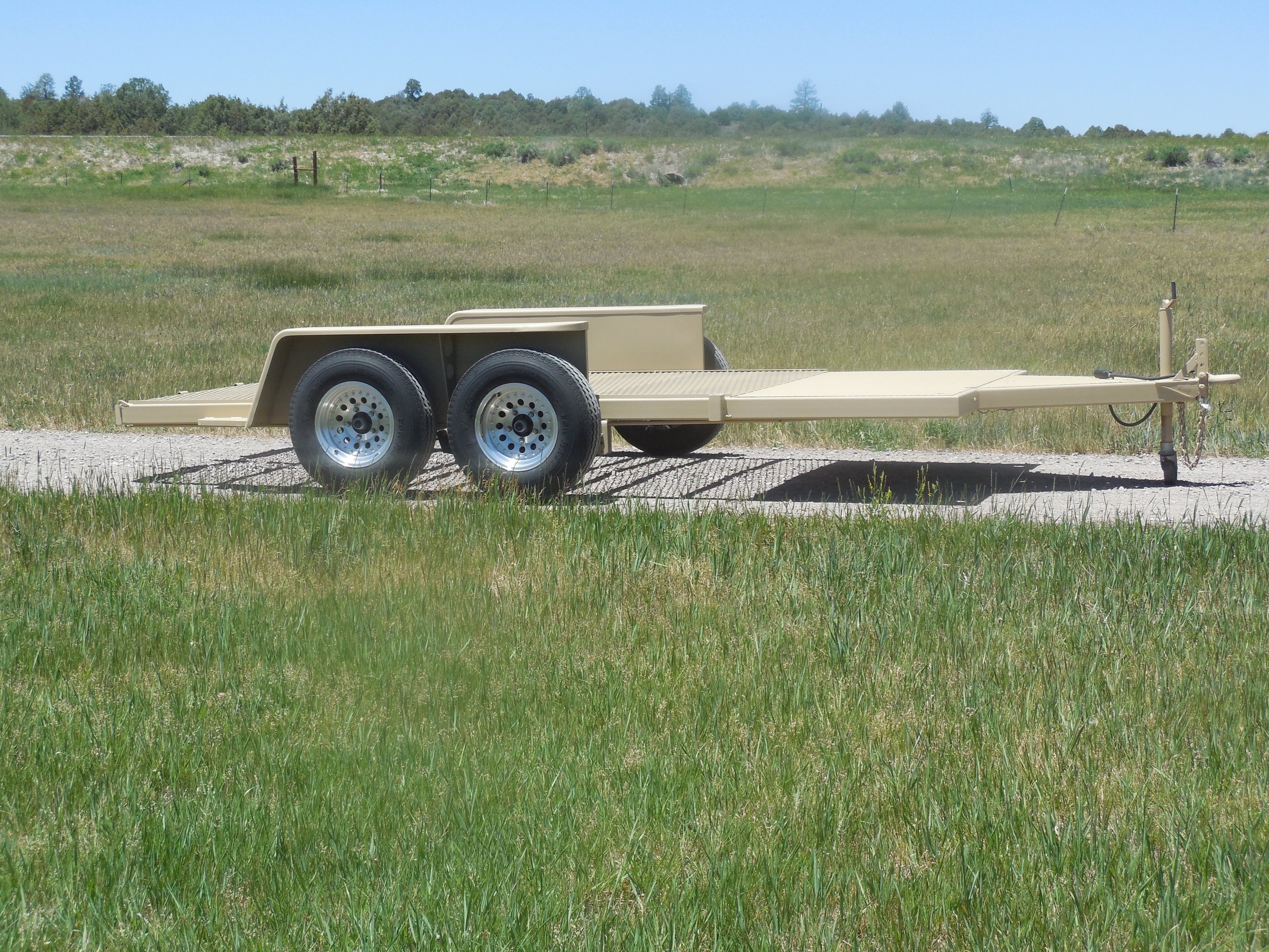

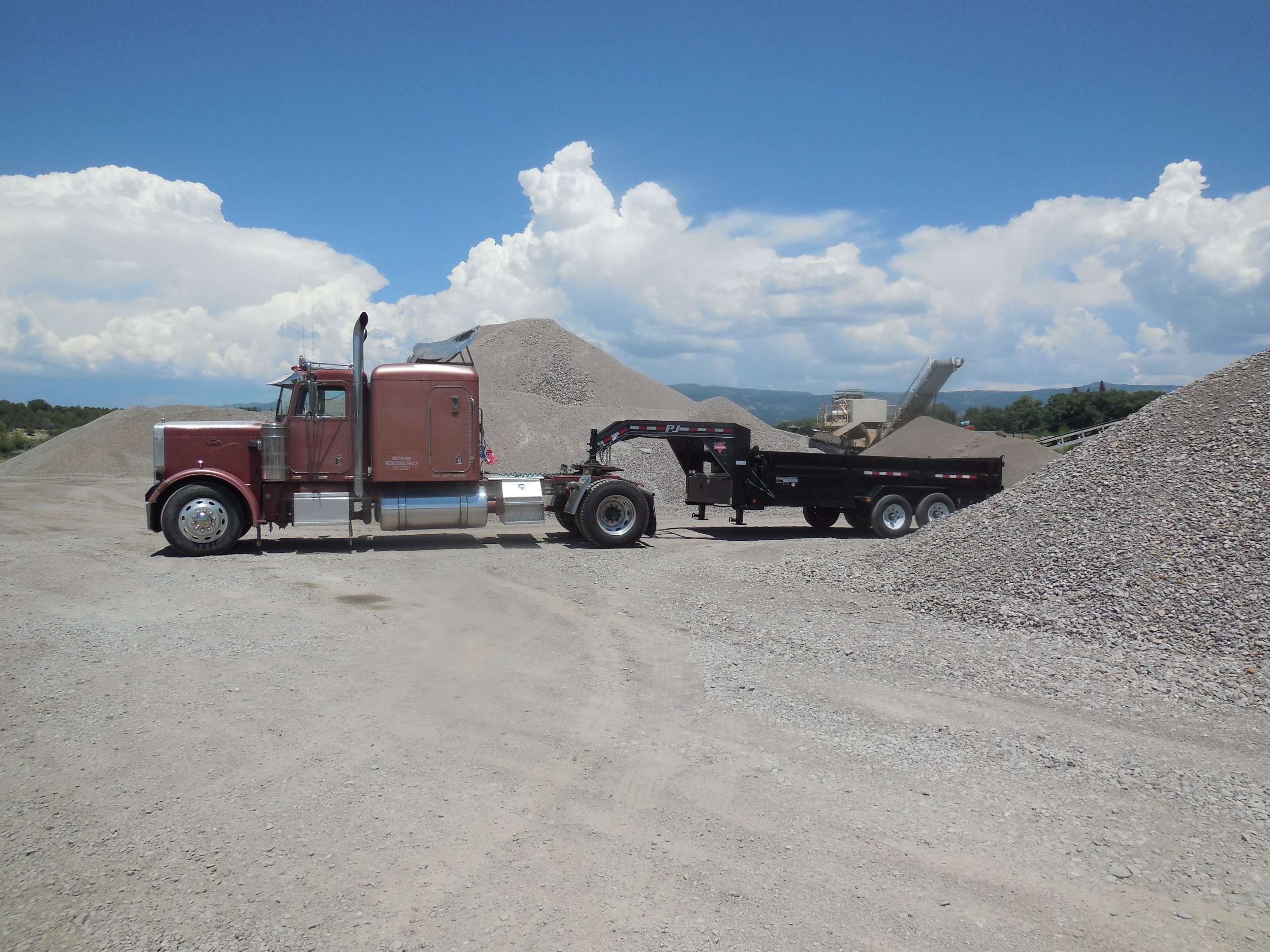

No, that's not quite how it works. A semi trailer puts a portion of its weight, loaded or not, on the tow vehicle. That's the whole reason its named "semi trailer".
A pull trailer supports its own weight, and load, so it doesn't need a jack on the tongue. Okay, con gears (used to convert semi trailers to pull trailers do have jacks since they're heavy).
Below are two examples of typical semi trailers.

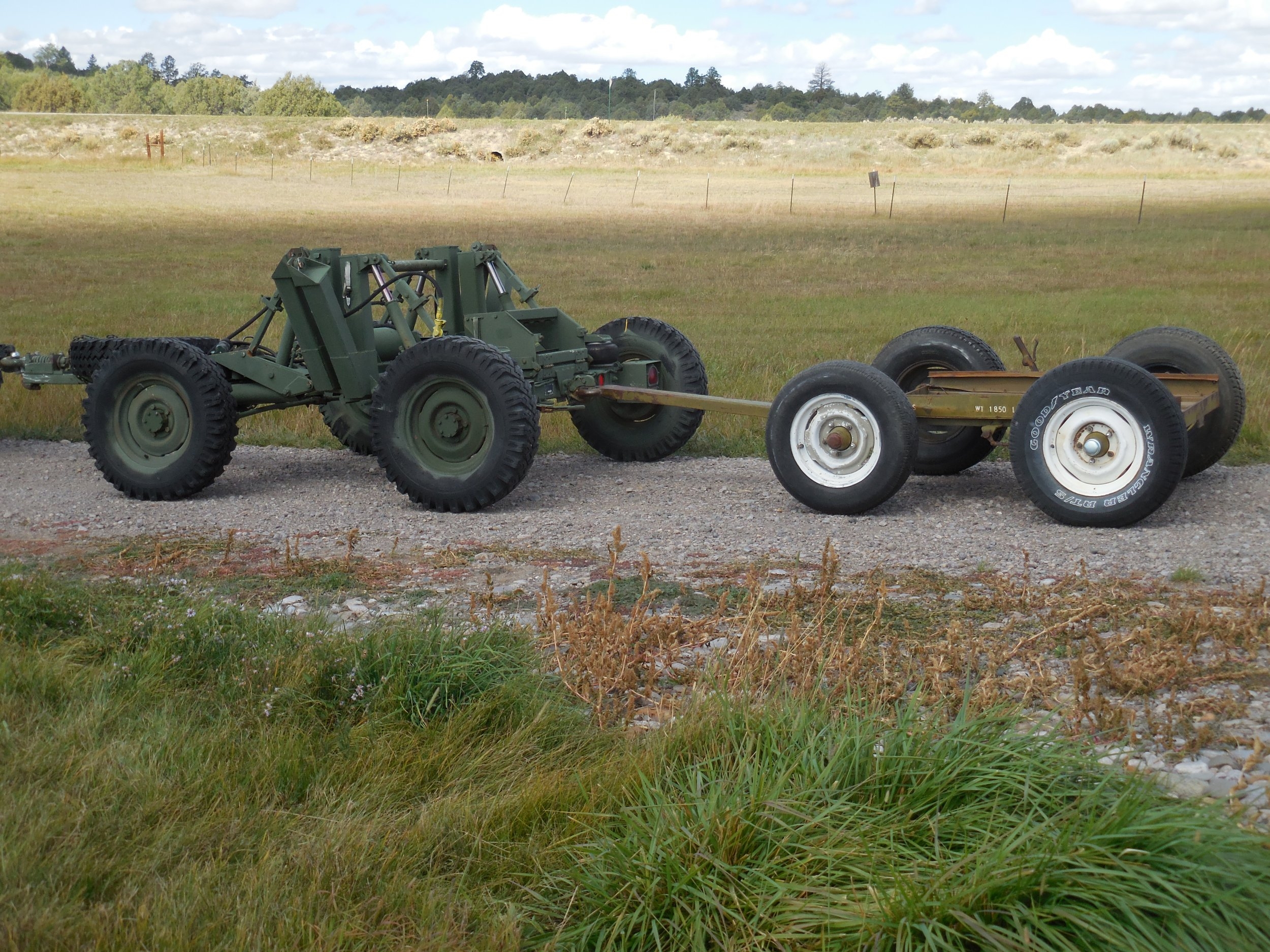

And here is an example of two pull trailers. Unusual ones, but pull trailers nevertheless, with steering front axles.
Come to think of it, the really simple way to tell a semi trailer from a pull trailer is if it has a steerable front axle or not. If it doesn't, it's a semi trailer.
